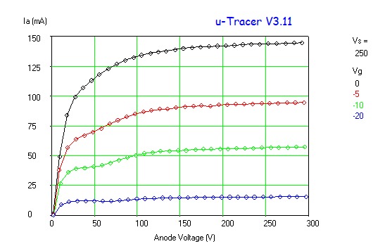

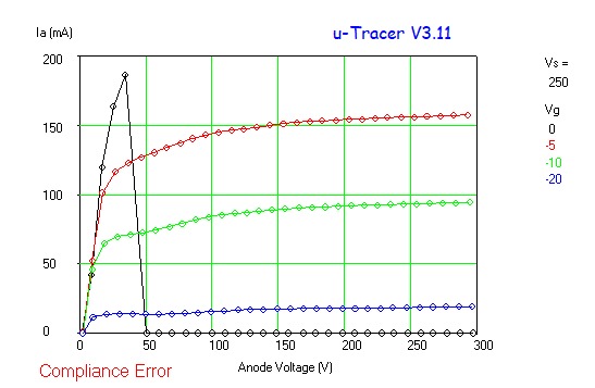

But my question is more general: what happens when one tube in push-pull configuration is 50% below specification value (low transconductance, higher anode resistance). Do we expect this to draw significantly more current from the power supply and blow fuses?
Here are the tracers of the two EL34 tubes

- The good tube! My max current is 200mA so hit compliance with g1=0. This tube is running at about 80% of specification transconductance
- The second tube is the poor tube. Even g1=0 is below 200mA which is really rather low for an EL34. This is operating at around 40% of specification transconductance.

TG that makes sense, because max power is drawn then both are biased correctly and it’s unlikely one tube can draw so much current as to blow the fuse. At least not these tubes because I know the IV curve.
