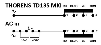

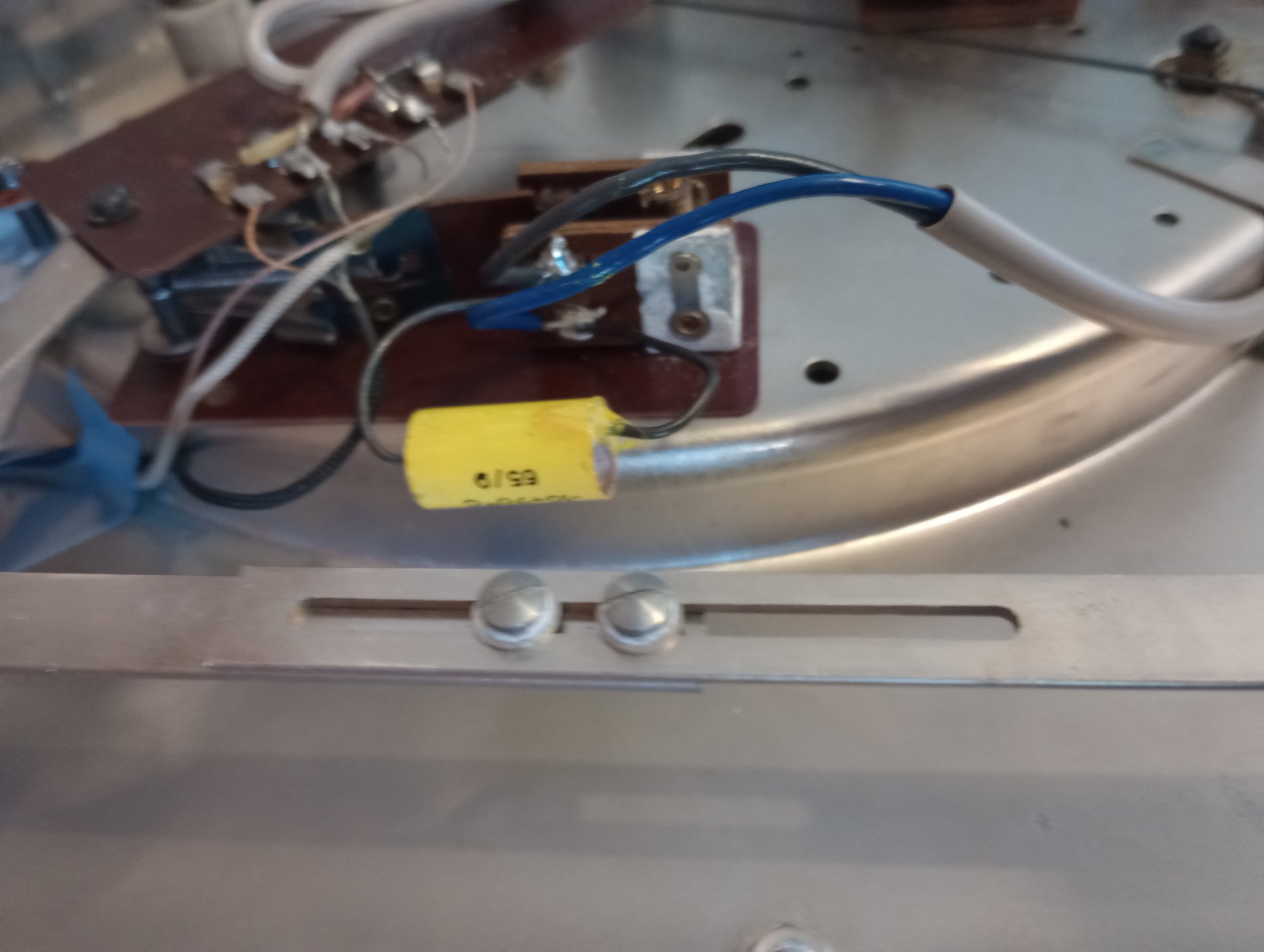

the motor on my turntable won't start just wondering if it could be this .01uf 400v capacitor in the circuitry? What would a failed cap look like? Thanks
Steve
Steve
ps the yellow outer coating circled in blue has become sticky - is it a fail or "glue" used to attach it to something

Have you isolated the cap and checked to see if it is electrically leaky or short circuit?
The stickiness might be just the wrapper/label that has gone gooey.

It looks like the capacitor is connected across the mains voltage. In that case it can only cause the issue if there is a fuse somewhere earlier in the circuit that has blown because of it.

The date code on that capacitor is 65/9 or September 1965. And when the switch is off, that capacitor is essentially across the mains. It would not be unusual for a plastic film capacitor of that vintage to fail when connected permanently across the mains.
It should be replaced by either an X2 safety capacitor (which means that it is intended to be connected across live and neutral) or a snubber, which is what is usually used. That is a capacitor and resistor in series in the same component. For example https://uk.farnell.com/roxburgh/re12001/cap-0-01-f-275vac-20/dp/2336106?st=snubber which is a 0.01uF X2 cap and 120 ohm resistor in series https://www.dem-uk.com/roxburgh/Data/Product_Downloads/roxburgh-re1201-rc-network-pcb-data.pdf

All that cap does is to suppress the noise transient that might get through the audio system when the power switch is operated. Motor does not need that cap.
Indeed - but if that cap has gone open circuit, there will not only be a pop, it could well burn out the switch contacts.
Exactly that happened on my old Quad 33 preamp (part of our kitchen sound system). There is a snubber across the mains switch contacts, and that had failed. That caused the switch contacts to completely burn out. I repaired it by buying a new old single gang pot from eBay with the same switch, taking the switch off and swapping the burnt out one with the new one. And replacing the snubber. Problem solved.
Not surprising. Like the OP's deck, when switched off the capacitor or snubber is connected straight across the mains, very possibly 365/24/7 minus a small amount of time the switch is closed and the equipment operating and being listened to. Which is why it absolutely has to be an X2 rated safety capacitor, or a snubber that includes an X2 safety capacitor.

Well, the snubber is a half step anyway. The most effective solution is to place an MOV across the transformer primary (directly). This conducts any voltage kickbacks from the transformer (that's what kills the contacts), and provides lightning/over-voltage protection. Your fuse opens when this part fails.
The thing is, your transformer in the Quad is much larger than the Thorens. The voltage kickback in the Thorens isn't that big. So unless the grounding is not correct, the most you should get from that capacitor open is a "click" There may be two faults here ...
