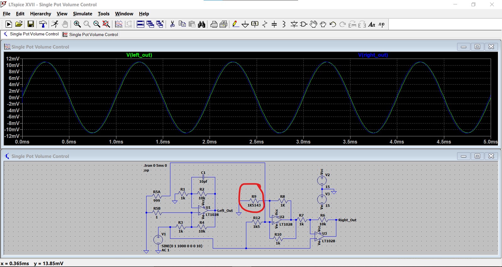

Relying on pot characteristics staying the same is a disaster waiting to happen. It reminds of a circuit I have (from Wireless World and using 3 single opamps) that allows a stereo (two channel) volume control to be made using a single gang pot. One resistor (R9) needs trimming to within 1 ohm and it also relies on the pots wiper having a zero ohm contact with the resistive track. The pot is R5A and R5B
Brilliant idea but flawed.
