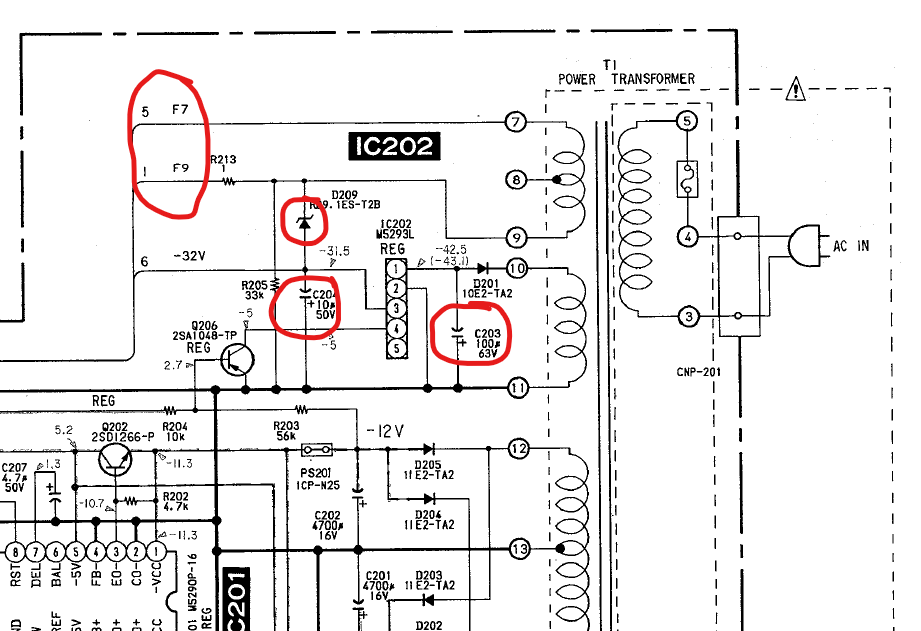

VFD's often suffer with power supply issues due to the way the negative rail and 'floating' filament supplies are derived. Typically the cause is failure (deterioration) of the electrolytic caps in that area of the supply. That would be the first thing to check before condemning the display itself.

This is from a Sony but is typical and all VFD's use a similar arrangement although this one also has a transistor regulator. The electrolytic caps are common failures, the filament supply (top left) is floated to the negative rail via a Zener and the Zener voltage can be tweaked to give a higher differential between filament and negative rail. Nothing else ever seems to fail, its always caps.
