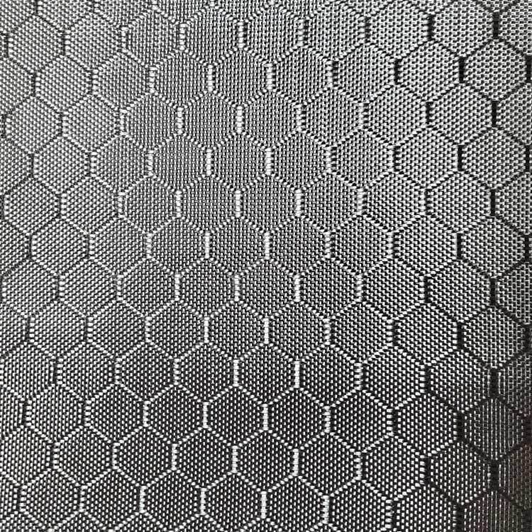

You may want to consider a fiberglass layup. Glass mat isn't the sexy composite but its relatively inexpensive and while it would still hold a lot of resin, it would be stronger than solid cast resin. Chopped CF is worth looking into. It produces a nice looking finish when added to epoxy... maybe a bonus? The main point is that added glass or CF will reduce the weight, increase the strength and shouldn't cost much if anything over straight epoxy. A vacuum pump works well for degassing and if you did want to add an outer CF skin, it would be the tool of choice. Good luck, I'm looking forward to seeing how it turns out.
Amory Lovins with the Rocky Mountain Institute was experimenting with CF/epoxy casting years ago and if I remember correctly, one of his test pieces was bowl shaped and it rung like a bell when struck. I mention that because I found it interesting, but has no bearing on your project. I believe he was using very high pressure in the process.

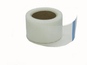

should say grill cloth and fiberglass resin (polyester).In my car audio days (late 80's) we used grill cloth and fiberglass to fabricate complex shapes for enclosures and door panels, worked well. Way easier to work with than fiberglass cloth.
