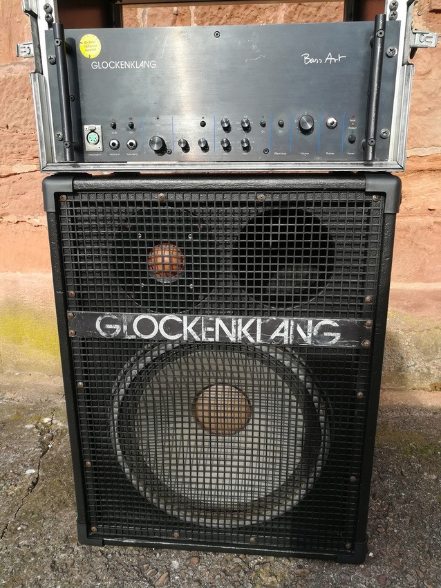

In general, high efficiency fabric dome tweeter without horn are hard to find.
But today I have read in the German magazine "Hobby Hifi" about a new device from the Italian brand "Ciare", type: "MT 320" (MT320)
http://www.lautsprechershop.de/pdf/ciare/ciare_mt320.pdf
(Italian language)
Are there any audible experience ?
An older phenol dome tweeter in this kind is that one from "Bass Art Box MkII" from the German brand "Glockenklang" (go to the last images from attachment) and "Acoustic Art MK-III" - go to
https://www.glockenklang.de/de/produkte/bass_systeme/acoustik_art_mk3.htm
Unfortunately, this tweeter was just a spare part and not as an industry standard available, and therefore there are some diy projects to create such a high efficiency tweeter, e. g.
http://www.6moons.com/audioreviews/bastanis/vc.JPG from
Bastanis DIY Forum

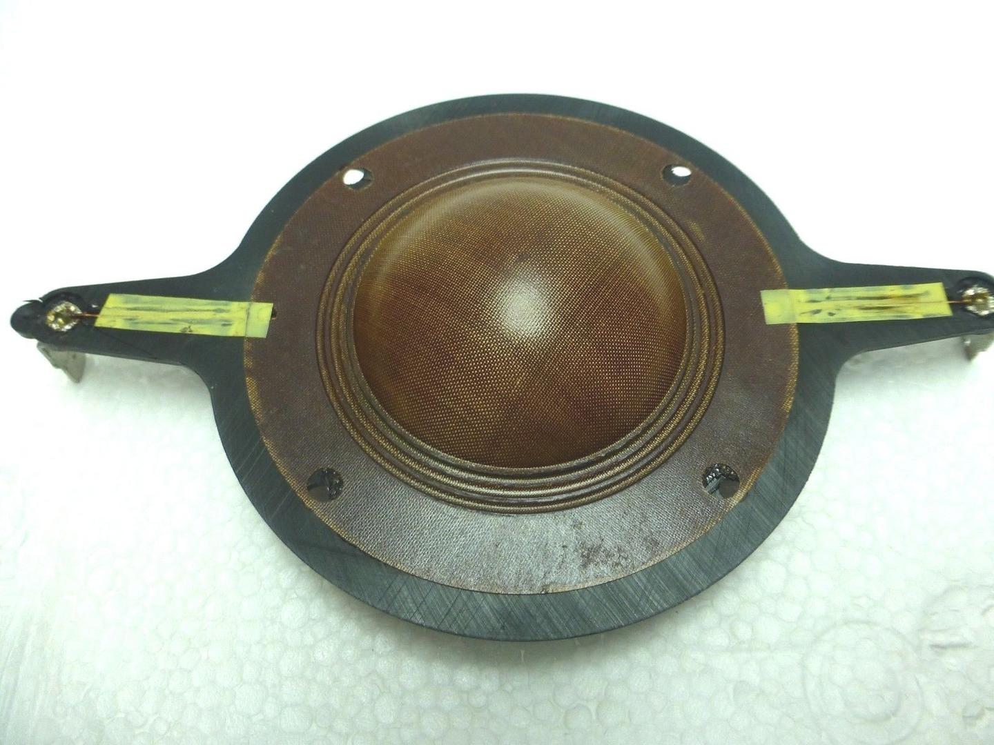

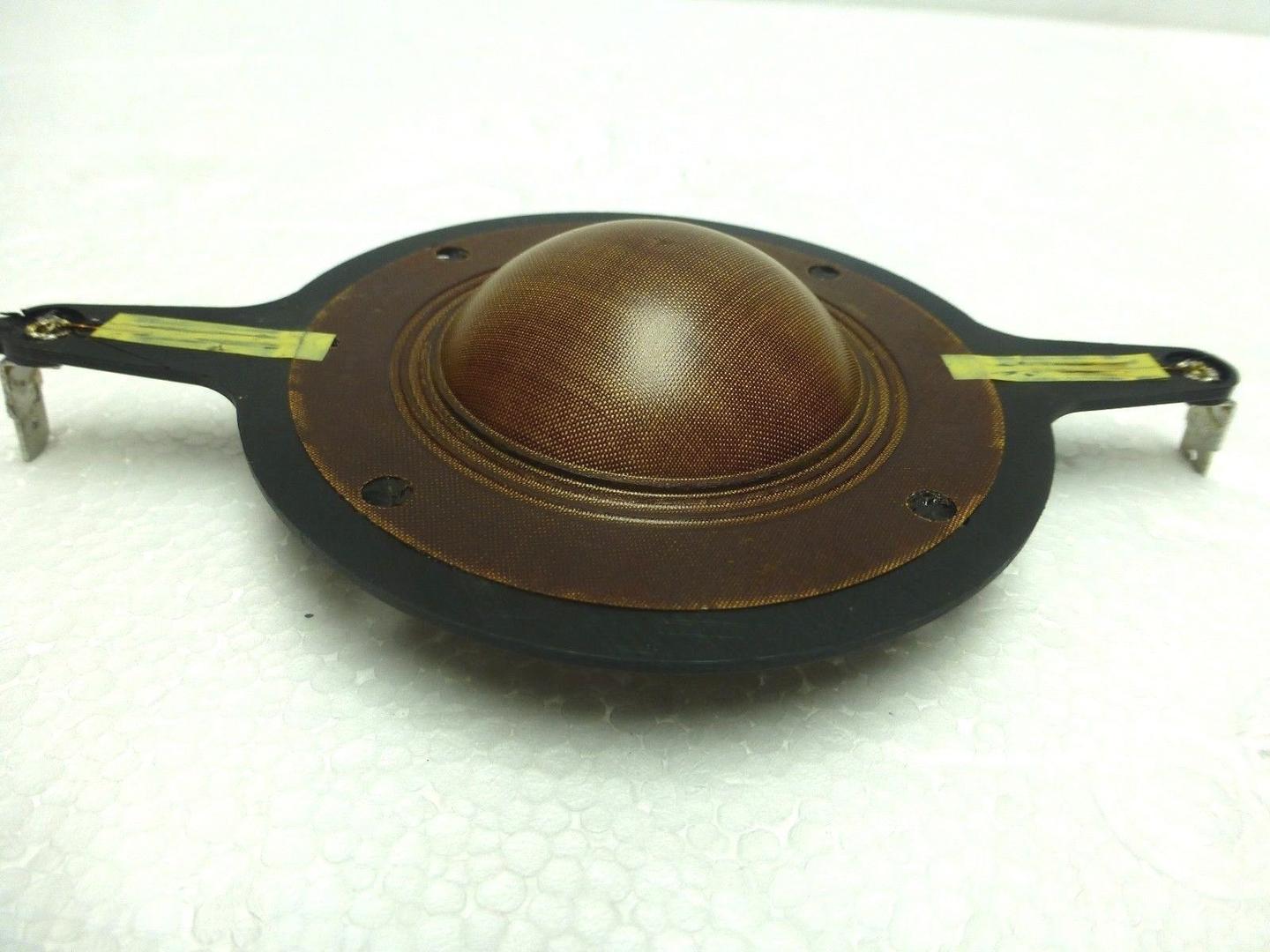

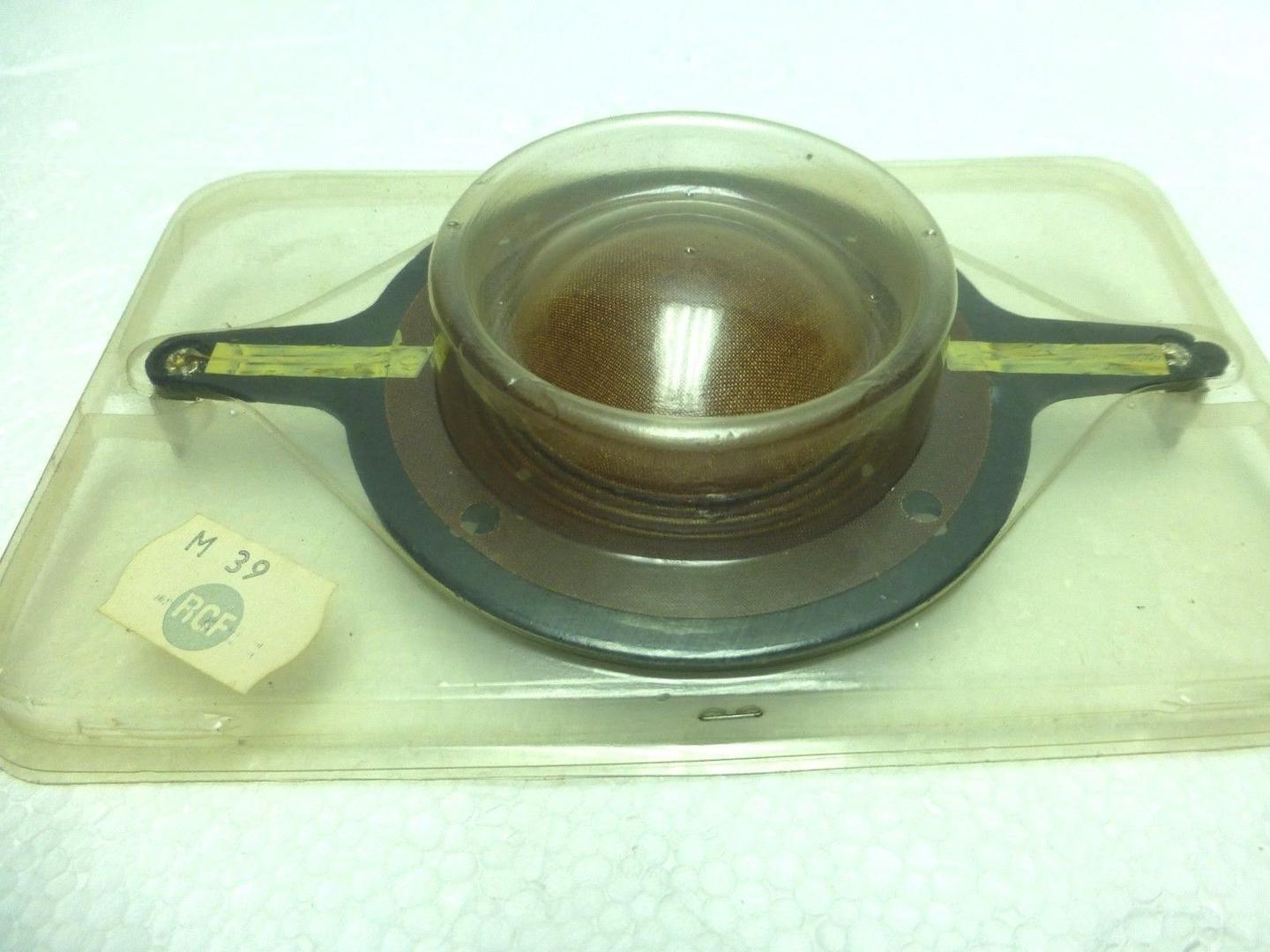

This Glockenklang dome tweeter is based to the no longer available RCF driver magnet TW116 ("TW 116")
and the cone from the appropriate recone kit
https://www.worthpoint.com/worthopedia/original-rcf-m39-rcf-tw-116-tweeter-1834169072
If there are a appropriate successor for the RCF TW-116 magnet, I can order this and the TW-116 recone kit for clone the Glockenklang tweeter, that have 99 db spl/2,83V/m efficiency.
Who knows more about such a RCF TW-116 successor ?

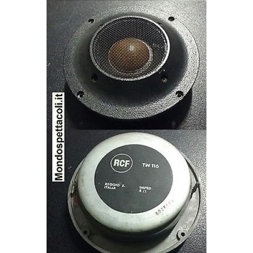

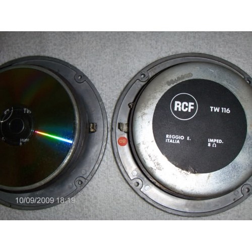

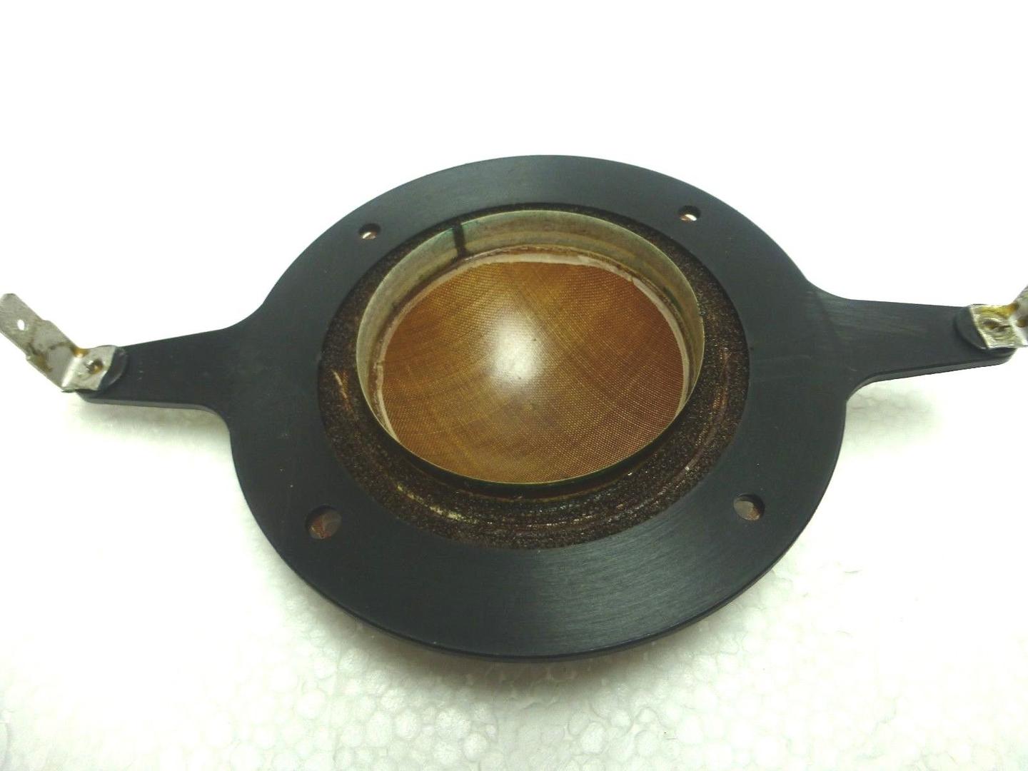

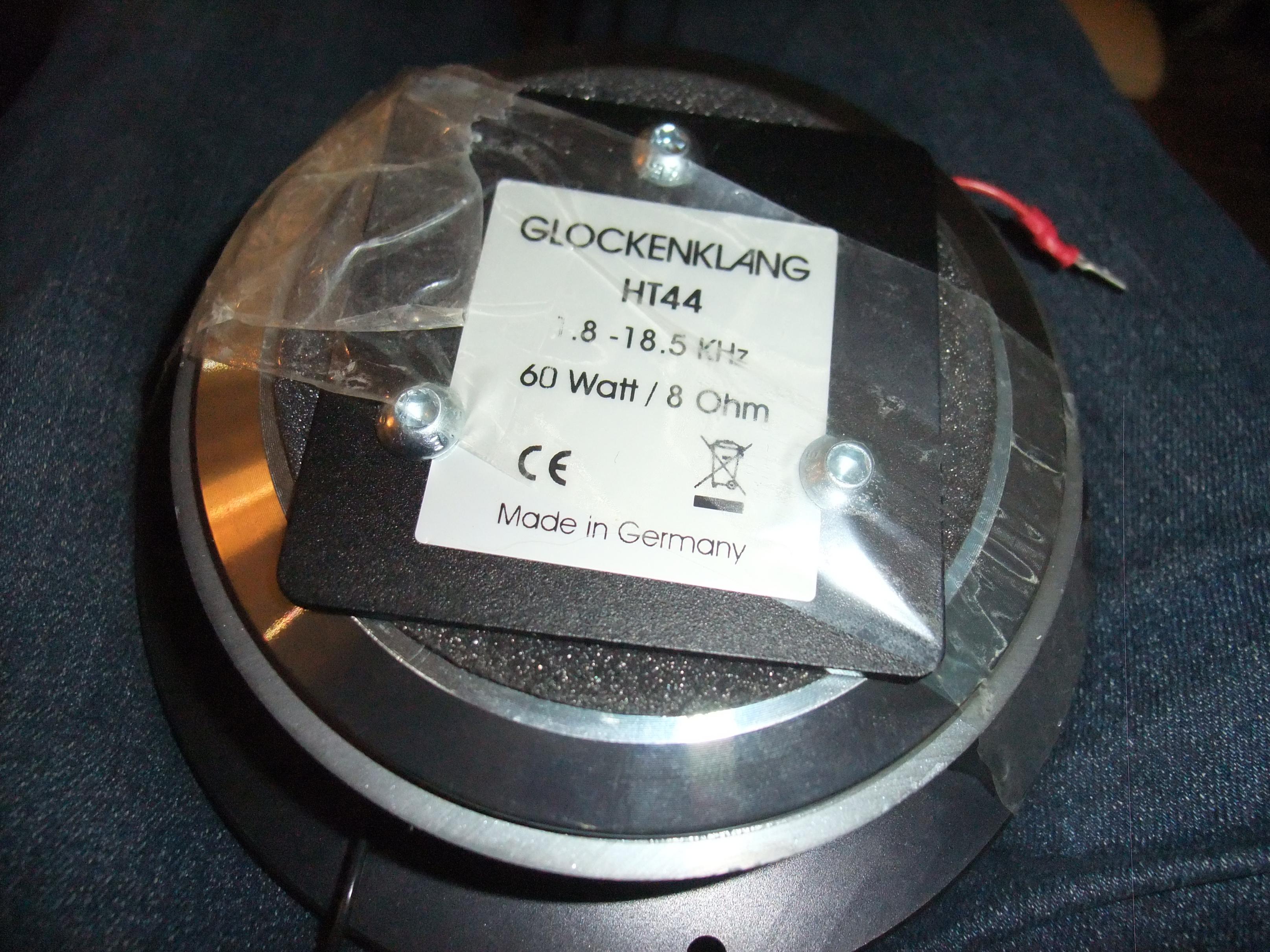

New dome from Glockenklang available:
Pinnwand-Fotos | Facebook
News - GLOCKENKLANG
In the attachment both versions (old and new).

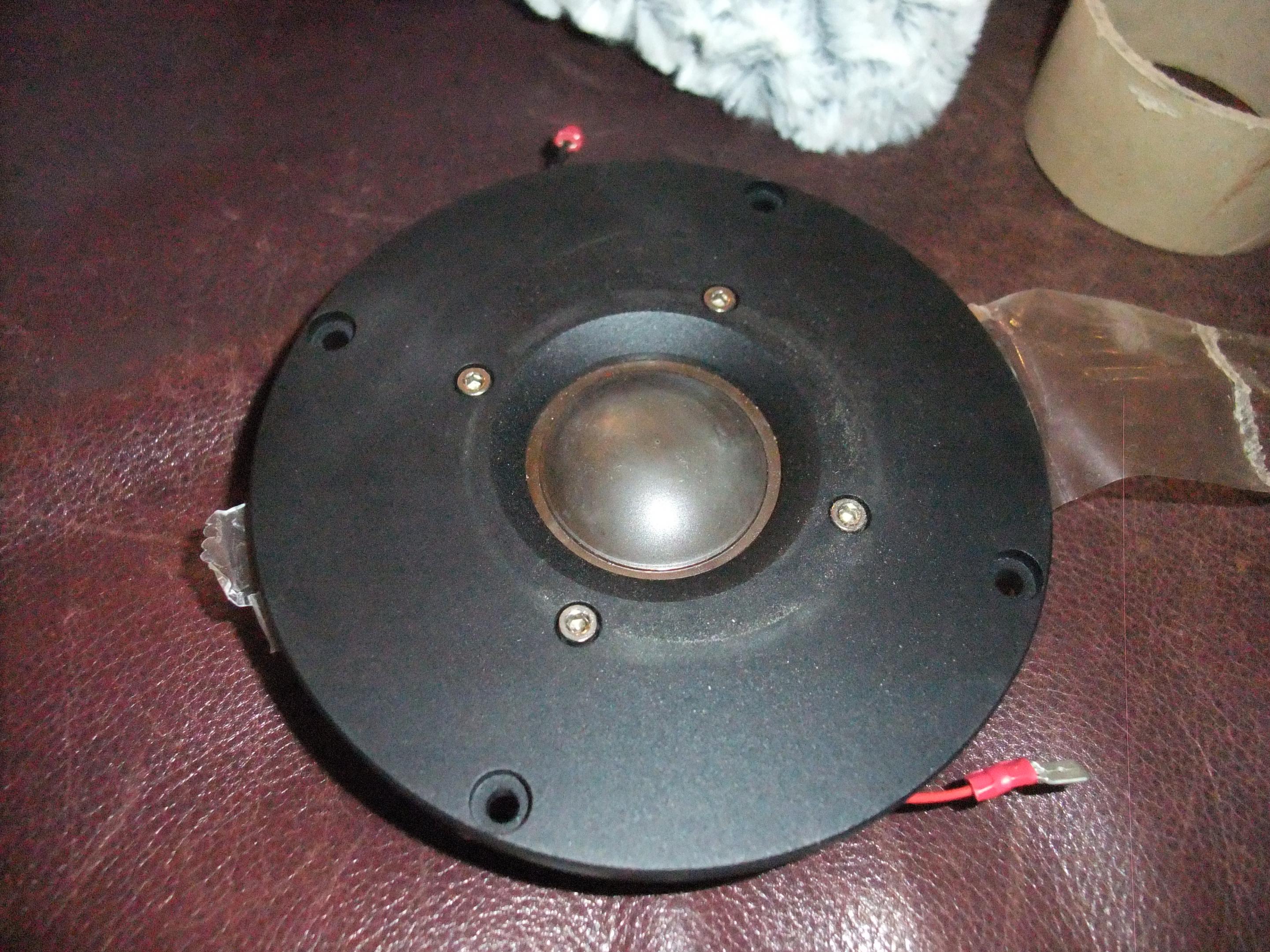

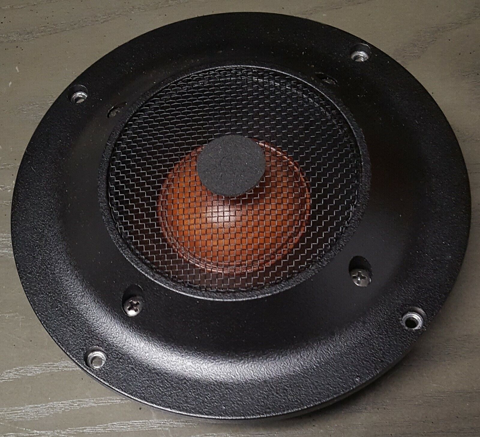

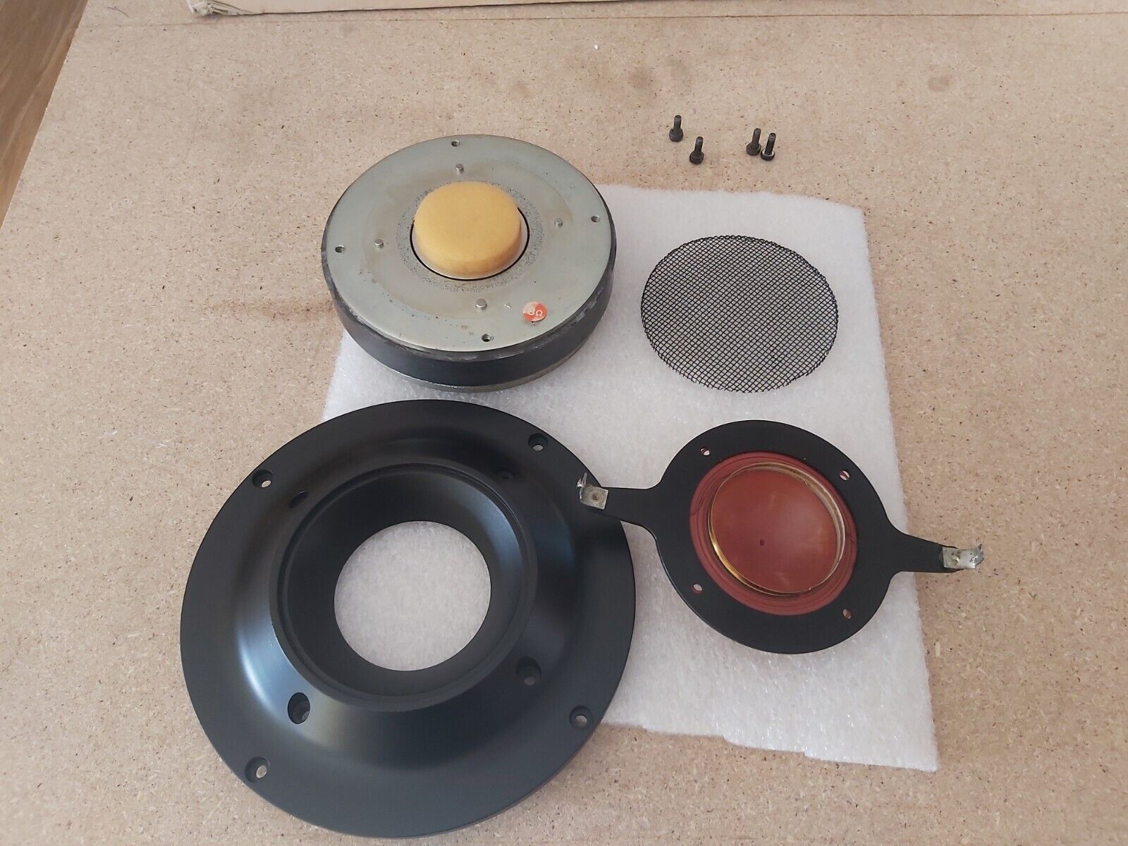

No, unfortunately. I phoned Glockenklang this morning and get the information, that recone kits from the old driver are stil available, but only few devices. In general the new transducer comes in for replace. The manufacturer of the driver is a good known company, but it is confidential according the informations from Glockenklang. The currently used dome tweeter is separately available as spare part by Glockenklang for 200 €/pc excl. VAT and shipping costs. This model will be available for a long time according the informations from there;
here a pic of the currently used dome tweeter:
http://images.thomann.de/pics/prod/108308.jpg
Basically the kind of realize is in the same kind as to see at the first image from
http://www.audioasylum.com/cgi/vt.mpl?f=bastanis&m=788
The only difference to the dome from Glockenklang must be the face plate and the direction of the connection terminals of the dome itself.

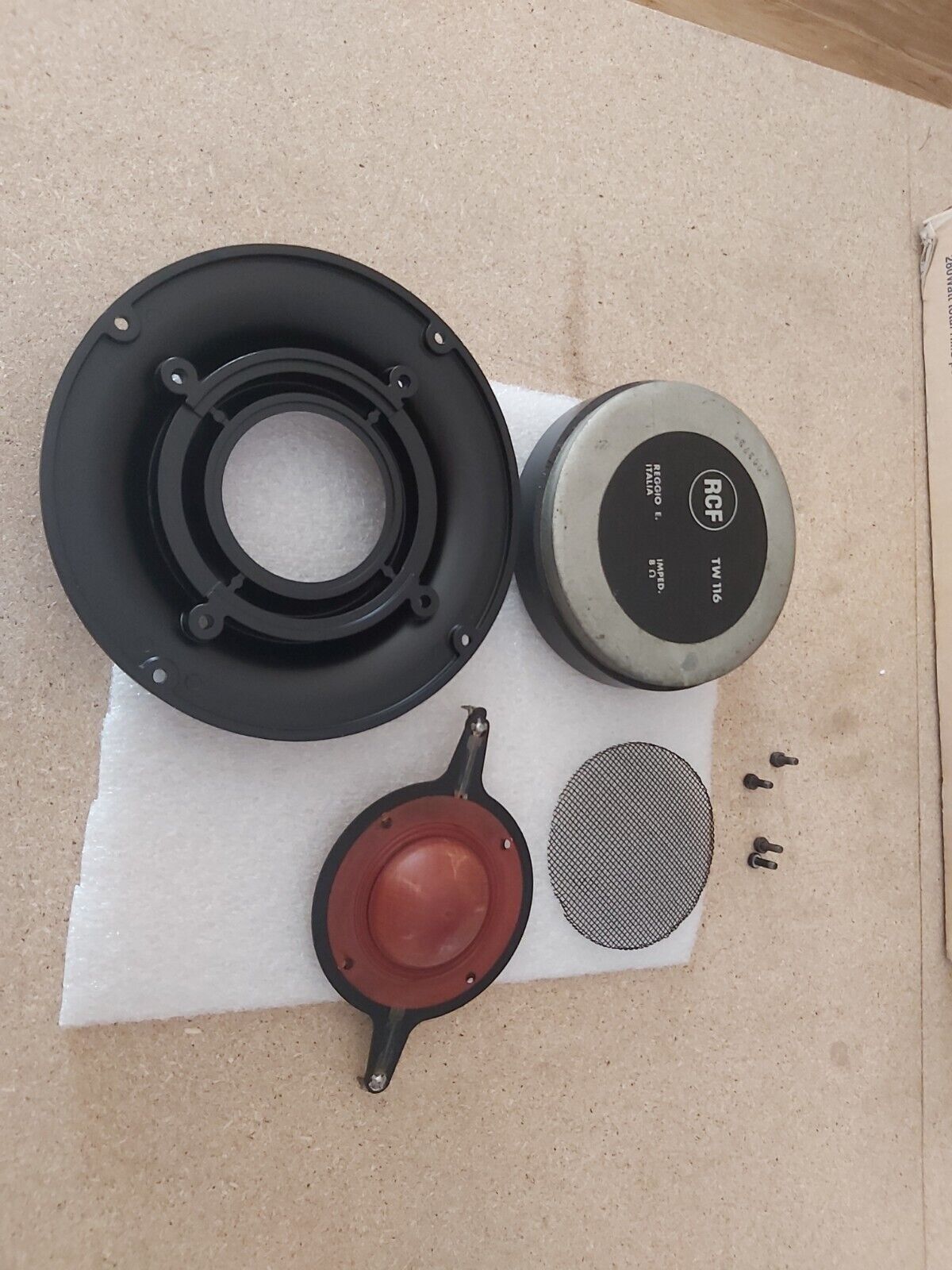

In the attachment the dome tweeter from post #6 (first image) as single unit (ordered for extend a Fostex FE206EN unit to a two way system).New dome from Glockenklang available:
