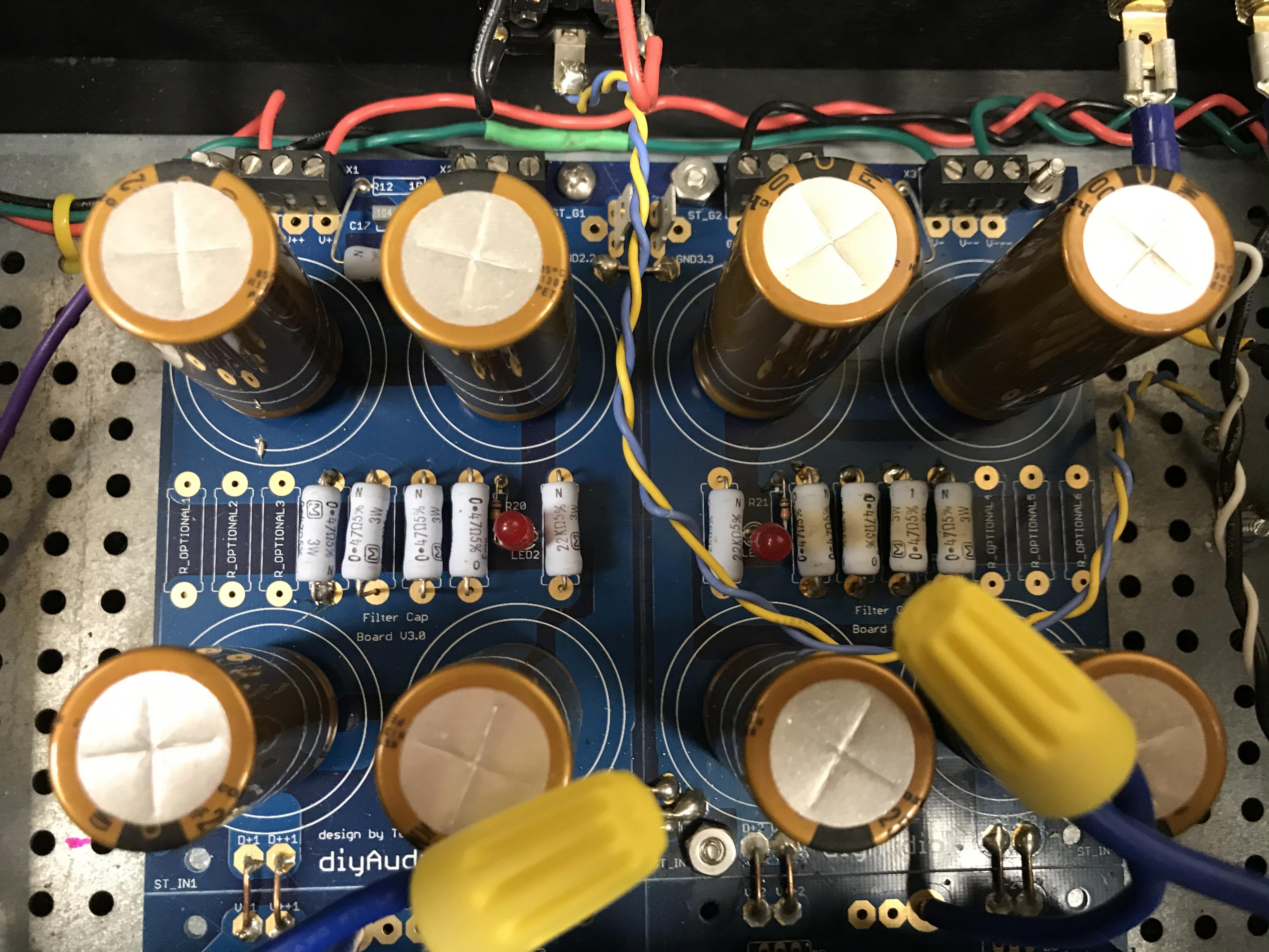

My f6 is a diy build. I had my sp14(another Diy with 6ns7 tube) already running and playing my tube lab SSE turned my pass F6 on and proceeded to hook up the pre already running and saw slight smoke. Thankfully my F6 is still working and running fine off the nodi 2.playing a little Larry carrolton Last night album
It appears to be in my power supply. I hooked my sp14 preamp to the f6 but did not turn it on. Turned on the f6 and both power lights( red led) came on, within seconds the right light dimmed smoke came off the resistors and the light went out. Hooked up nodi2 wcerything works fine.

Did one more experiment by switching the connection (red to white ) the same led started to dim and I pulled the one input connection and left the other in for a second thus bring smoke from the transistor area. Amp still works. Afraid to try other experiments for a while

So it smokes with two of your sources but not with one?
Do the two sources that cause smoke have safety ground (3 prong plugs) and the one that does not smoke only has a two prong plug?
Please post a picture showing all of the amplifier (an overall shot).
Something is causing excess draw on the V- part of the power supply and the excess draw is burning the resistors.

The four 0R47 in parallel will give about 0R12. Let's say they each dissipate their rated power (given the discoloration likely more), that's 4*3W, and with P=12W=U*I=R*I^2, thus I=(12W/0.12R)^.5=10A of current!
Something's not right.
