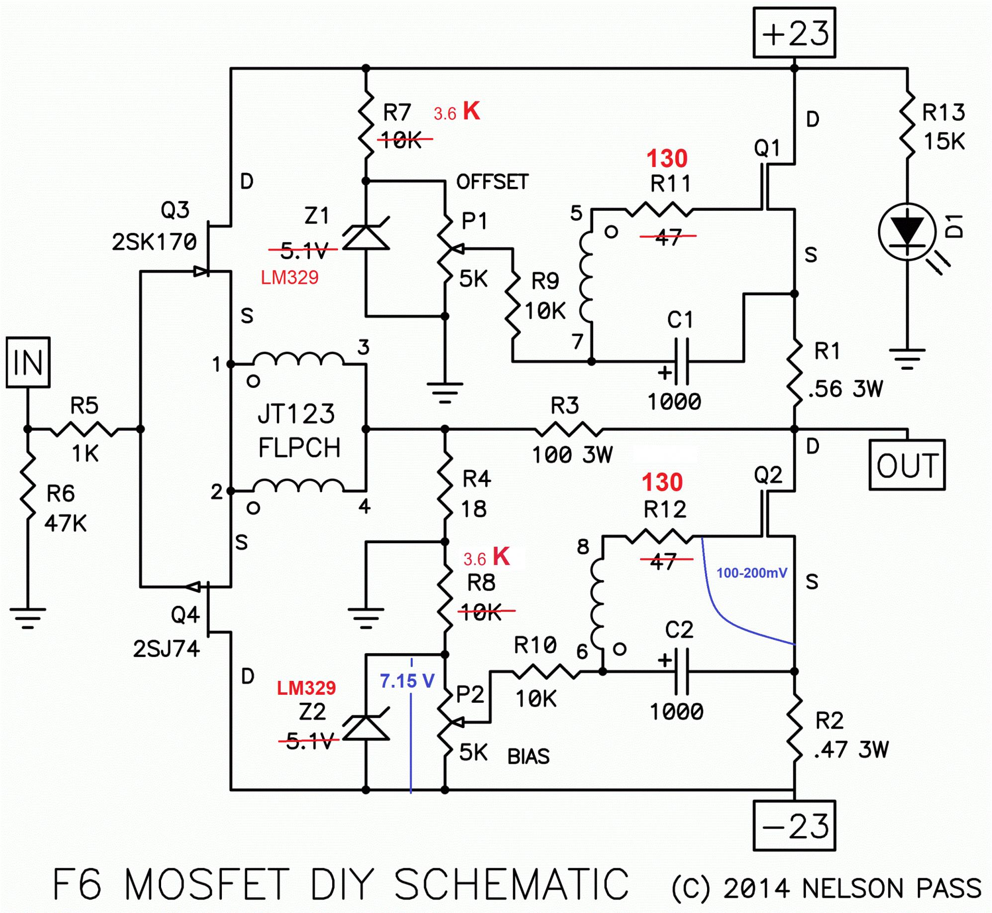

I'm using LM329 voltage references in my F6. They work quite well. My power rails are +/– 26.4V, R7 and R8 are 3.9k Ohms, to make sure there is plenty of current feed the 5k trimmer resistors and the LM329s.
It might be good to make sure that the 329s have been connected with the correct pins and polarity.
remove mosfets , power it up , confirm all voltages
then put new mosfets , taking care of everything already said
be sure that trimpots are in al the way down position , sending 0V to mosfet gates , ref. to adjacent source
if needed , ask for more clarification

measure voltage across R18
then , ref. to GND , measure voltage at any end of R11 , and confirm max and min voltage at R11 which you can set with P1
same logic , ref. to negative rail , measure voltage at any end of R12 , and confirm max and min voltage at R12 which you can set with P2
ref. means - black probe goes there

You said to measure voltage across R18. I believe you mean R4 18 ohm (I used 20 ohms in my F6.)
I measured voltage at the end to mosfet gate for R11 and R12 , when measured I would try to set other POT in middle span.
Right Channel
R11 ref. to GND
Min 6.6 mV (voltage across R11 near zero) and voltage across R4 = -7.0mV
Max 126 mV (voltage across R11 = 92mV) and voltage across R4 = 1.2 mV
R12 ref. to negative rail
Min 66.5 mV (voltage across R12 near zero) and voltage across R4 = -1.9mV
Max 133 mV (voltage across R12=93mV) and voltage across R4 = -3.0mV

yes, measure across R4 (R18 was a typo)
you need to see action , from 0V to what is LM329 giving max (6V6 to 7V2)

about above resulted tell something?

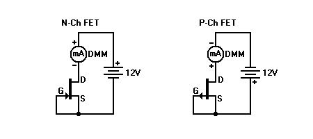

sorry , I made a mistake ( more than once) , thinking all the time about checking JFet current at R4 ...... R4 practically showing just difference between JFets if they're not perfectly matched
must be not enough coffee these days :clown:
you need to check input JFets with simple matching jig , so - yes - desoldering them from circuit
on the other hand , what I wrote about P1 and P2 and associated tests - that's having nothing with R4
measure voltage between R11 and GND , while moving P1 from end to end , and write what you have ; for proper operation of biasing circuit associated with upper mosfet , you need to see voltage span from 0V to +6V6
measure voltage between R12 and negative rail , while moving P2 from end to end , and write what you have ; for proper operation of biasing circuit associated with lower mosfet , you need to see voltage span from 0V to +6V6
It is Okay Zen mod.
As mentioned, the voltage at one end of R11 and R12 were far from 0 to +6V6
,tiny positive and negative.
Because I still cannot find root cause why all Mosfet dead therefore I feel be lost self-confident on what I did. It might be better to restart all with new parts.
