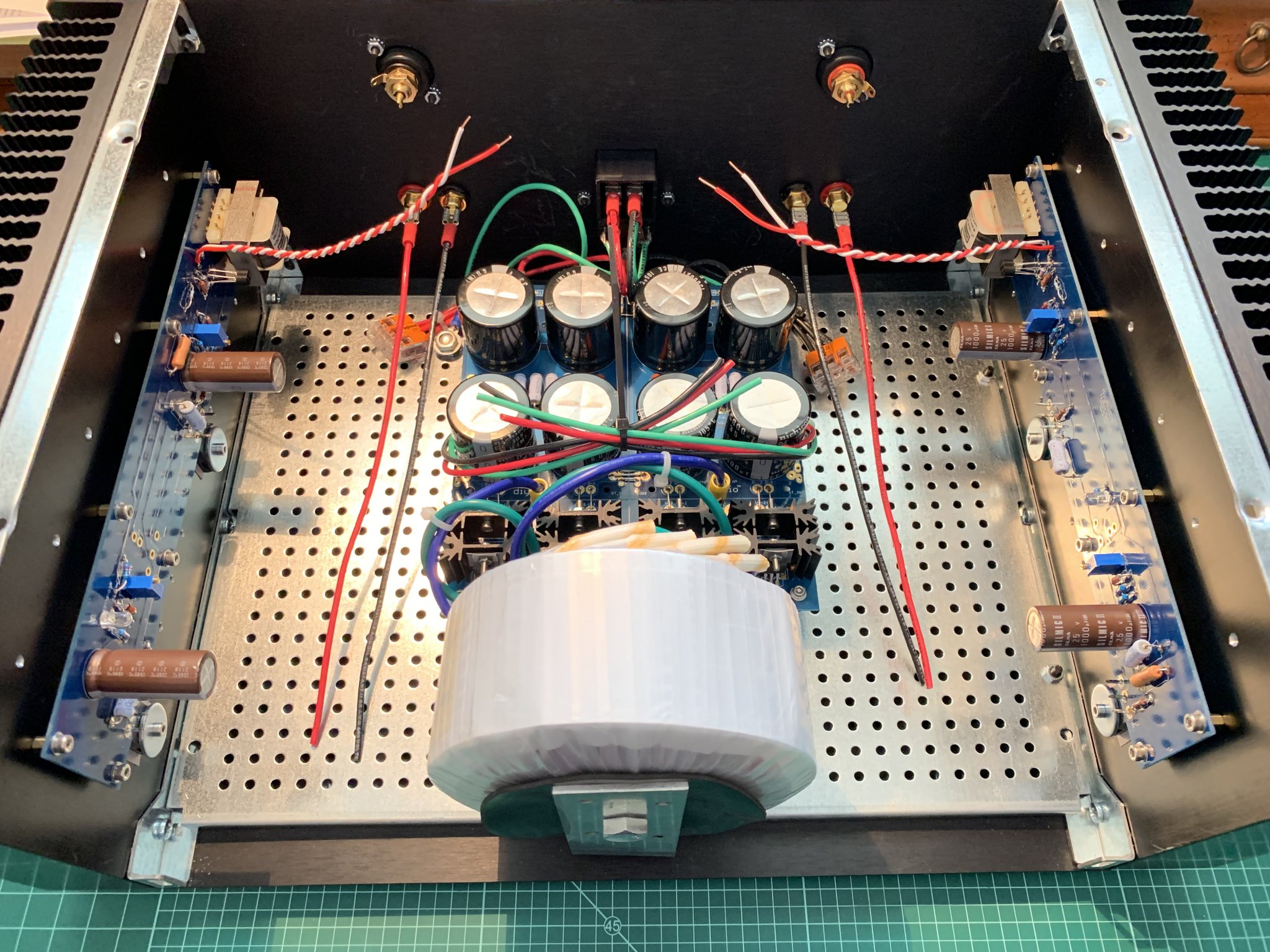

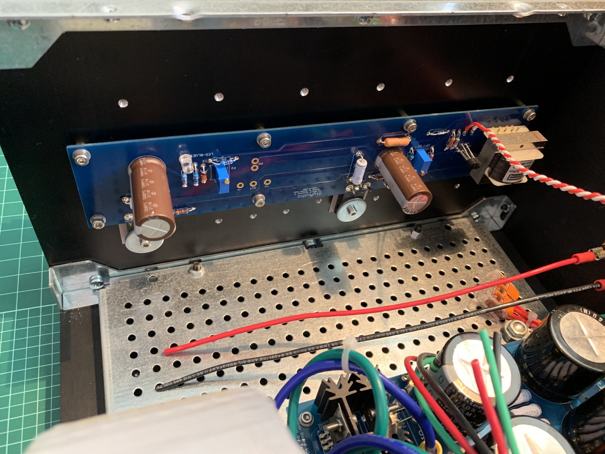

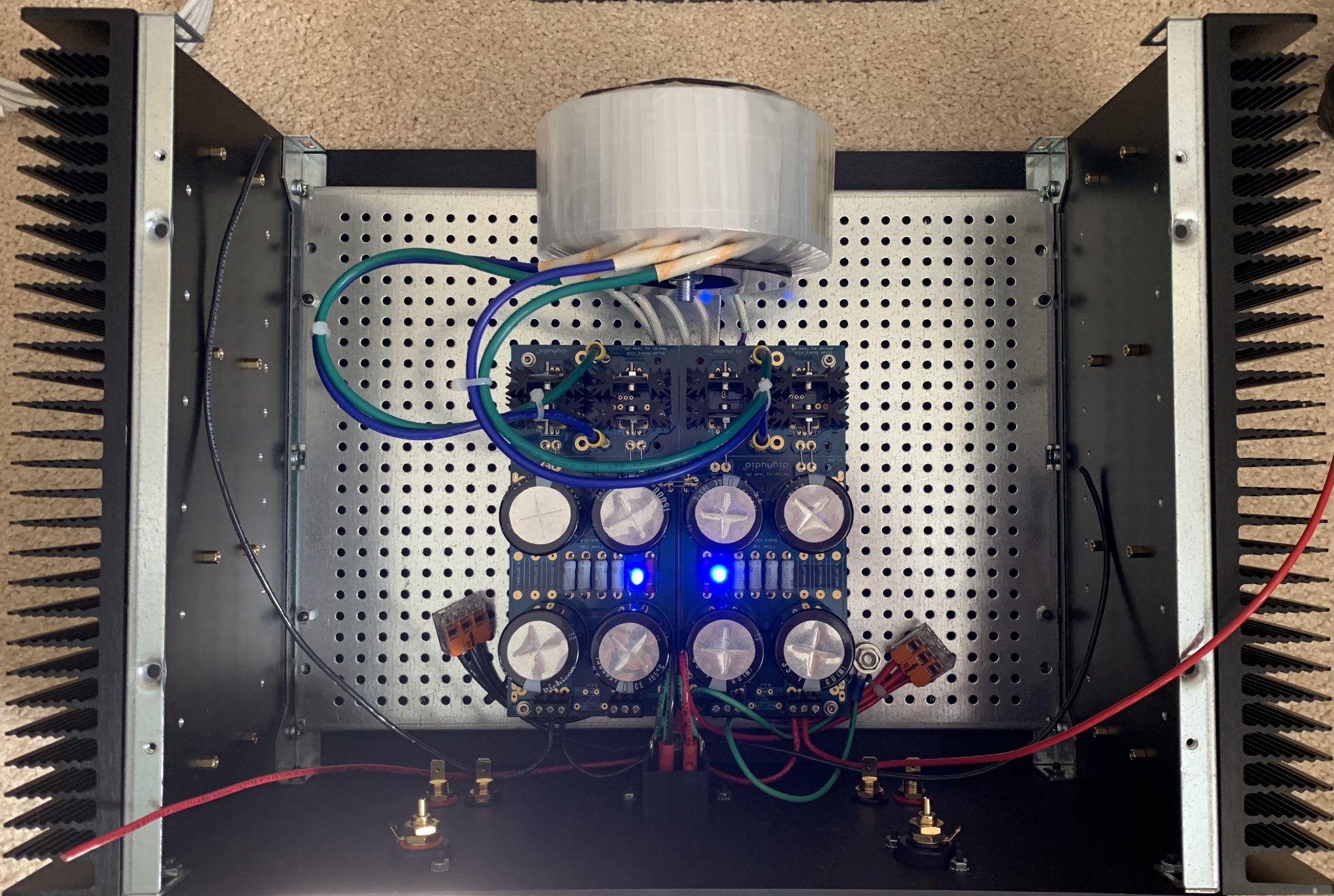

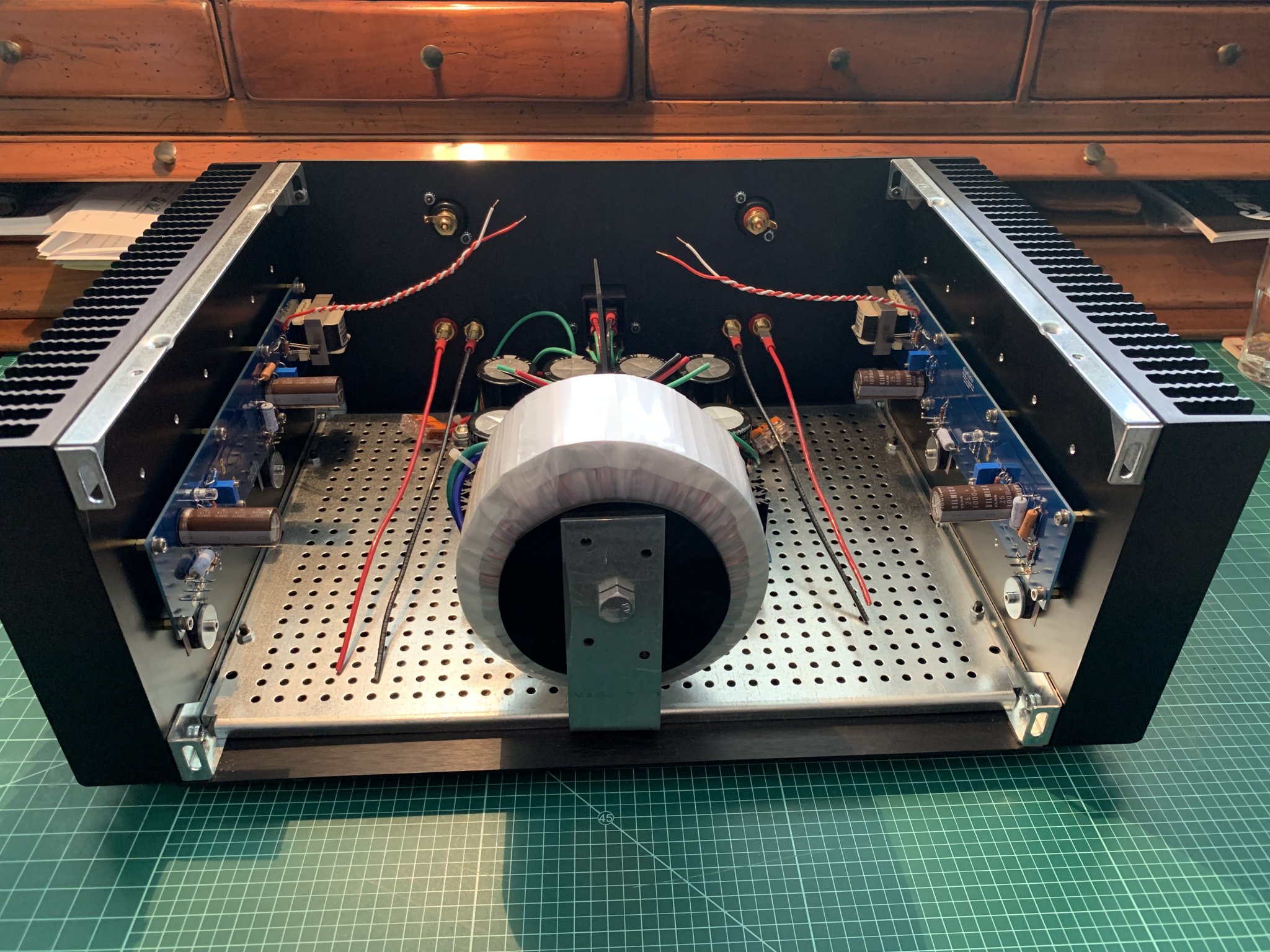

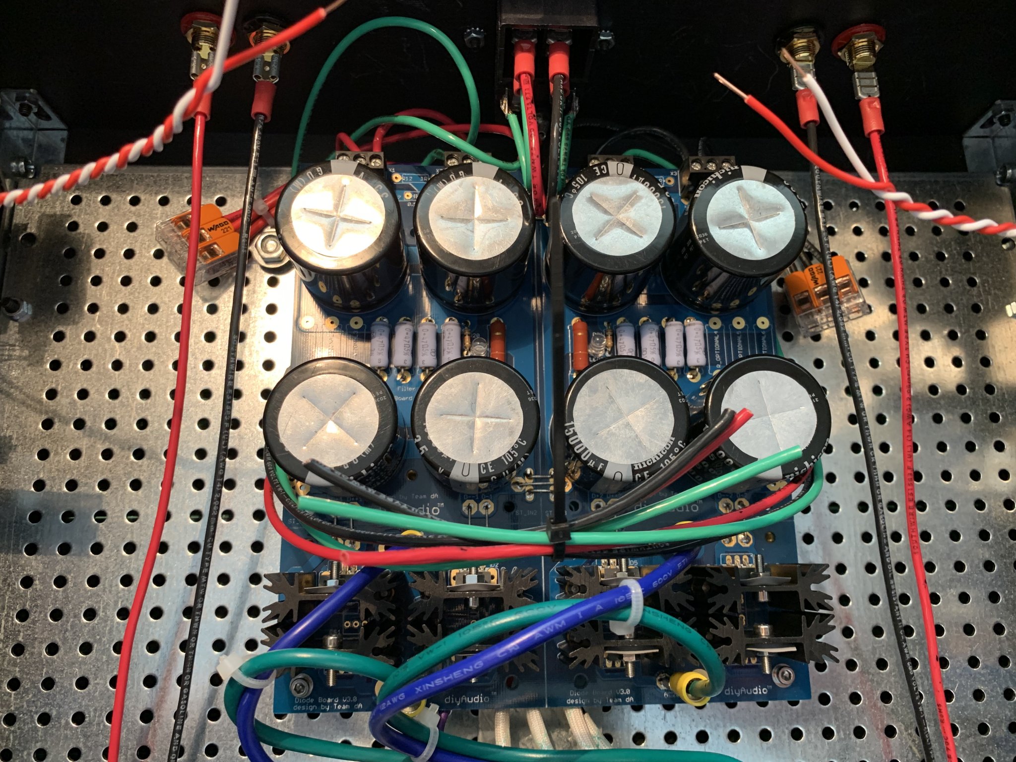

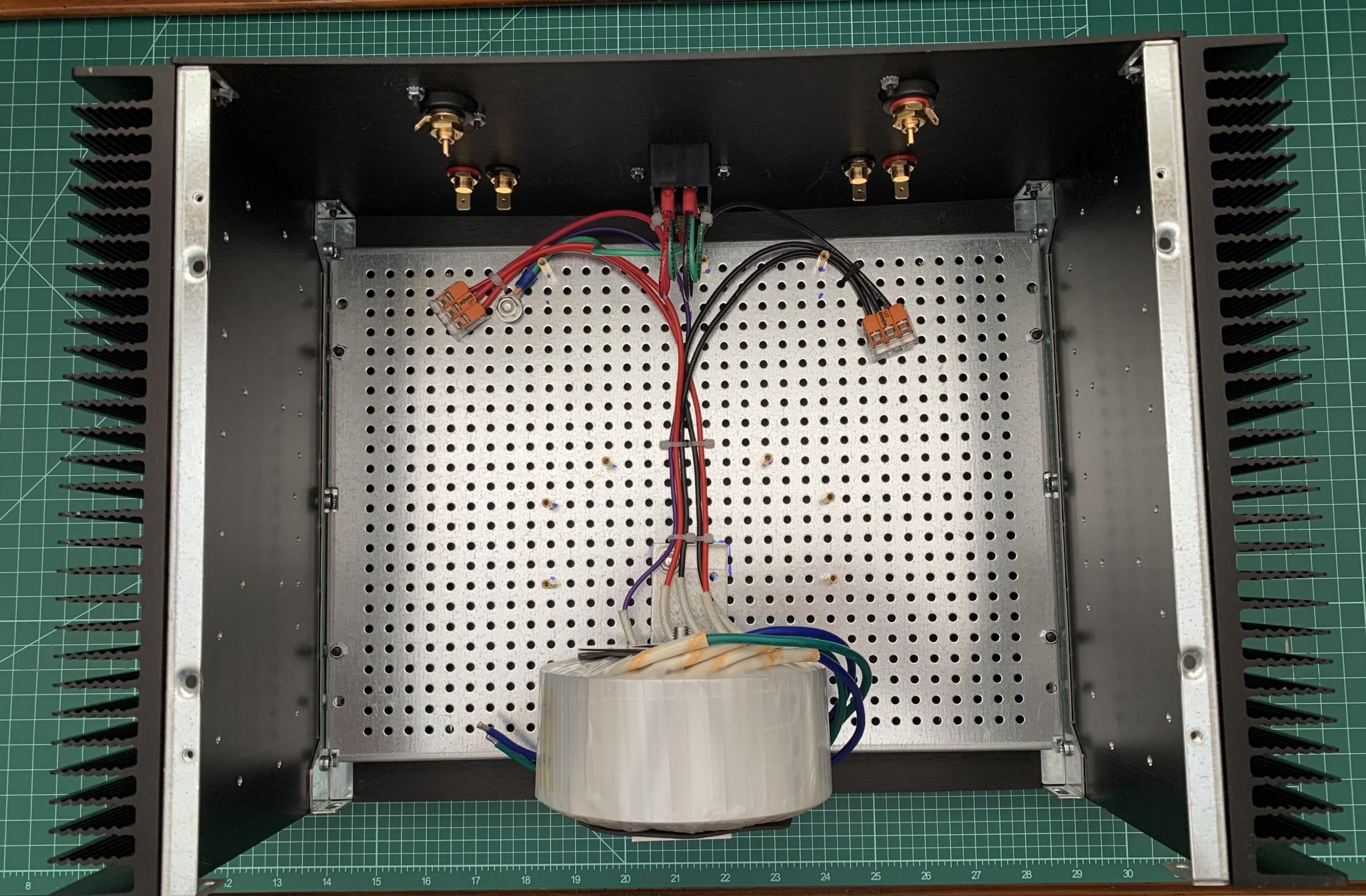

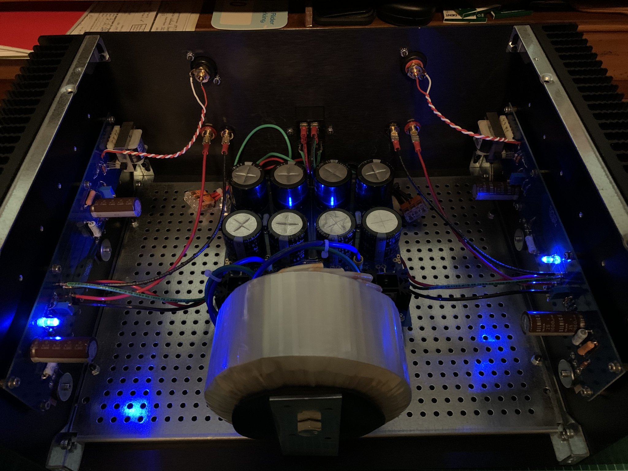

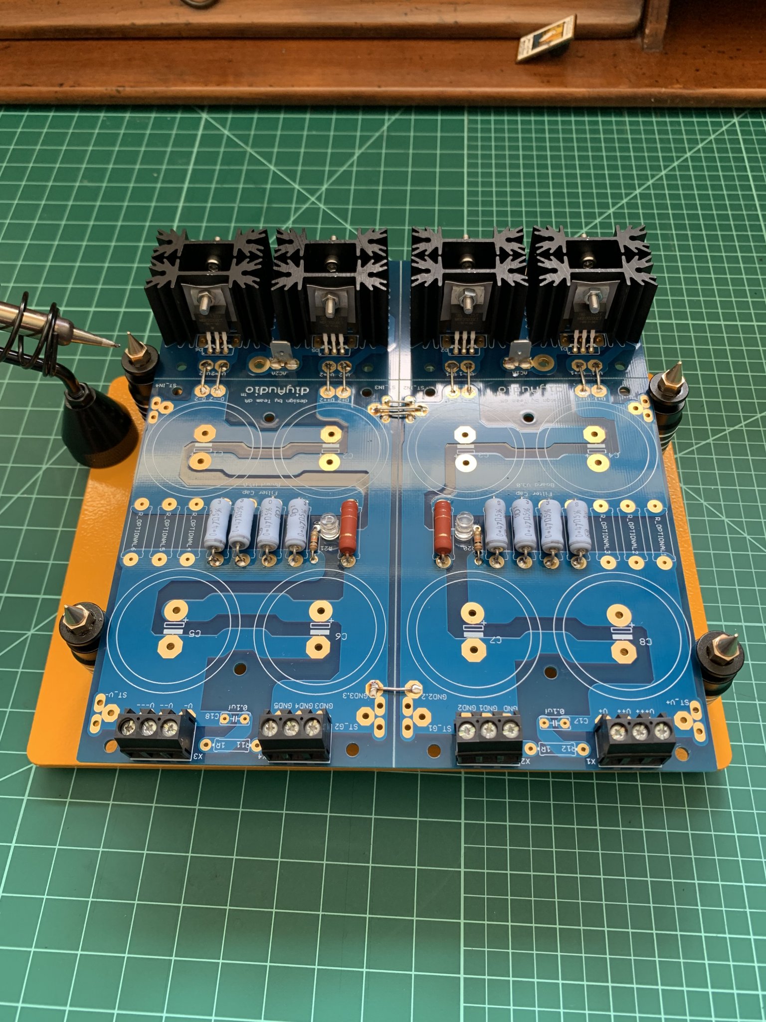

Another F6 is born. Sounds great. Thanks for the build guid and this discussion forum. I could not have completed this project without them.
