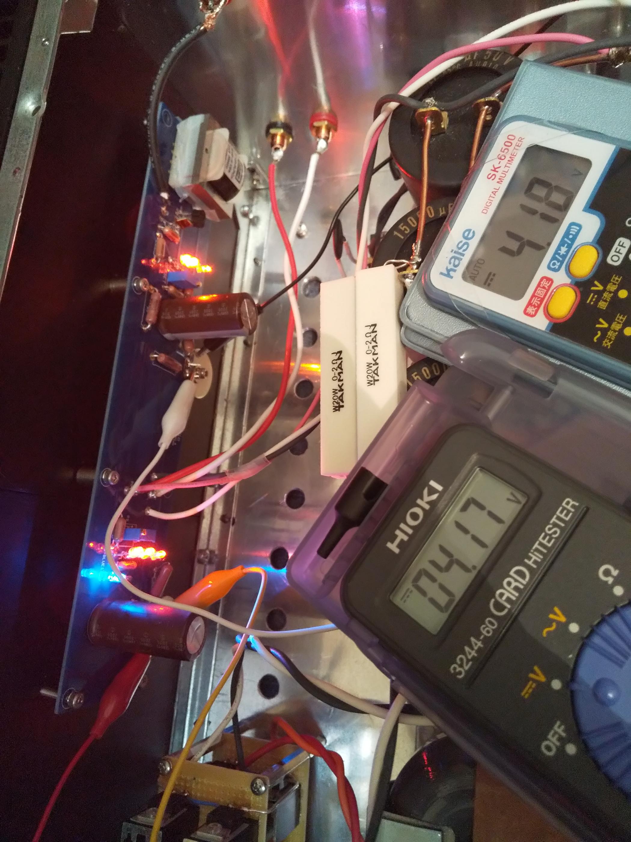

4.2 V is not adequate so you will need to add another led.
I am a little concerned that the LEDs are changing in light intensity. This shouldn't happen. Edit: Maybe you're just experience the slow turn on of the amp, which is normal for the amp.
The current through the LEDs should remain constant.
Please check all solder connections just to be certain there is nothing obviously faulty.

Removed bulb tester then adjust bias setting.
It's 0.5V, 0V between speaker posts.
The magical sound came out only left side.
I had spark around right side transformer before so I suspect transformer failer.
How can I measure to find fail at Jensen transformer?

What are the Voltages Gate to Source on the left channel?
When you say right side is banging, do you mean music is playing or banging in a bad way?
Initially you could just compare measurements between the good and the bad channel to see if anything is significantly different. Try that first
To test the transformer properly it is probably going to be best to remove it from the circuit.
Left speaker sounds great.
Gate-source pins have 4.2v.
It seems maximum.
Now,circuit breaker is sounding ham like zzzzz.
Its shaking, possibly the spark comes from there.
I will change the circuit breaker tomorrow.
It seems maximum.
