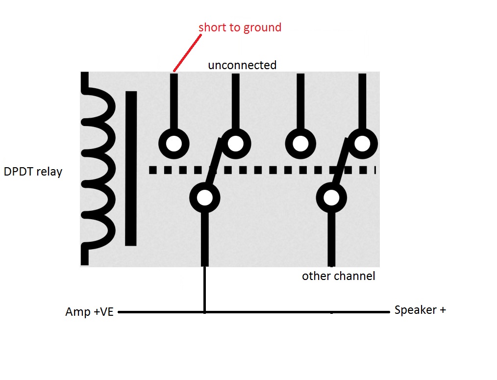

I think you mean one 24V DPDT or DPST relay can handle two channels?

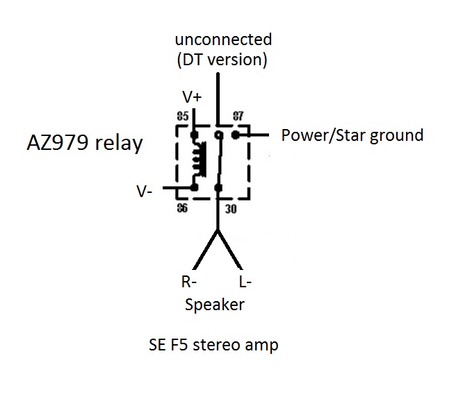

In a stereo power supply (as opposed to dual mono), would one be able to get away with a single SPST by tying together the L&R speaker negatives?
No.
DP because you can switch both outputs of ONE amp at the same time.
DT because you can choose to disconnect (series) or short circuit (shunt) the amp output in case of fault.
Most people use series, so the relay is in the signal path.
I use shunt, because it is non-invasive. But a safty trip will no doubt kill all your output devices.

Ok, not for balanced amp. Will it work for SE F5?

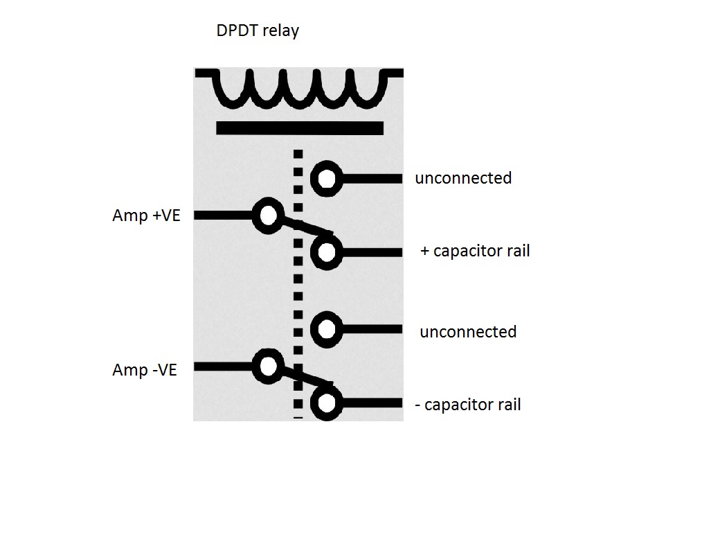

I'm not 100% sure on what you mean by shunt. Perhaps like this?
Post#823 is in theory possible, but you are using common Gnd for both stereo channels.
This people do in headphones.
I don't understand your motivation.
You want to save the cost of one relay ?
All the relays you have drawn above are SPDT, not DPDT.
File:Relay symbols.svg - Wikipedia, the free encyclopedia
Patrick

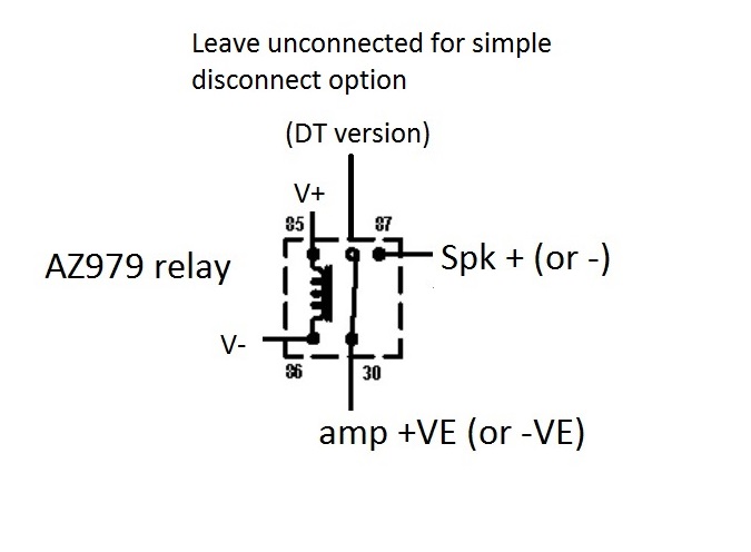

Can I use 12v SPDT? I have two which are 12V.
I think you would leave 87A (center) unconnected

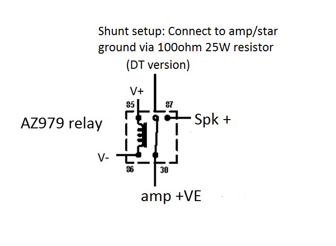

Is this what you mean by short circuit (shunt)? Would disconnecting the power supply to the amp also work?
Shunt means short circuiting the positive and negative terminal using the NC contact of the relay.
Amp will NOT work in any case if auxillary supply is disconnected.
I suggest you do use the series type protection, as published.
Patrick

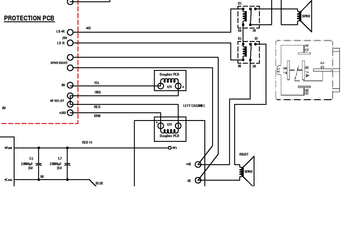

John,
I was worried about my lack of SMD experience as well when I started to populate the protection board. But like you said, the right tools (flux is so important) and some patience goes a long way.
Good luck and let us know how it turns out!

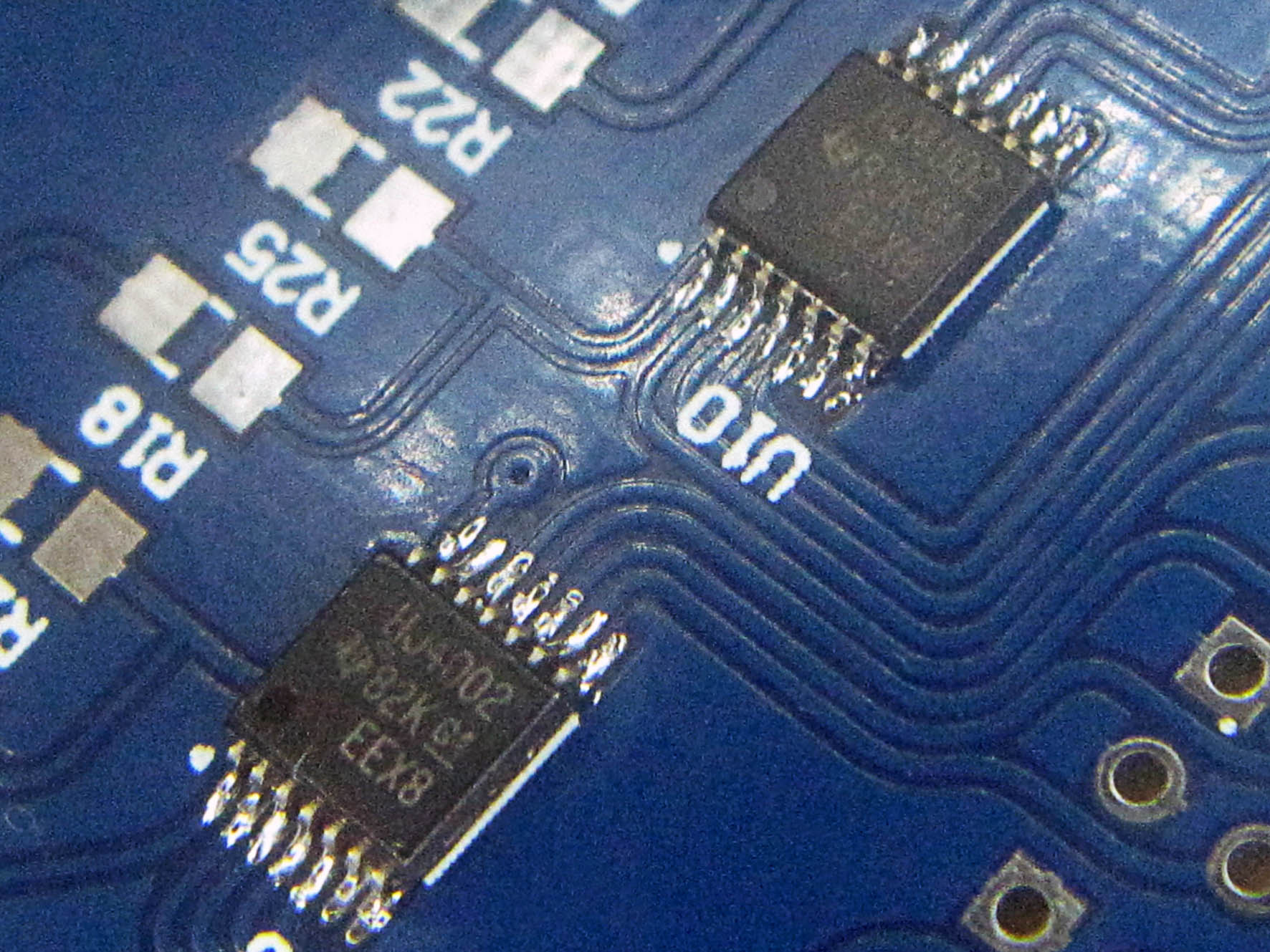

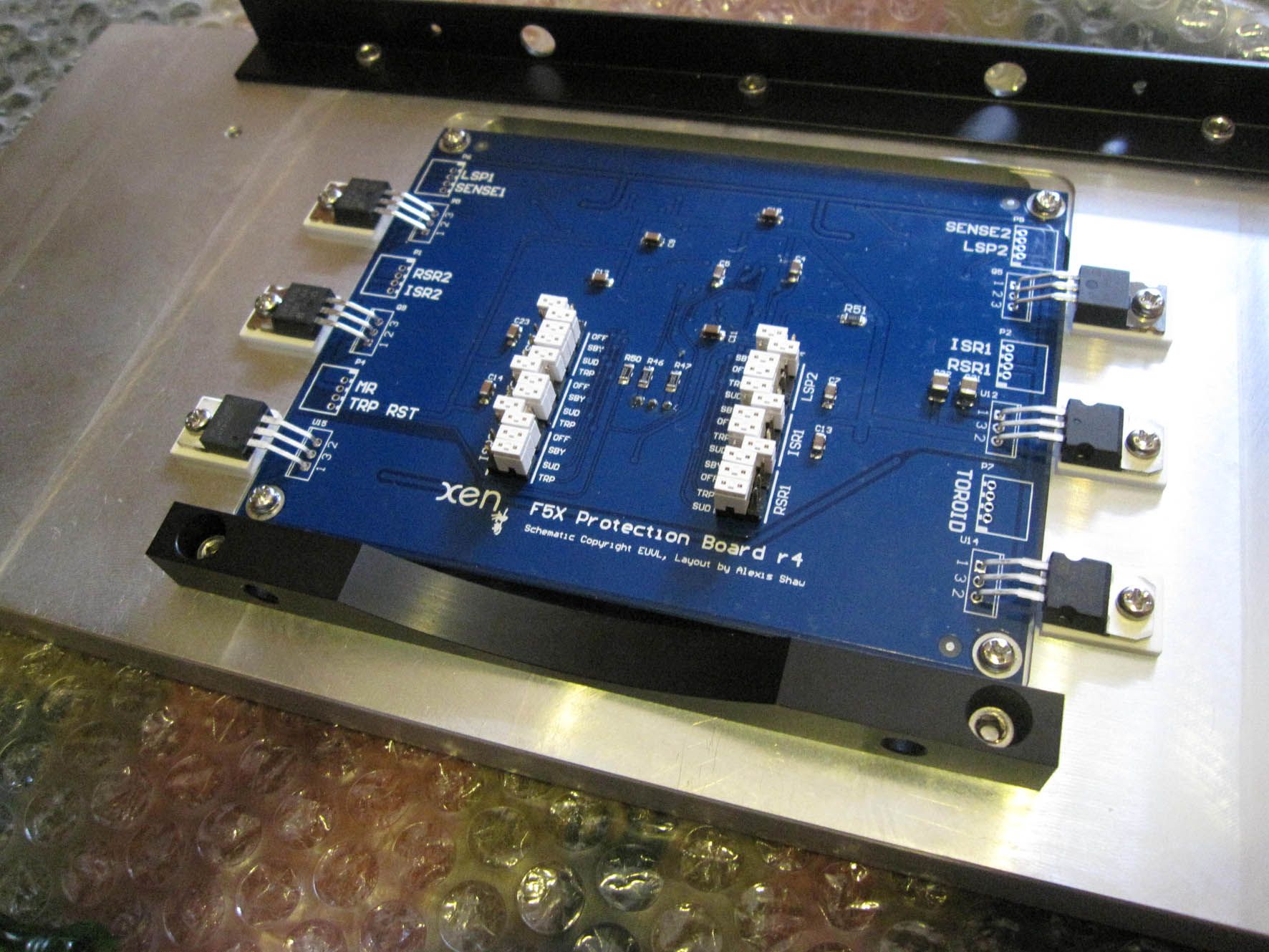

I made good progress this weekend, if I hadn’t ordered the wrong 120kohm resistors instead of the 120ohm I would of found time to test.
I did a diode test, the bi-coloured LED will only aluminate red, I assume this is because of the current state of the circuit setting?
Some progress pics... and yes I need to clean that flux off!
You should make some square-on shots.
Then I can also use them.
Isn't it gorgeous layout ?
Very well sone. 🙂
Patrick
Very well sone. 🙂
Patrick
