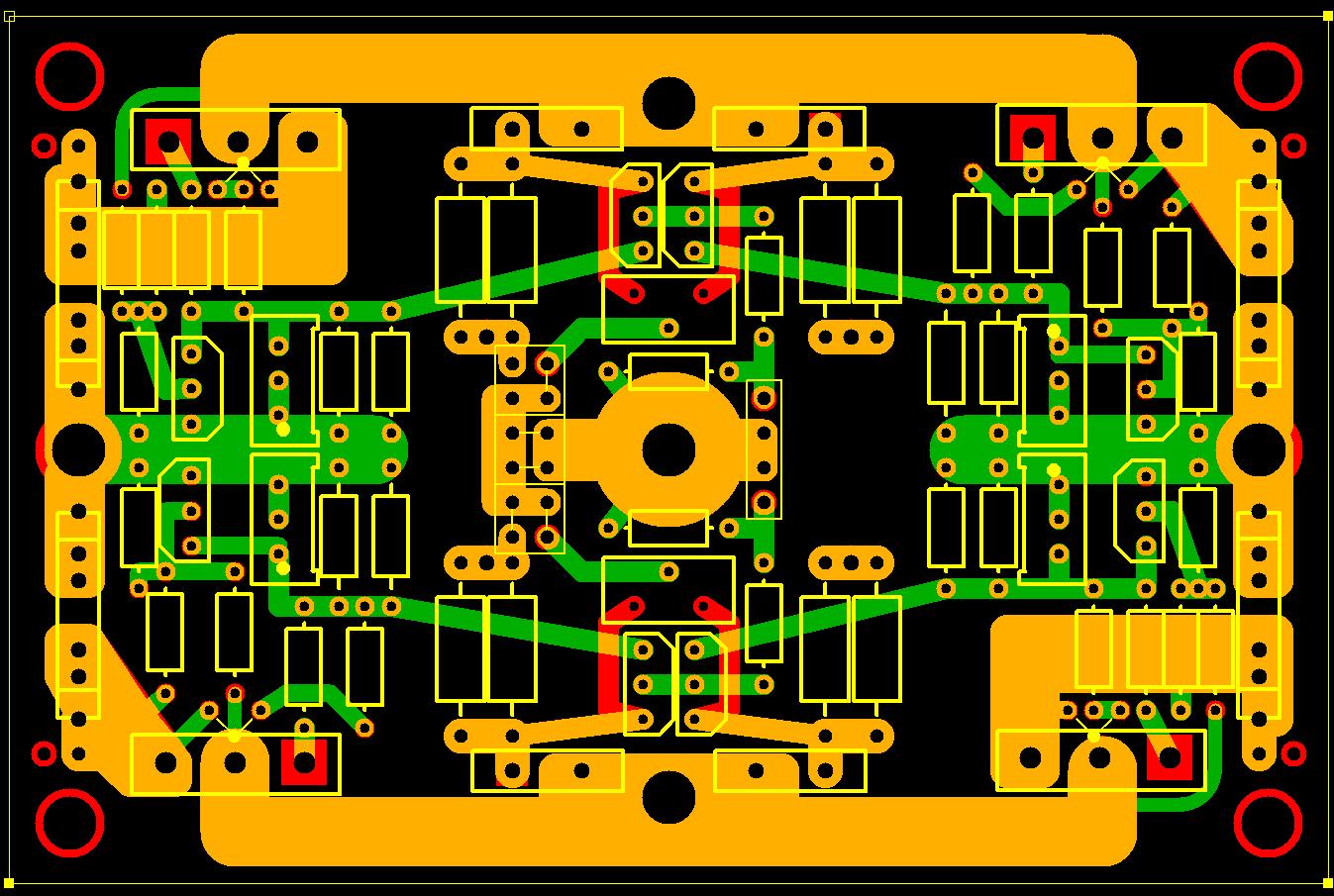

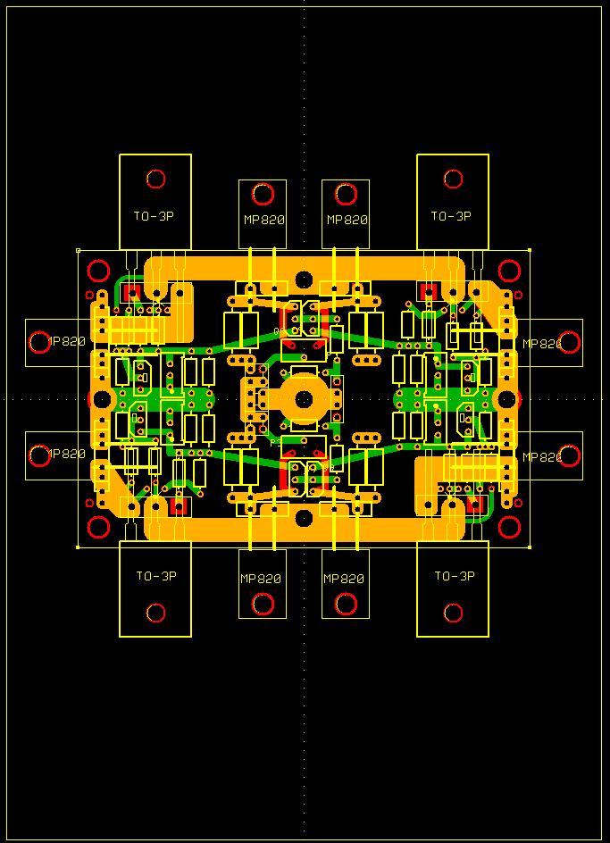

I am working on a variant of Patrick's F5X board that is shrunk to a 2.5" x 3.8" board to be mounted on a 5" x 7" heatsink . Two such heatsinks are attached fin-to-fin to form a heat tunnel, cooled by a very quiet 120 mm fan. Here are images of the layout:
The first image shows the entire heatsink, with the airflow from top-to-bottom (yeah, I know, this is upside-down from normal conventions). The MOSFET placement was carefully chosen for heat distribution. The design is for 100-120 watts dissipation per heatsink.
The second image is the PCB. The resemblance to EUVL's layout should be apparent. Due to space restrictions, the 220 ohm feedback resistors are replaced with Caddock MP820's attached to the heatsink.
There are 2 major jumpers (not shown) for the X connections. Without any other jumpers, the board provides an F5X. Two jumpers provide a floating balanced togolopy, (the X's are connected). Two more jumpers activate Nelson's P3 adjustment. And finally, two more jumpers ground everything for initial adjustment or for use as 2 independent unbalanced F5 amplifiers. The jumpers are intended to be made using .1 inch shunts, but soldering is possible.
Balanced input connections are made using a 4 pin header. At the corners are 2 pin headers for connections to the source resistors for initial adjustment.

There were some discussions about distortion cancellation of the F5X at the build thread.
The original discussion in 2008 (!!!) you can find here.
http://www.diyaudio.com/forums/pass-labs/121228-f5-power-amplifier-24.html#post1538833
Fitzfish and I also stated on a couple of occasions that the measured distortion spectrum does not differ between ground X, floating X, and the H connected (see NP's article on F5 Turbo, the balanced schematics towards the end). However, the floating X or H will allow the circuit to operate with single ended inputs (-Vin connected to Gnd), which is not the case for the grounded X.
