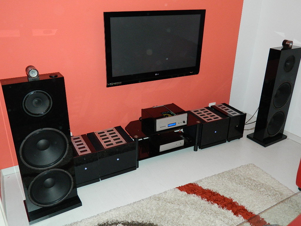

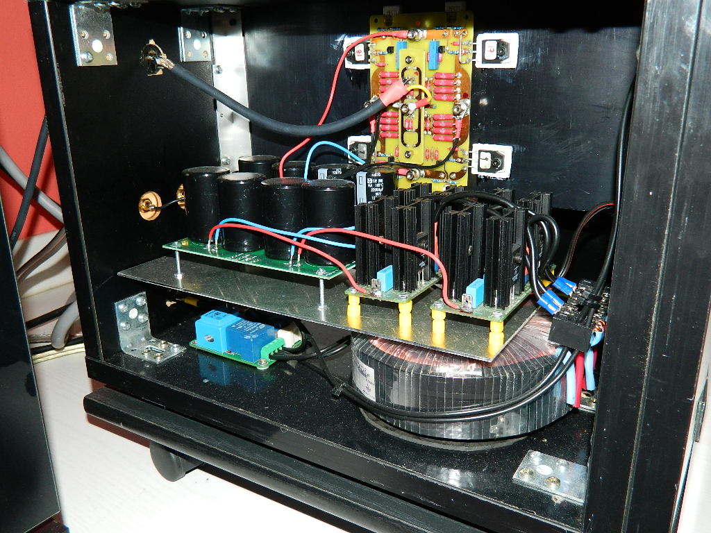

just as an aside and to keep us bobbing along, apart from having more power, how does the F5X compare to the F5 sonically?
I did Aleph5, Aleph2, AlephX, F3, F5.
With the help of Patick, I did F5X.
In my system I now Aleph2 (bass) and F5X for Supravox (full range)
F5X for me is the - BEST!!
It's very quiet, neutral and voices are incredible.
I love F5 balanced ,I want to make one🙂
Thank you Patrick for that my system is this great amplifier!
