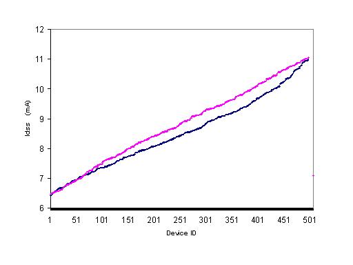

I have a (150) 2SK170-BL's, and I've matched 50 of them. So far I have been getting a nice range of values with most of them in the 6-9mA range. Hopefully the remaining 100 jfets are nicely distributed as well. Once I get the remaing jfets matched, I can probably help out a few people as well.
You can see a typical distribution of Idss for a large enough batch (in this case 500) of 2SK170s and 2SJ74s.
The measurements were done in January 2009.
(Blue is 2SJ74.)
http://www.diyaudio.com/forums/solid-state/135154-next-best-thing-2sk389-2sj109-2.html#post1730586

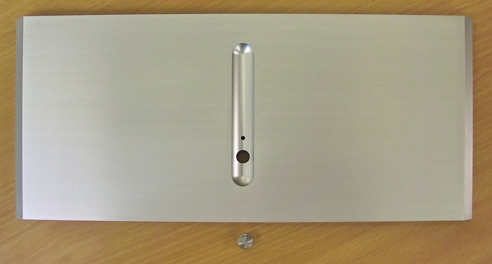

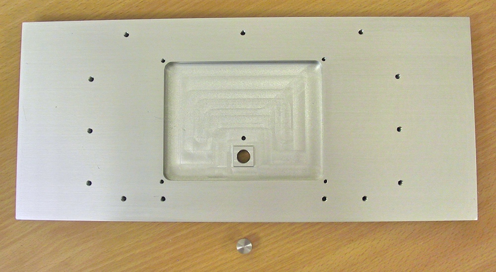

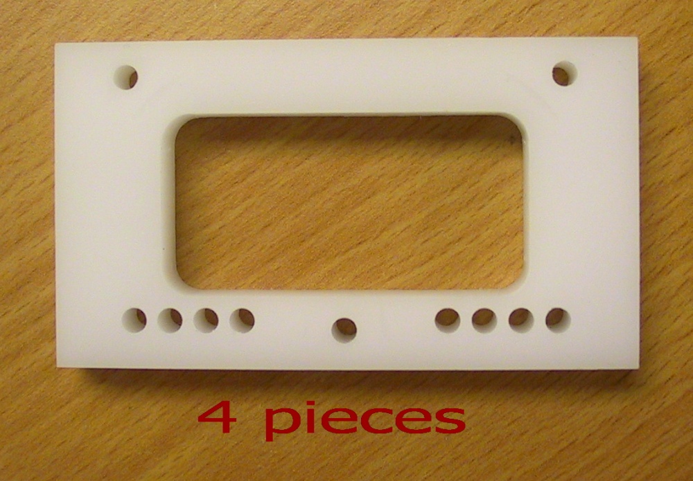

Updated Case Parts Photos
We got the prototype case parts back after some revisions and re-finishing.
We shall post them part by part today.
Assembled later in the week.
Starting with the front panel.
Patrick
Patrick

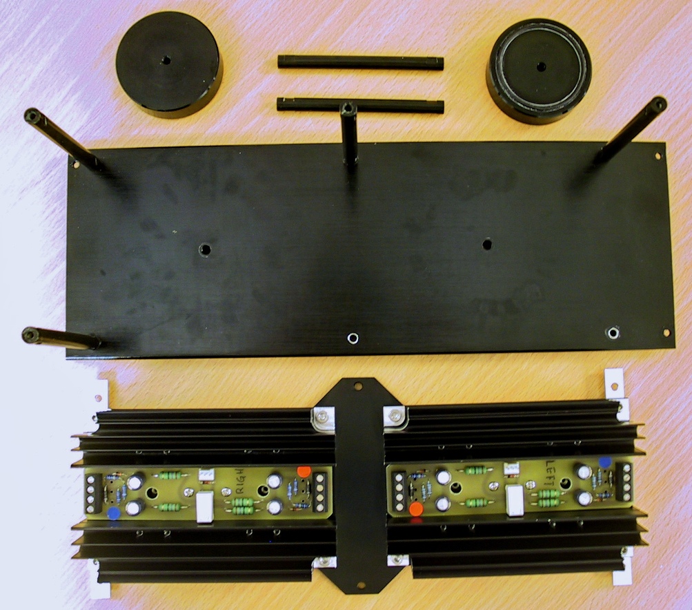

Followed by the cradle, transformer feet, regulator heat sink & PCB, and associated parts.
The plates joining the heat sink will get a much better looking (in design) revision later.
The heat sinks will get re-anodised (to all black).
And the O-Rings will get white silicone.

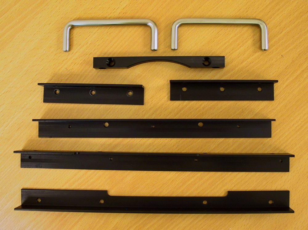

The structural parts :
machined extrusion angles, cross bars, handles, ...

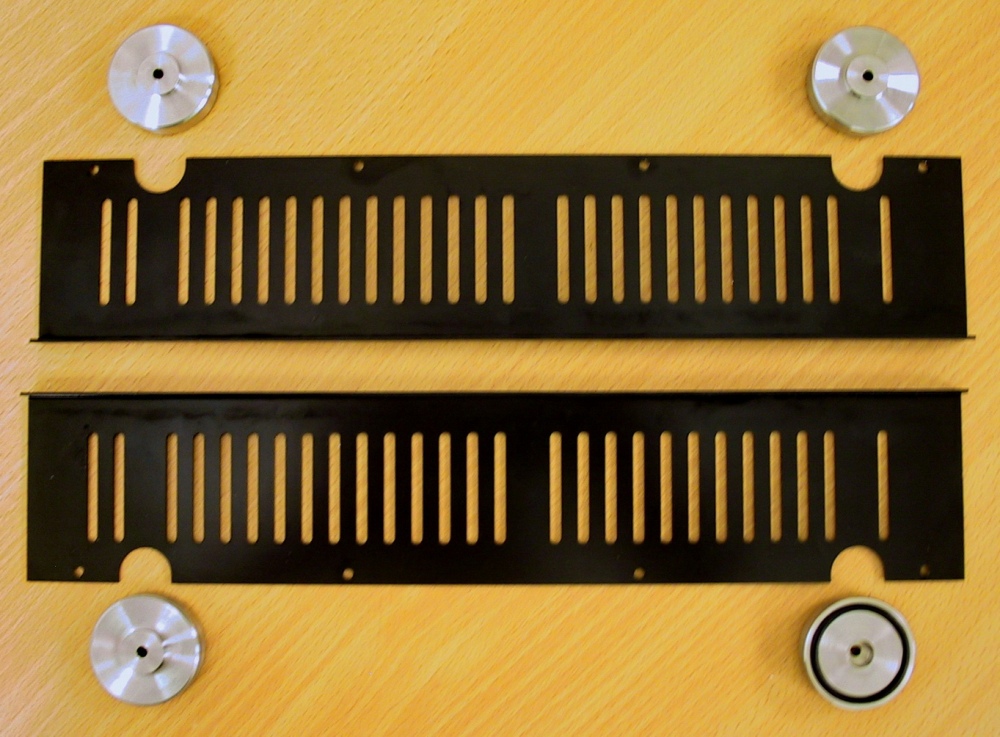

Main heat sink (Conrad MF35-151) feet and bottom covers.
