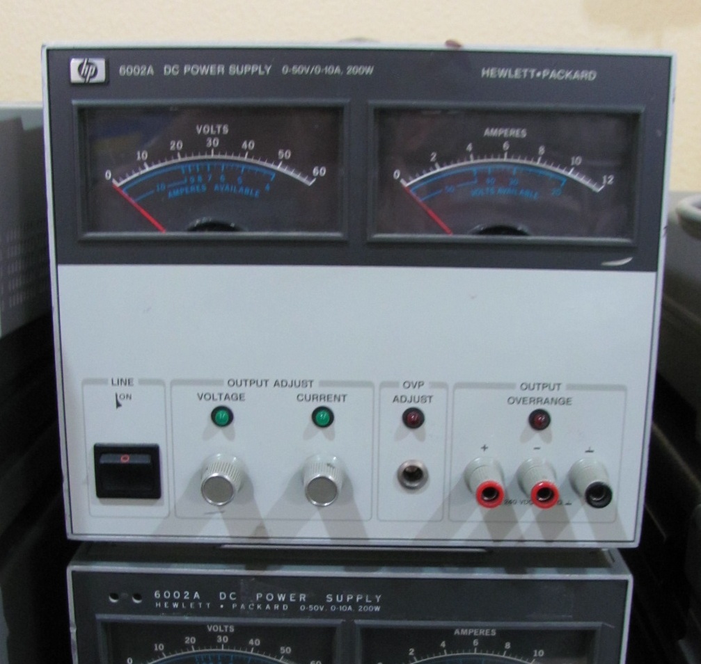

It is also very desirable to have bench top laboratory power supplies with constant voltage (“CV”, adjustable voltage) and constant current (“CC”, adjustable current limit) adjustments. These are what I used so I will describe the procedure with them.
If you do not have laboratory supplies, you can still bias the amplifiers directly with the output from the F5X power supply. You will obviously need to build these first and ensure they are working well with a load of 4 amps per channel. Your dummy load resistor for loading the amplifier output later will work to test the main F5X supplies as long as it can handle at least 200W of power. When the assembly of the F5X supply is complete and it tests OK with no load (a few hundred ohms load minimum is required to test the regulators if used), tie the load resistor from each supply output to ground if you have two 4 ohm loads to use. Do this ONLY WITH THE POWER OFF AND CAPACITORS DRAINED. Alternately, connect the positive supply output through the 8 ohm load resistor directly to the negative supply. Apply power and measure the voltage across each supply to ground. It should be 16V or less +/- 1V. BE CAREFUL as the LOAD RESISTOR(s) WILL GET HOT.
For additional protection if using the F5X supply for bias and testing it is a good idea to add in-line fuse holders from the supply to the amplifier board. You can start out with small fuses when only the front end is tested and work your way up through to the full bias current while changing the fuses to larger ones at each step you increase the bias. The current limit saved my output devices at least once while I was biasing and testing the first board! The fuses might save yours as well…

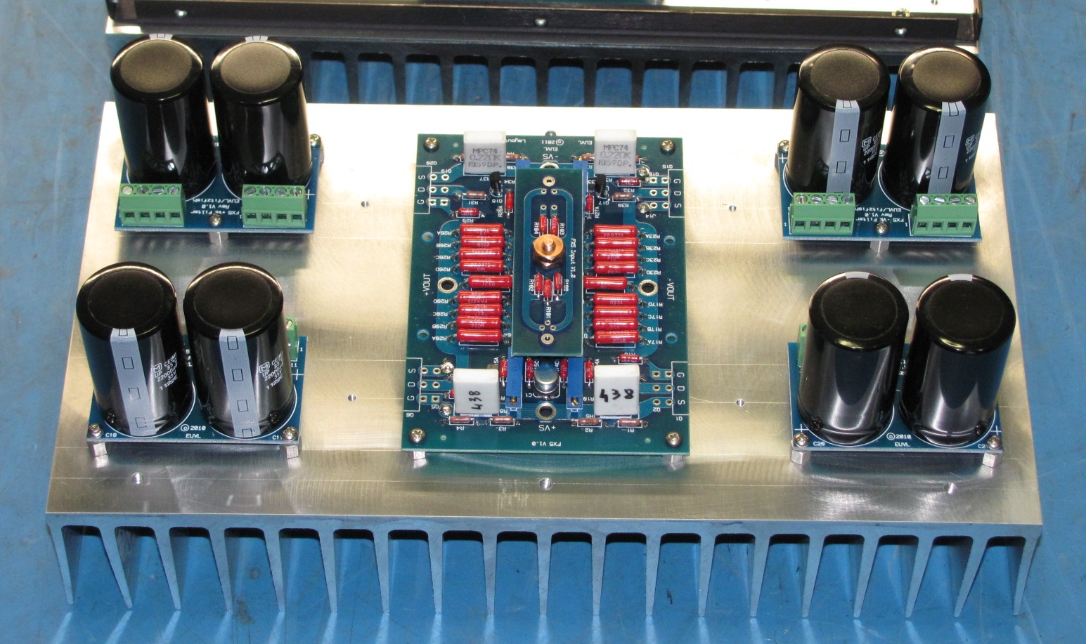

Setting up:
When wiring up your F5X amplifier boards for first time power up using the bench supplies it is recommended that you include at least some bulk capacitance at the amplifier PCB to minimize potential power supply instability or oscillations. If you are a case subscriber it can simply be the final filter boards for the positive and negative supplies. Make sure to observe correct polarity to and from the filter boards. The “+” marks on the filter PCBs are for capacitor polarity during assembly, not the polarity at the connector!
With the amplifiers disconnected from the power supplies set the supply output voltages to +/-16V. I also recommend you set the current limit (CC setting) to 100mA or less while you test the front end bias. First turn the CC adjustment to the lowest setting. Shorting the output of the power supply will force it into CC mode so that you can set the current limit accurately. CAUTION – if your bench supply does not have a constant current mode shorting the output and powering it up may damage it.
With the power off, wire the bench supply(s) to the amplifier board you wish to test. Make sure to observe the polarity of the positive and negative supply. Any mistakes from this point on could prove catastrophic!

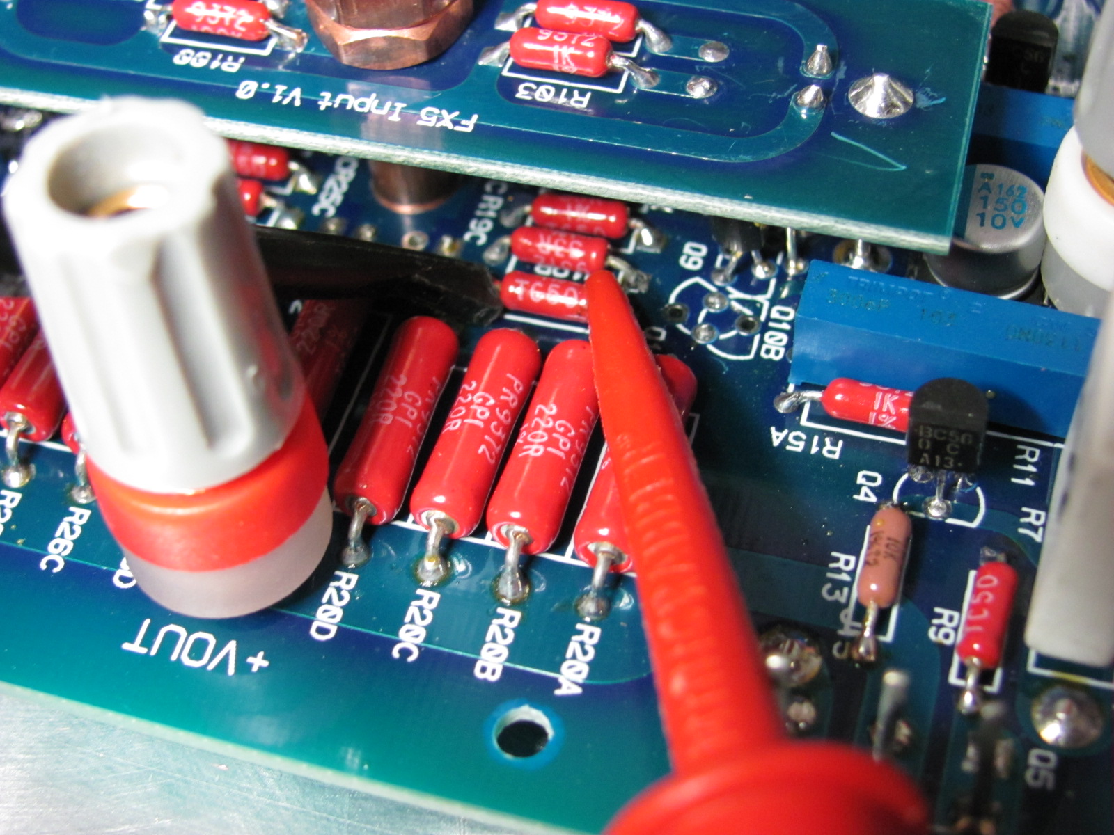

Measuring the front end bias:
This is done before we install the output devices. We will be measuring the voltage drop across the 11 ohm resistors (the parallel combination of the three resistors that make up R18, R19, R24, or R25) to verify that the front end is working properly and that it is reasonably balanced. Turn on the previously adjusted power supplies to the board. Assuming everything is good there should be no magic smoke and the supplies should not be folding back in CC mode. Measure and note the voltage across resistor R18A, R19A, R24A, and R25A. This voltage divided by 11 is equal to the current flowing through that leg of the front end. This current should fall somewhere within the curve when you matched the J74/K170 sets with the multi-point method described earlier. If everything is working well each measurement will also be very close. If they are grossly different, disconnect power and recheck everything.

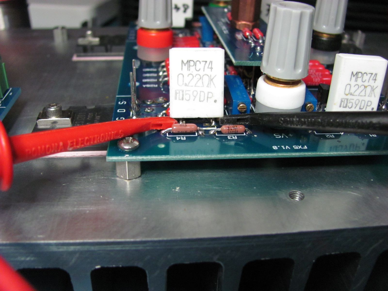

To measure the bias add clip leads to each leg of the 0.22 ohm source resistor for the device you are adjusting as shown below. I also connect a dummy load resistor to the output for the side I am testing. Connect the other end of the load to the local ground at the center of the amplifier PCB.
Apply power and check to see that the bias current is somewhere in the 1.5A range for each device. If the supplies go into current limit something is likely wrong. REMOVE POWER IMMEDIATELY and check for errors. You can measure the current at each source resistor if the lab supply does not include one. The lab supply current meter should read around 3A at this point. Don’t worry if the device bias currents are not exactly equal right now. +/- a few hundred mA is good enough. If everything looks OK at this point leave the assembly on for at least 30 minutes to warm up before adjusting further. Keep checking back to make sure it is still operating at around your initial set point. Once warm it is time to adjust the bias closer to the final value. Don’t forget to increase the current limit on the lab supplies supply the final target of ~4A plus a little margin to keep them out of limit while adjusting.

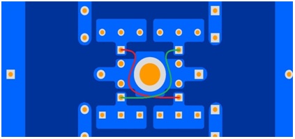

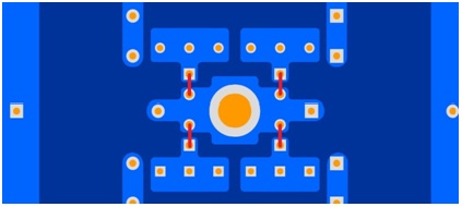

Converting to floating X mode:
For initial biasing and testing it was necessary to attach the source of each of the JFETs in the front end to ground. Now that it is up and working it is time to modify it to the floating X configuration. In Floating X configuration, both differential and SE inputs are supported.
Remove these jumpers original installed on the bottom of the amplifier. You will have to remove the amplifier assembly from the heat sink to do so. It is also helpful for de-soldering and re-soldering here if the amplifier assembly is still warm.
