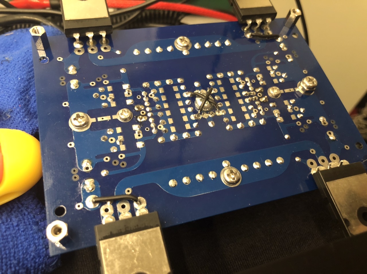

There were some questions about the X connection.
I guess the best is to use the one published by Nelson :
http://www.firstwatt.com/pdf/art_f5_turbo.pdf
(page 15)
You can call it X with a dot in the middle, or an H.
Either can be done on the PCB easily.

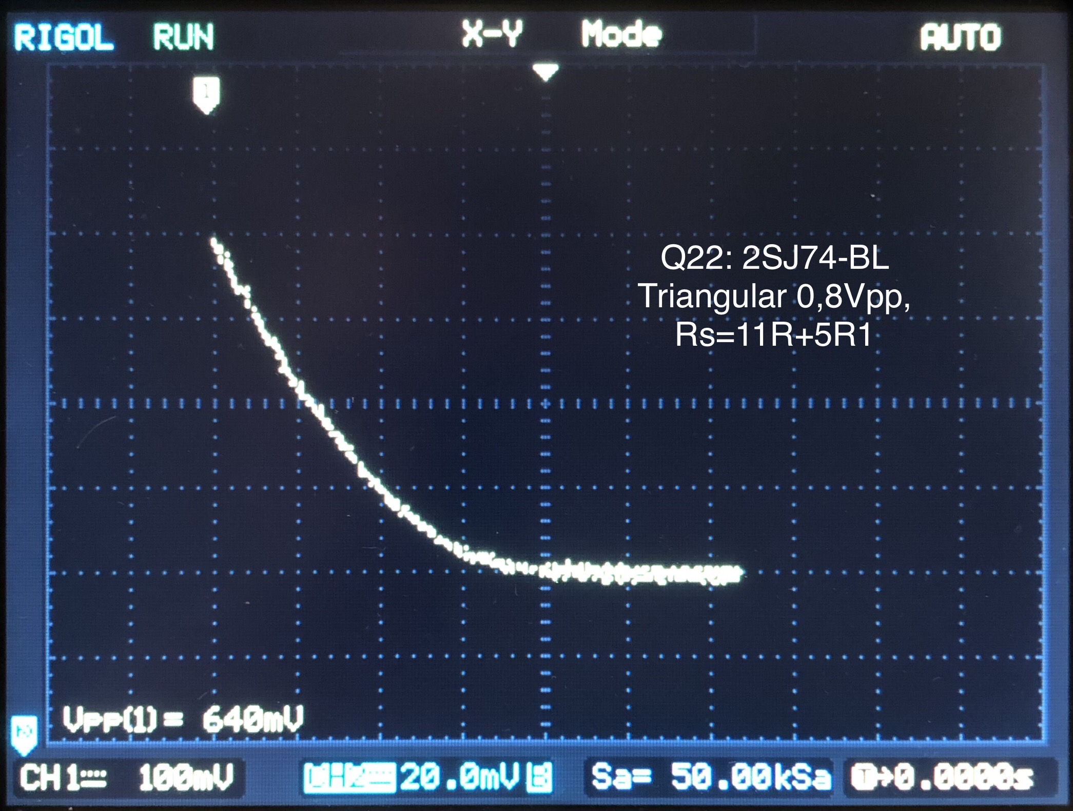

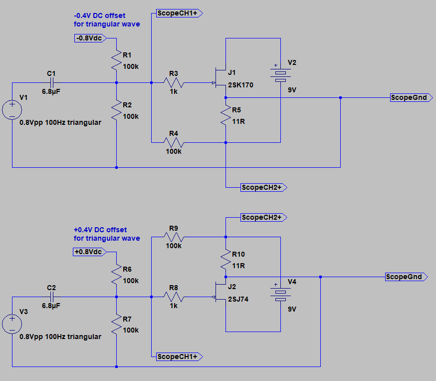

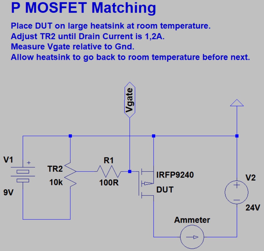

Due to some confusion in my measurements that gave me the wrong assumption that something was damaged in my build, I had to do some extensive measurements for the JFETs and MOSFETs only to find out that there was no fault. 😀
Here’s some report what you are able to measure if you boubt a faulty device.
JFETs can be measured even when they are soldered to the pcb. Note that the MOSFETs must not be installed. The X point of the JFETs needs to be floating and then you connect 1k (R3/R8)and 100k (R4/R9) resistors and scope channels according to the picture 1 attached. The dc offset part (R1,2,6,7) can be omitted if your signal source has dc offset functionality. You should then be able to plot in X-Y mode of the scope a curve that should correspond to the JFETs Vgs/Id curve. See pic 2 for example.
The MOSFETs Vgs at targeted rail voltage and bias current can be measured according to pic 3. This is presented somewhere in the UDNeSS thread as well. For the F5X you want to have 16V and 2 A. Remember to change the connection for N channel device.
Thanks to Patrick for the measuring guidelines and ideas. I couldn’t have done it by myself.
After successful measurement results I was confident that my circuitry was intact and I could proceed with re-soldering once again the output devices into place. After checking bias currents and dc offsets I went on measuring some distortions.

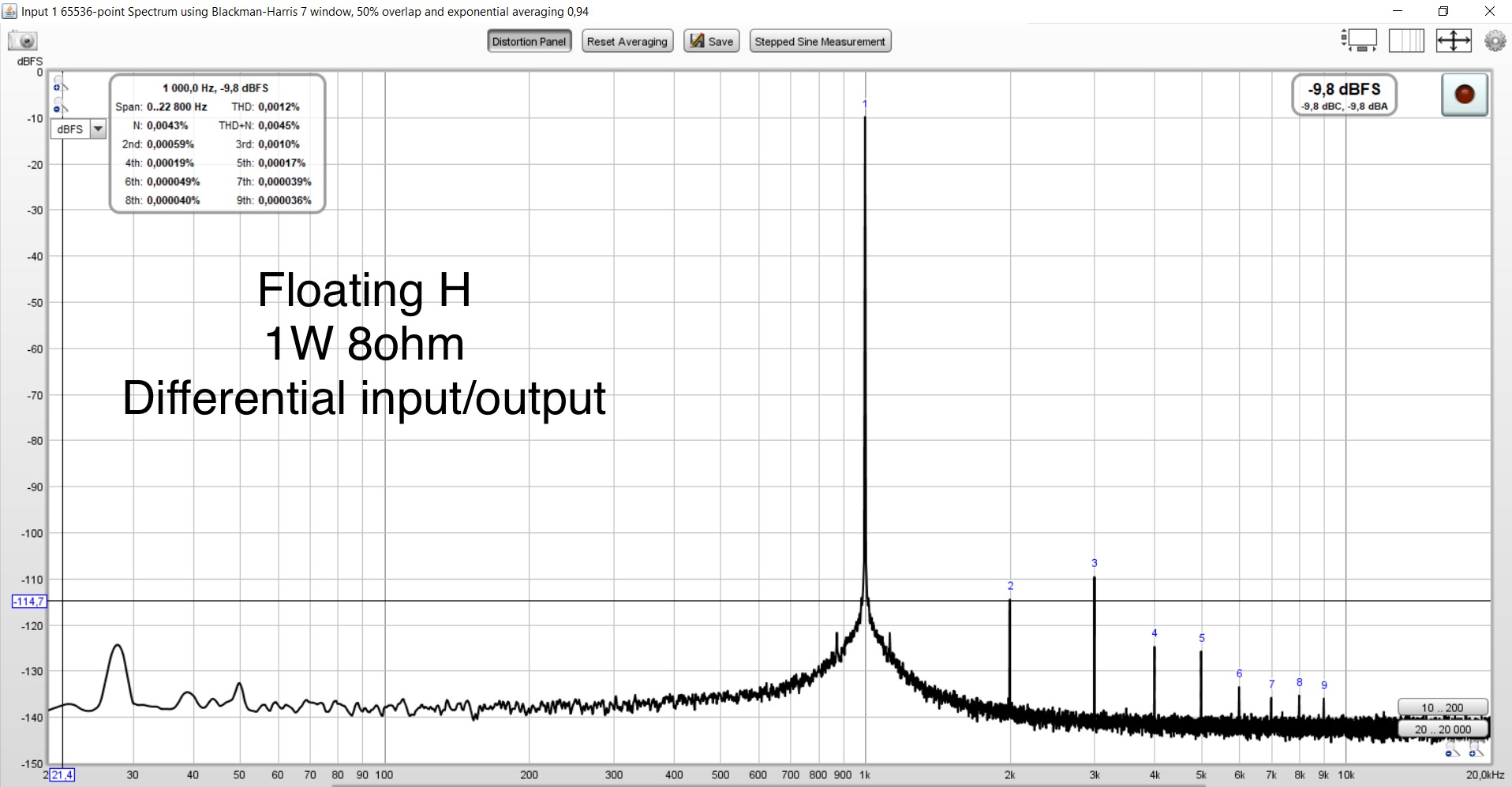

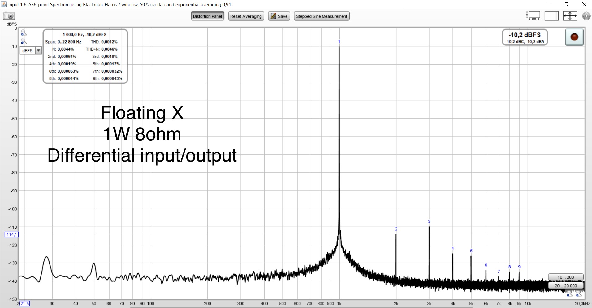

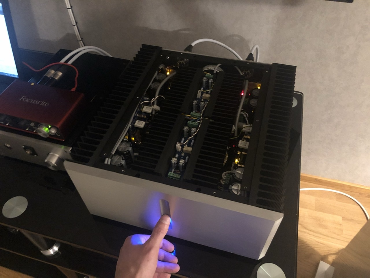

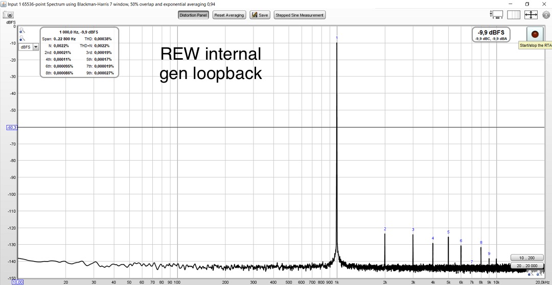

My distortion measurement setup is simply a Focusrite Scarlet 2i connected to a laptop that is running REW software. Loopback measurement using balanced in => balanced out connections is presented in pic 4.
Pic 5 is my F5X in floating X configuration and pic 6 the same with floating H config. Measurements were done in balanced mode with 1W/8ohm load. Very similar results, but the H is a tiny bit better with second harmonic. Amazingly low distortion from a class A diy amp. 🙂
As it should.
And the even lower H2 than H3 is the evidence of the level of device matching.
Patrick
As it should.
Patrick

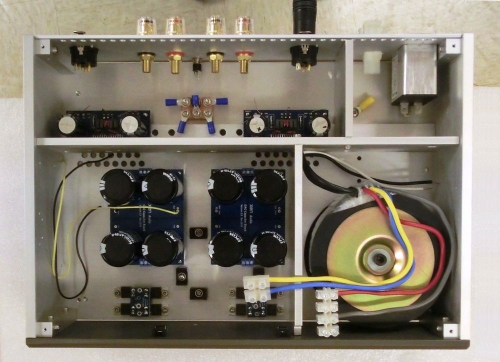

I showed you my LM4780's in post #1272.
A team member in HK wants to have a summer amp to go with his F5X Pre.
(HK summer is 35°C. You need air con, and the F5X adds to the air-con load.)
So I propose to use the same LM4780 inverted.
Here is the result (photo is from earlier, unfunished state).
Case is adapted from the F5X Pre.
Patrick

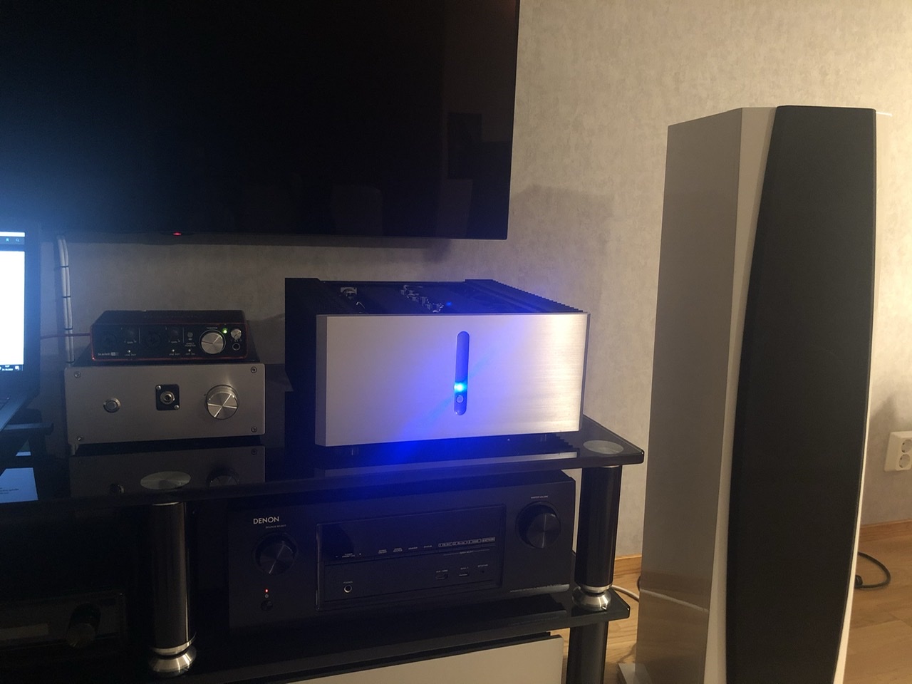

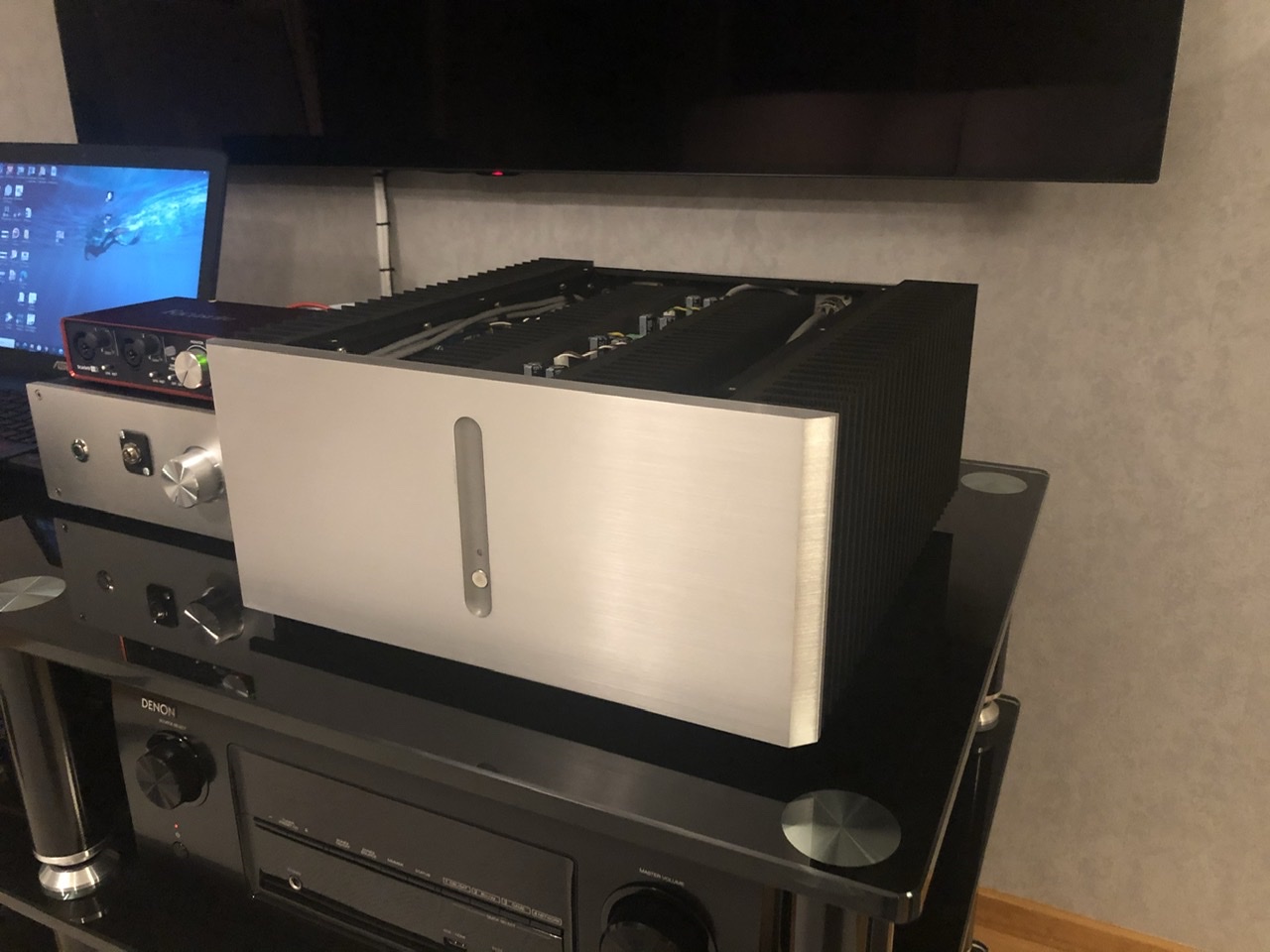

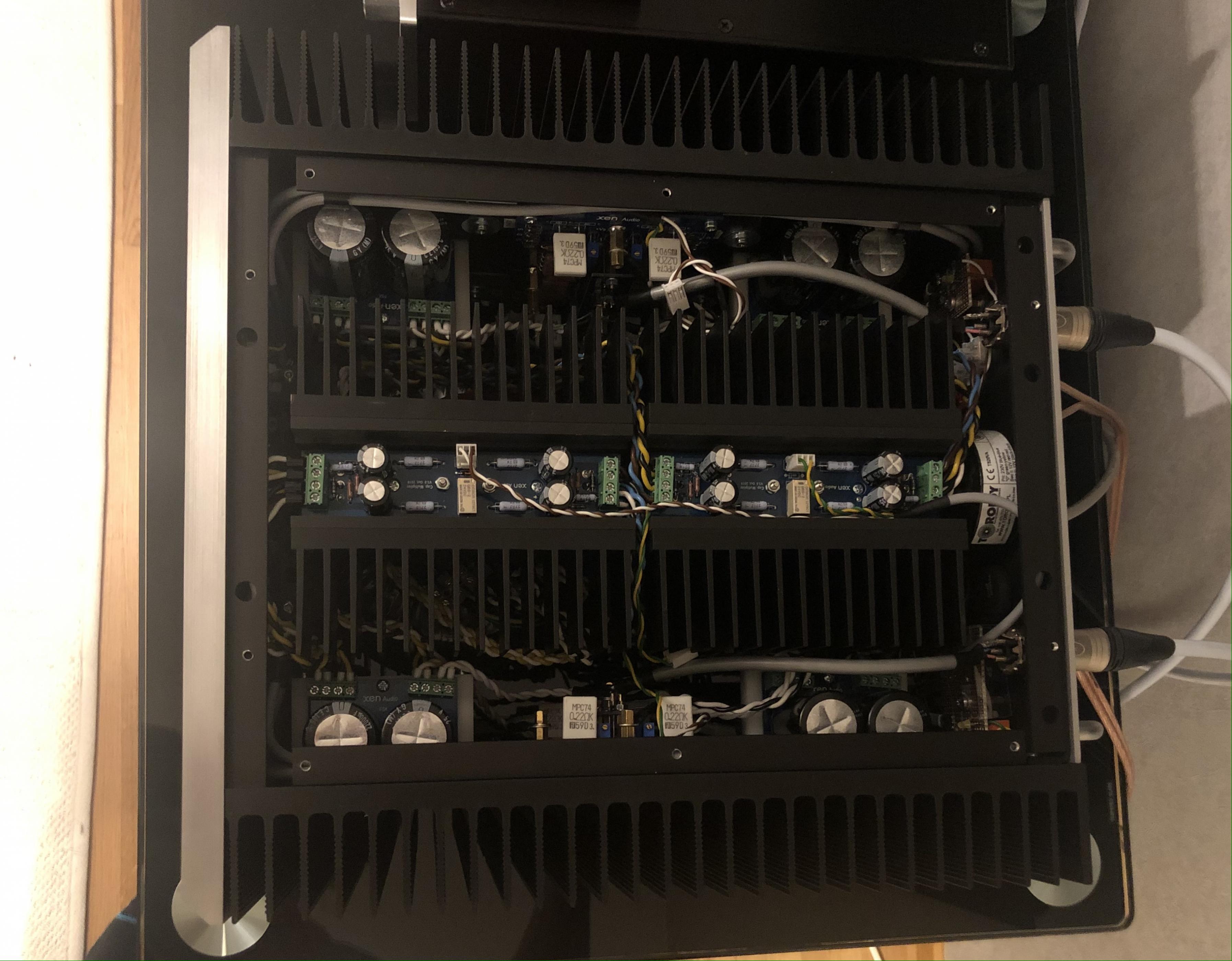

The First music track (Tool - Pneuma) has been played with my F5X! 🙂 Dead silent background without any noise.
Still need to measure and adjust bias currents since it seems to be running a bit hot now @~1.9A.
I attached a couple of quick and dirty photos.
Thanks a lot Patrick and Carlos for making this happen!
