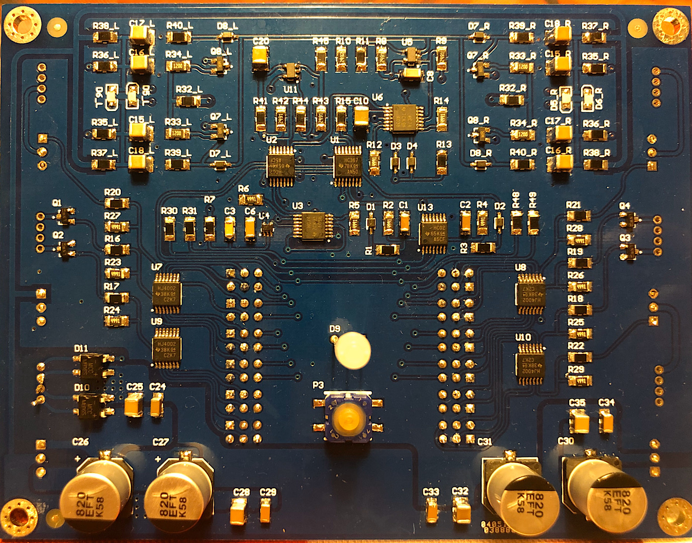

I've started to assemble the control/protection board and I noticed there is something unclear about some resistor values (at least for me). For example R32_L/R values are marked 2.0k in the BOM (but also 2.7k on the comment column?). Also I can see in NicMac's build picture here (post #449) that he has used value 2.7k. So is it 2.0k or 2.7k for the rev. 4 boards? Sorry if this has been discussed earlier in this thread.
Also for R33_L/R, R34_L/R and R41 there are some differences between "Description", "Comment" and "Digi-Key part number" columns in the BOM.
See post #1247.
Nic complained his does not trigger.
This has been explained in detail in the thread and the values revised.
The small differences between description, comment & digikey no. were due to availability at the time.
Exact values not critical.
Please take time to understand how everything works, including the protection board.
A lot of effort has been put into explaining.
Once you understand it will answer a lot of those questions automatically.
It is part of the DIY experience, not just solder and power up.
Take your time and enjoy the journey.

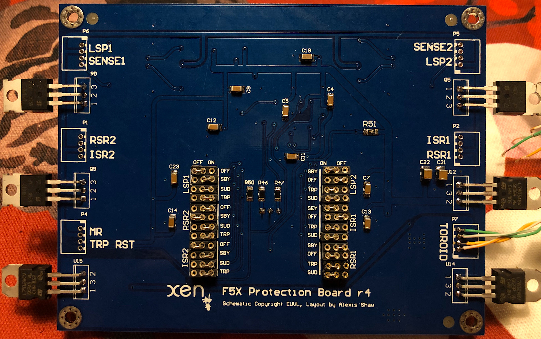

Yes! The most frightening part (for me) of the project is finished. The protection board is now soldered and tested and it seems to work as it should. 🙂 I was very unsure about soldering the TSSOP devices but managed to pull it of by applying too much solder at first to the pins and then removing the excess with solder wick.
Congrtulations. 😉
You should be using a 3mm Red/Blue LED ??
> but managed to pull it off by applying too much solder at first to the pins and then removing the excess with solder wick.
That's the right way.
Soldering is really need and tidy. Practice makes perfect.
But wait till you try stuff like OPA1688, by hand. 🙂
