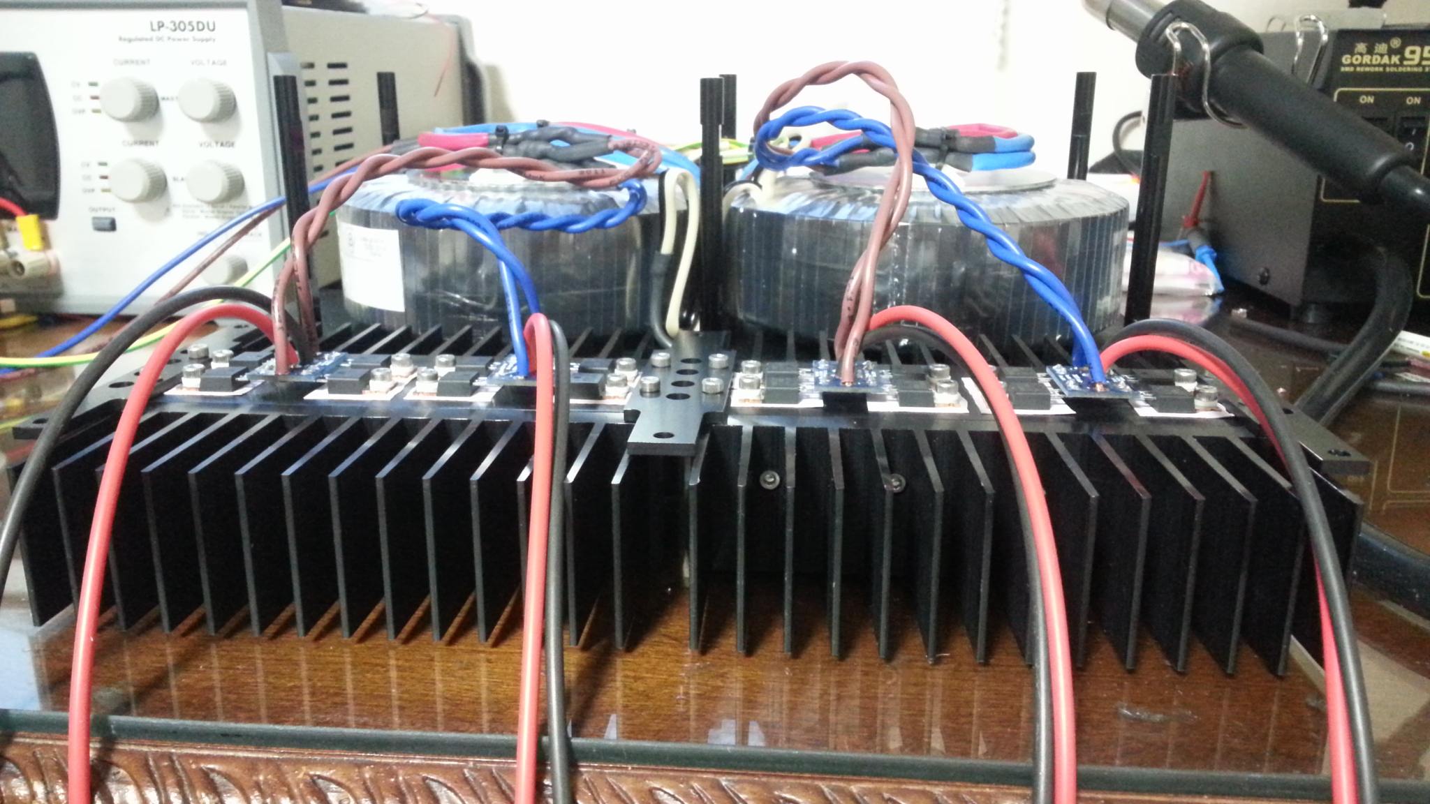

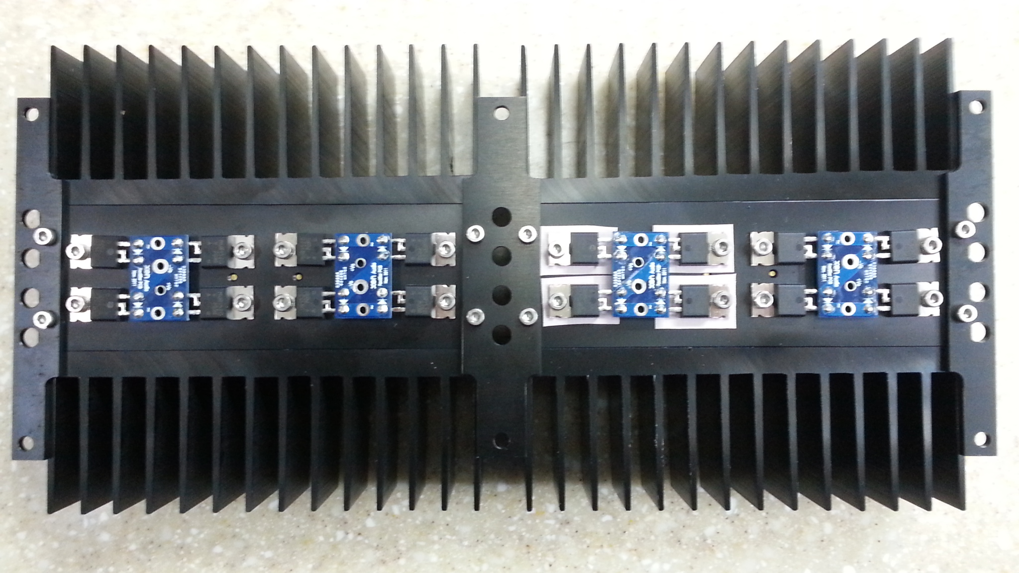

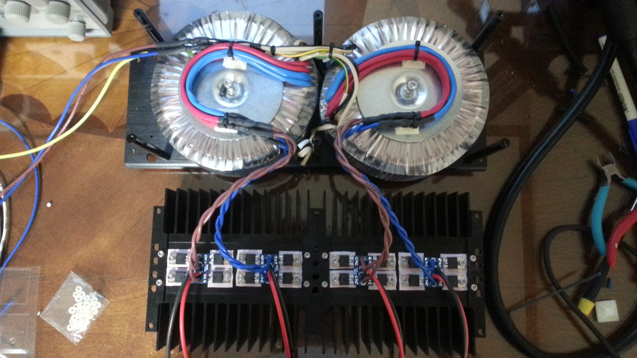

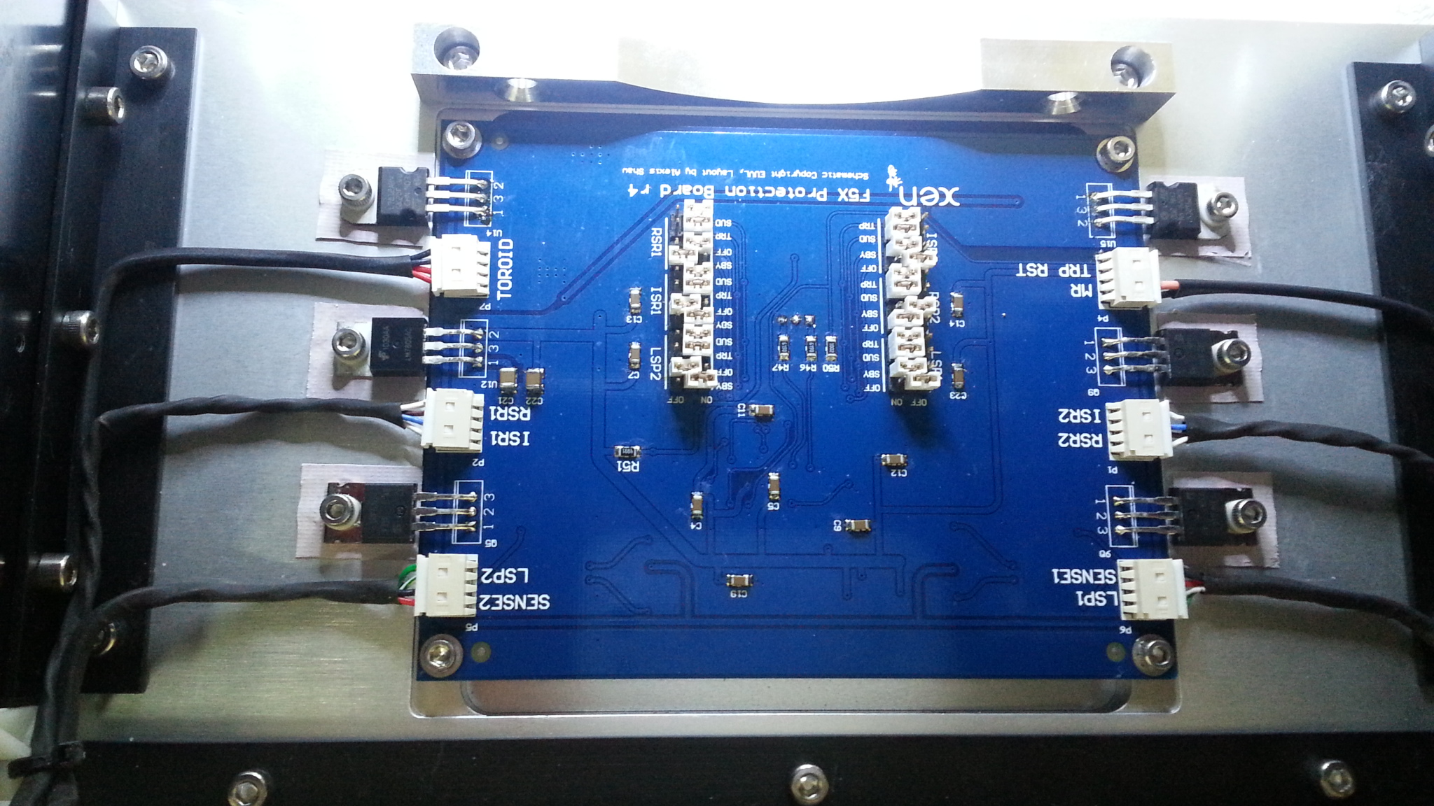

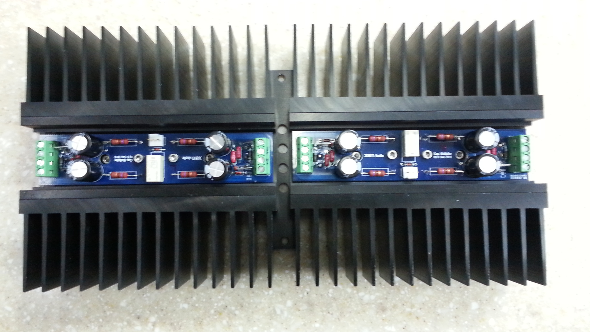

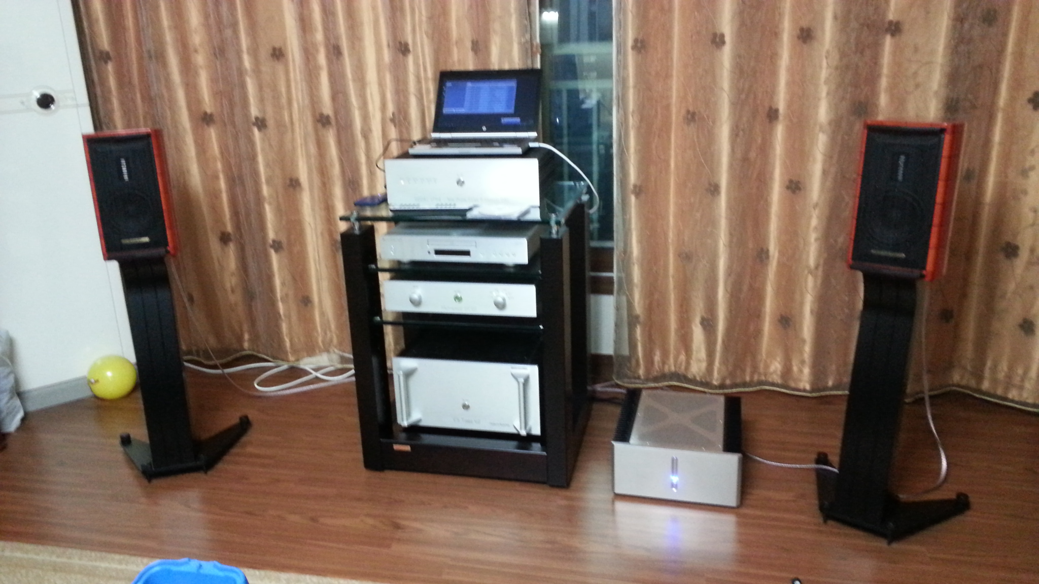

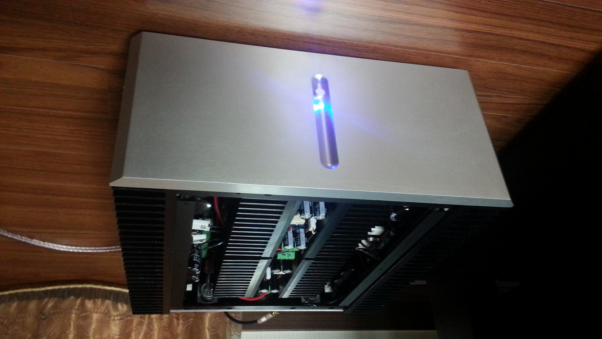

The protection PCB is completed and fully functional and tested.

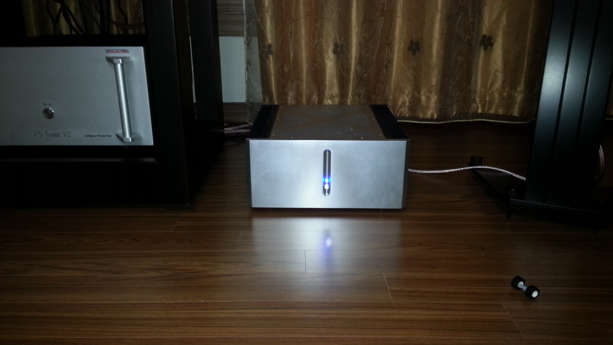

I complete the building of the F5X and now is playing music since one hour😀
I bias at 1,5A with 0 mV offset and I have to say that is really hot!
I will recheck both bias and offset in two hours and I hope that the bias is not going too high.
I have to say that is not playing at his best, is connected to a DCB1. I am waiting a Rane BB22 (passive converter RCA/XLR) that is on the way.
I will use it until the F5X Preampli will be published (I think that I am not the only one 🙂)
Thanks to everyone of you for your kind help.
A particular thanks to Patrick which enabled us to build this TOP Class amplifier and to Mark Lai for all the logistic support.
Attached some pictures (apologize for the poor quality)
All the Best,
Enrico

pics 9 & 10.

ROLF 😀
I have no idea why I can't attach the pictures in the proper side... in my PC are in the right side but when they are uploaded are in reverse😕
Solved only taking new ones🙂
Could be an EXIF setting. You can usually fix it by rotating it with MS Paint and re-saving it.
