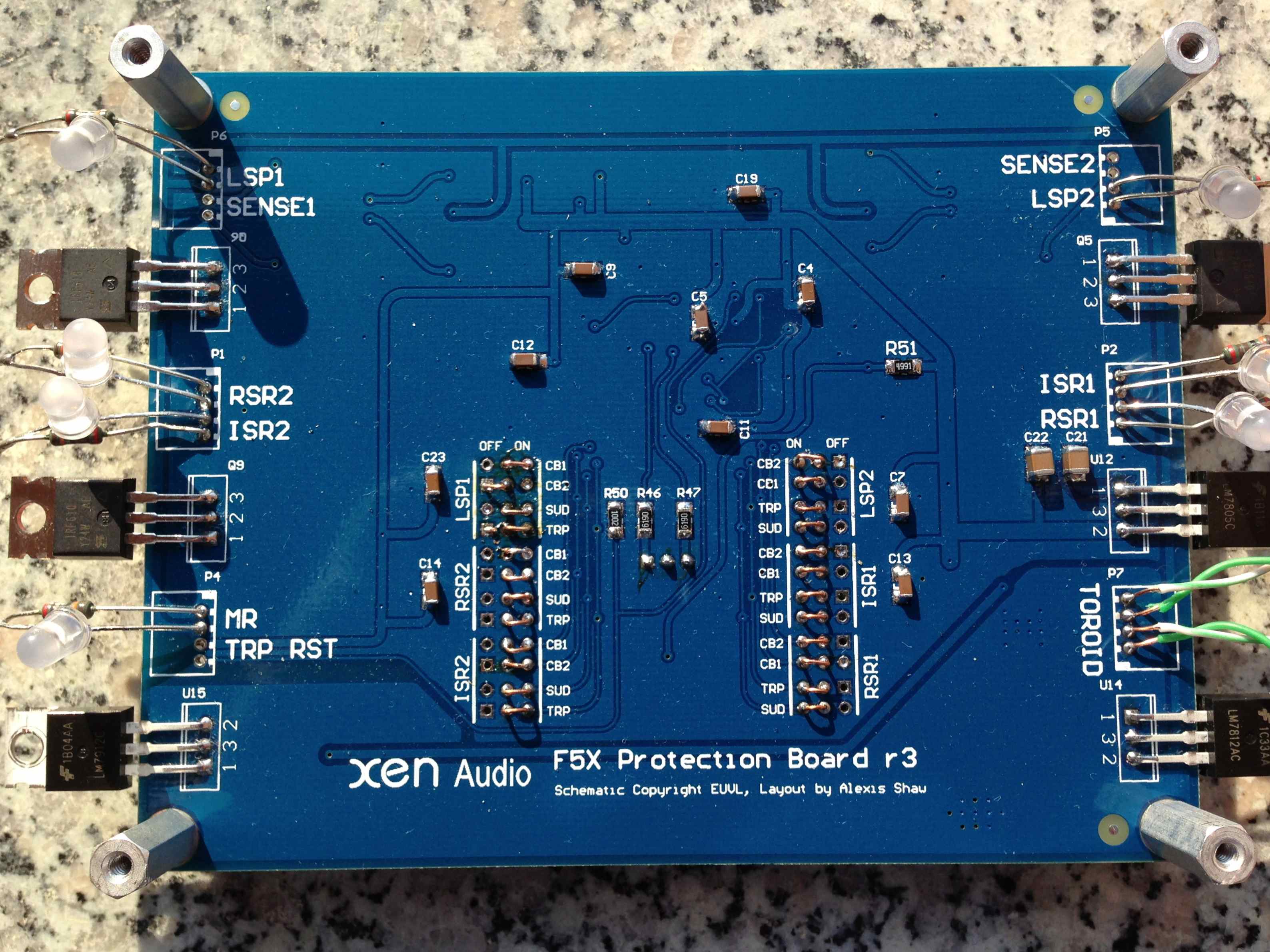

Here are a few photos.
To check the correct operation of the board I use LEDs with current limiting R in series. This gives a nice visual readout of relay behavior.
If all the jumpers are in the ON position you will find that all LEDs are ON in the SBY state and OFF in the ON state.
This assures maximum exposure of DC offset to your speakers and no music when the amp is on😱

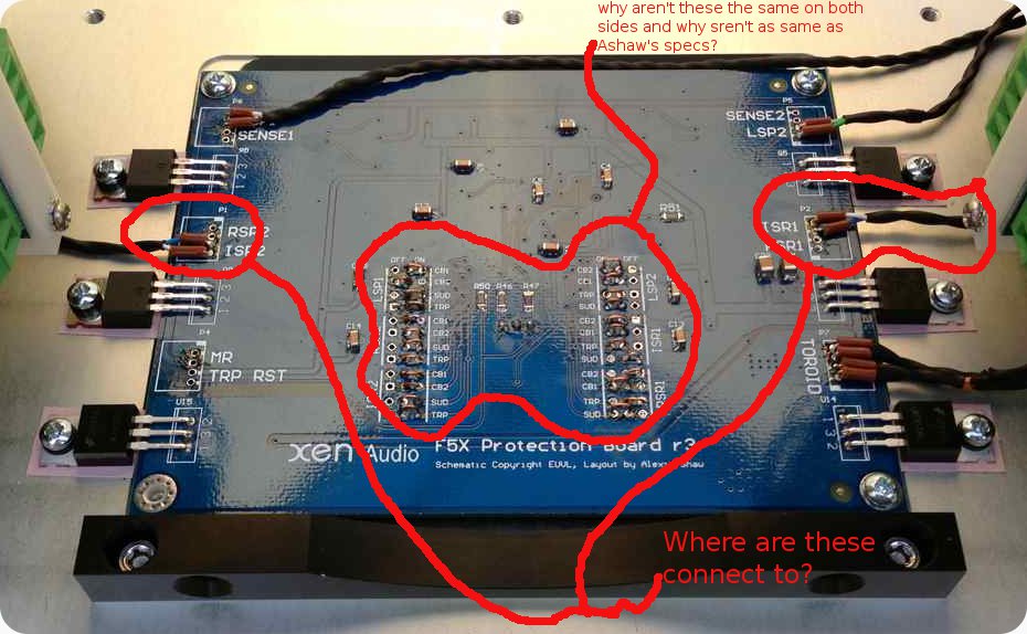

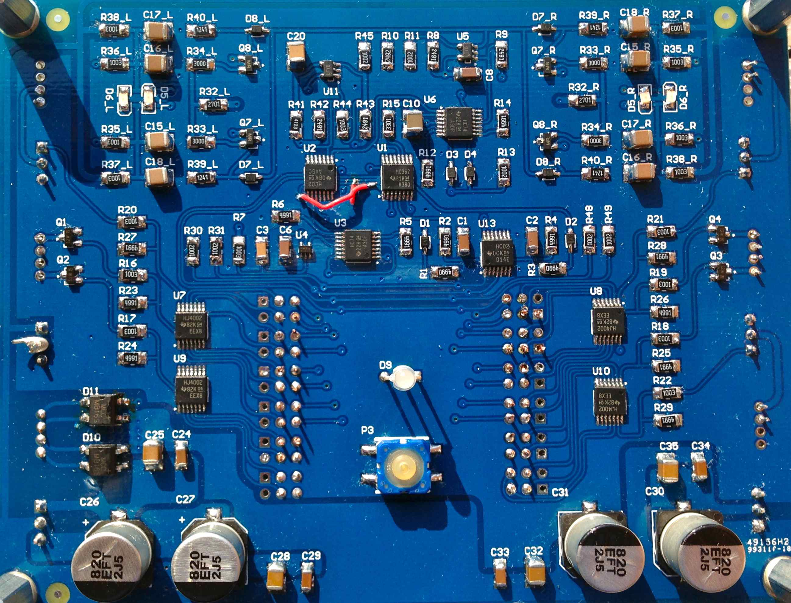

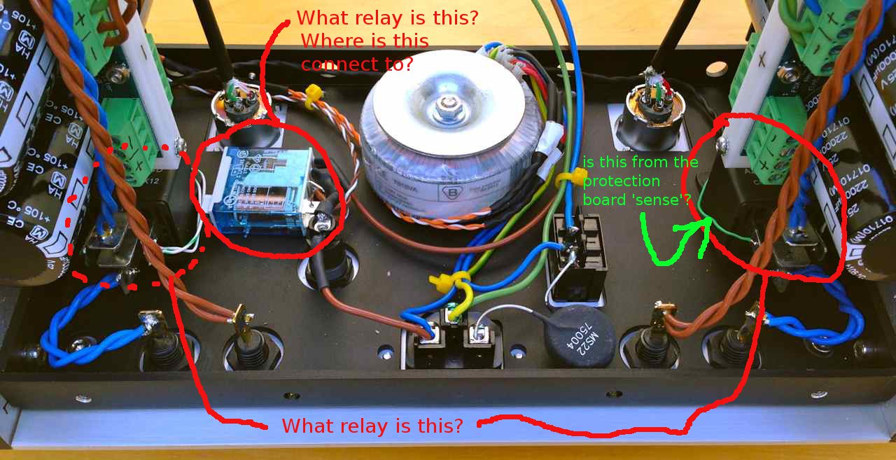

Hi Nic,
I see a couple of relay at the speaker terminal and are not in the BOM.
1) Was there a group buy for these?
2) What are the specs?
3) Also the relay at the fuse holder, why do you need this?
4) On the control board, where are the ISR 1 & 2 connect to?
5) Why are the "On" and "Off" positions different on both sides?
On the mute image you posted earlier, I can also see 2 wires going out from the mute board.
6) To where are these connect to?
Thanks.
Not that I know of. Heinz1 was kind enough to buy for a few of us in europe.
I don't recall. Search the threads and you will find it.
This is the main relay. It connects fuse to main transformers when on (see the schematics that Patrick posted in the main thread). I use the LSR1 driver on the control board to control this. I think Mark mounted this relay on the transformer cradle. If you want to be able to turn on the amp using the push button on the front panel you need this relay.
The mute boards.
All jumpers (except one) are in the same position on both sides.
>On the mute image you posted earlier, I can also see 2 wires going out from the mute board. 6) To where are these connect to?
ISR drivers on control board.

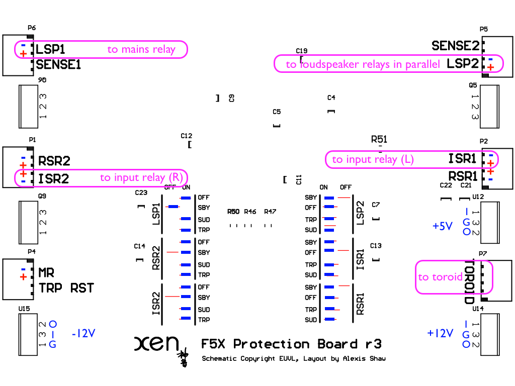

Jumper control:
The behavior of the relay drivers can be (partially) controlled using the jumpers on the board, the position of which determines in which amp state(s) the 6 relay drivers are high or low.
For each of the 6 relay drivers there are 4 jumpers labeled CB1, CB2, SUD and TRP. These jumpers represents 4 of the 5 states that the amp will ever be in.
CB1 = OFF state
CB2 = standby state (SBY)
SUD = start up delay state
TRP = fault state (i.e. DC on outputs to my understanding)
There is an important last state that the amp may happen to be in (hopefully most of the time 🙂), but there are no jumpers to control what happens in this state. This state is ON and all six relay drivers are high.
The jumpers may be put in one of two positions labeled "ON" and "OFF" on the PCB. For my personal testing and experiments I put all the jumpers in the ON position. This is a good and recommended (by me at least🙂) starting point. What happen in this configuration is that none of the 6 relays turn on until the amp is in the ON state. If you want a given relay to come on already in the standby state (for example the main relay😉) you move the SBY (labeled CB2) jumper from the ON to the OFF position. Logical right😉
In fact, with the F5X you probably only ever want to move the SBY (CB2) jumpers. Leave the rest in the "ON" position.
The remaining jumpers (OFF=CB1, SUD and TRP) are used to turn the relays high in amp states where this seems either useless or dangerous. For example you may connect the speaker outputs in the fault state if that is to your taste😱
Protection board revisions
The silkscreen shown in the previous post is the one posted by ashaw some pages back. My PCB's are labeled with the same revision number "r3", but the silkscreen is different.
The jumper rows labeled OFF and SBY on the silkscreen posted by ashaw are labeled CB1 and CB2 on my boards.
Do I/we have an old PCB revision?
If not, why was labeling changed from the meaningful OFF and SBY to CB1 and CB2 on the last revision? Curious minds want to understand.......
