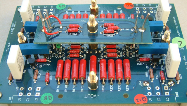

Here is a photo of my board.
I was thinking to use brass standoff's everywhere and connect via solder lugs.
The red wires on the input board are temporarily grounding the inputs. The mute board will go on the 3 (+1 not yet in) wires sticking up on the RH side of the input board. I guess that if I mount this I will not anymore need to ground inputs while biasing
The trim pots are sitting in IC sockets for easy and non-destructive removal later on.
Note that the input board is very effectively blocking easy access to the JFET's so next time I will check front end bias before I mount this board. Not that I think anything is amiss
