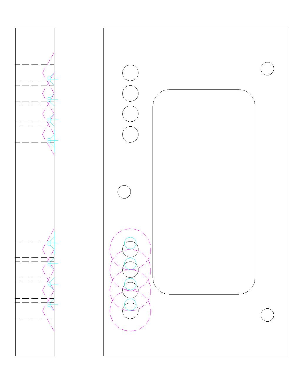

I did some drafting. A 10mm, 120 degree drill, may be barely to do the job if you cut the solder very short.
Of course 90 degree CSK tool is better. Or you can grind the 10mm drill to 90 degrees if your have a grinder.
Caution! It's dangerous to hand drill a 10mm on a plastic. You need very slow spindle speed and steady hand. Otherwise, you may drill through the whole nylon easily.
Mark

I just used a craft knife to check how easily the Delrin cuts, by hand.
It was very easy to cut a chamfer around the one side that requires the clearance for the soldered tags sticking through the PCB.
Each of the 8 delrin holes were "moved" towards each other. I started with a 1.5mm wide chamfer, not quite enough. Then added a second cut increasing the chamfer to 2mm wide. Now the gaps are sufficient to allow the PCB to tight fit against the PCB.
But I found the 3 mounting holes did not quite line up.
this required the hand cut, one sided, chamfers to be extended to cut on the side of the holes towards the middle of the delrin.
Now the holes all line up and the PCB lies flat.
BTW,
I started with the PCB that had the smallest protusion on the solder side. This needed only that first stage of 1.5mm chamfer for the tight fit.
When I tried the PCB with what by my standards are enormous soldered pads then I found the extra cuts to 2mm and towards the middle were required.
It would appear that the way you solder will determine how much of the delrin needs to be removed.
I can confirm that the delrin cuts easily with a sharp craft knife. Mine is about 40years old on it's original blade that I resharpen occasionally with a stone or diamond hone, (not nearly as sharp as a new carpet knife blade).
Another BTW,
a carpet knife blade has a tip that is machined to 45degrees. This shape will make it more difficult.
I used a blade where the tip is cut to ~30degrees.
