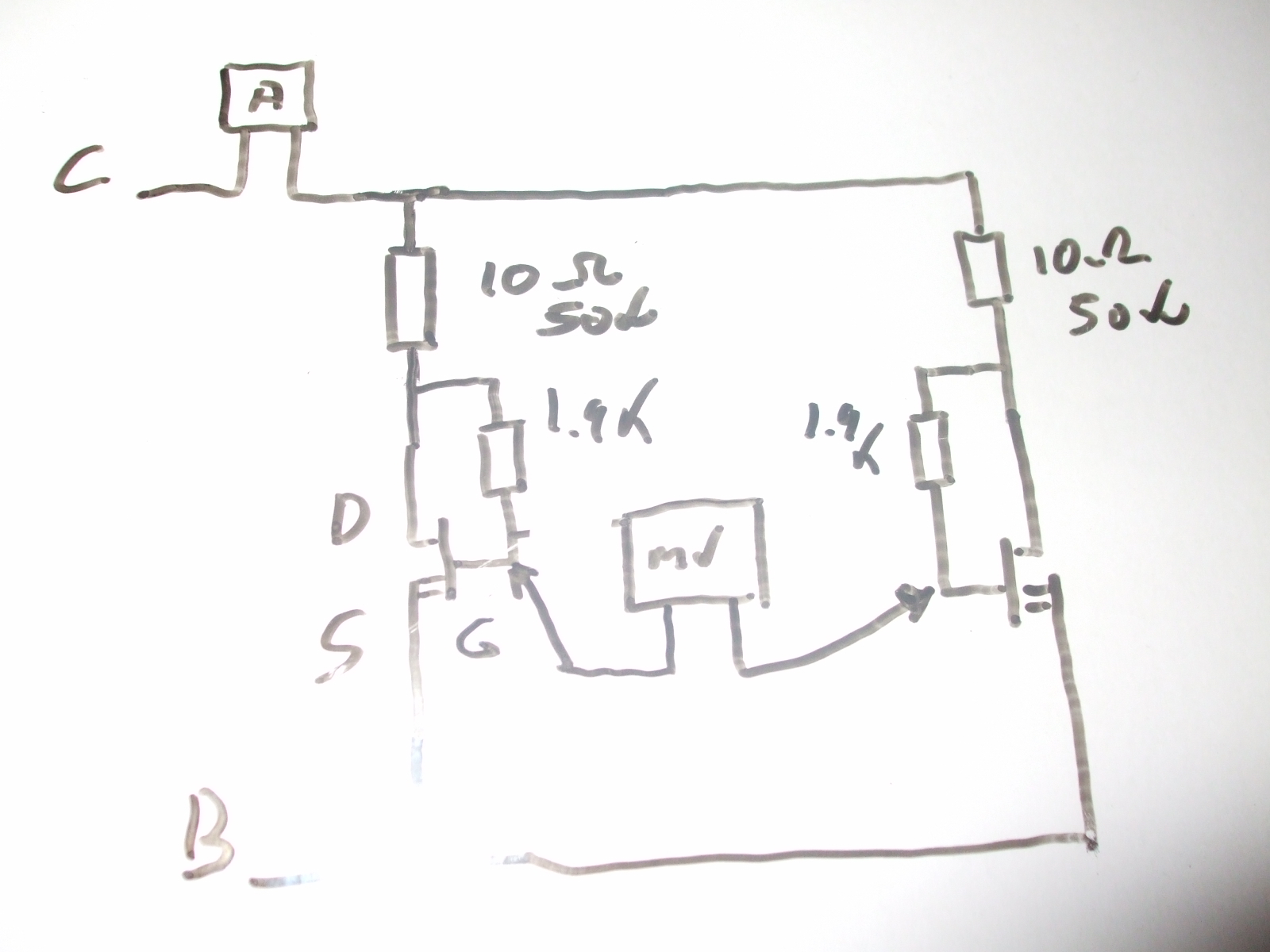

Matching 2SK2013 / 2SJ313 HELP! PLEASEEEE
Can anyone point me to the right direction on how to match those transistors?
I'm not a master electronician but understand pretty fast!
All I have right now is a very good DVM but no oscilloscope (although I have friends that have).
Do I need to build a simple circuit to test them?
Procedure?
I have to be between 2-3%
Again this is really appreciated!
Do
Hi Pinnocchio
I have been doing a bit of work on matching FQA19N20
Papa published a guide
Frag Bridge and its other posts are quite good as well.
Tendency is to say that matching at working parameters is best.
To which I agree but also test at different settings just to reduce the number of dudas I will have to test at working conditions
I suppose you will just need a larger resistor to reduce the current and use same way to keep an eye on it or you get smoke.
May be worth investing on a cheap meter just for this
I am posting a crappy drawing of the Frags Bridge as you see I use a meter for the current (cheap and nasty) and a better one for the voltages
When you get started you will notice that VGS changes with temperature by bolting the 2 mosfets close to each other the change in temperature cancel out.
More in my post
Ps takes what I say with a pinch of salt I am new to the 3-leghed kind. Loads of peoples that place 30 40 post a day may know better and have read all the books.
Hope this get you started
Al

Hi
Not shure about your mosfets as smaller than the FQA I am testing
Is this version of the F5 specified at 0.5A 16 V ?
If so thats the answer you were looking for ?
Would start with 15 V and 20 ohms maybe but don't blame me if you smoke them as I don't have any of those to try for you.
Beter safe than sorry so half the V or duble R and maybe you be ok to start
15 V 10 ohms works vell enough for the FQA as I get 1.1 A but the treshold curent of your mosfet may be lower
Papa paper is a good source of information (and enjoible to read) well wort looking at it does answer loads of questions.
Frags diagrams are quite good Just start with low voltage to the gate and take it easy
