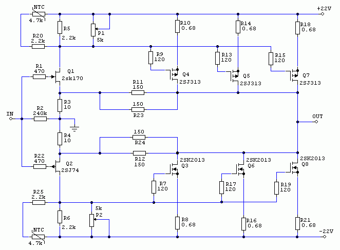

Mr Pass,
Thanks for explaining that - I got it the other way around. So if I am run I g 1.5amp bias in my amp, it can push about 3amps to as much as 4.5amps in class A through the speaker? Well that's good to know. If I am running 25v rails isthe max power about same as regular F5 at 25w? Do you see any issue with me changing the gain to 20dB?
I just installed real 5k NTC's thermally coupled to the MOSFETs. It's tracking the bias much better now. The 5k pot is still very touchy. I will measure the value and get a 500R in its place in series with a resistor to get better resolution of bias setting and control.
Thanks a lot so far! So better not to go below 15 V rails for 8 Ohm speakers in order to get the max out of the one pair of fets. If I went that route, would I have to change any resistor within the first stage?

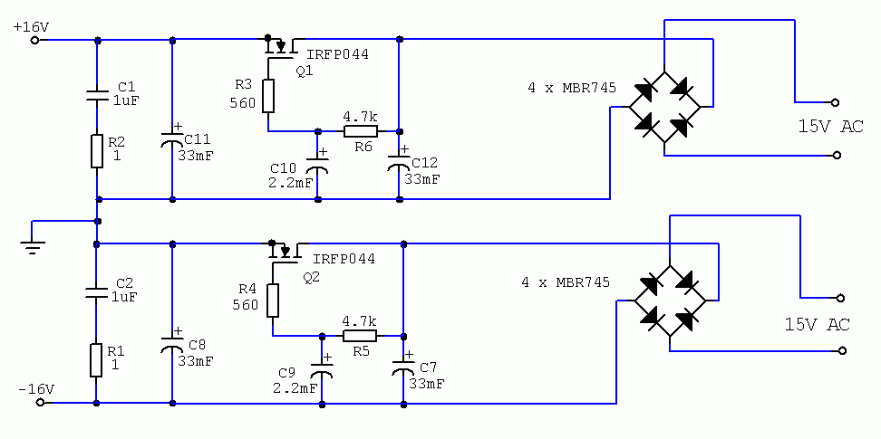

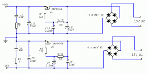

I want to add the regulated PSU that Juma designed:
It's a very simple circult and I am hoping that it helps reduce the hum I am getting from rail ripples under load. Can someone explain to me how this circuit works and where the 20V reference is coming from? If I want to run it at say, 22V what do I need to adjust?
It's a simple C-Multiplier circuit, not a regulator (with an R-C filter on the output cap) - use lower drop out voltage power fets or transistor - output capacitors directly effect the sound of the amp
There's a "mkII" version of Juma's C-Multi that uses 4 NMosfet IRFP044 (and according to the designer, performs better)
If I am running 25v rails is the max power about same as regular F5 at 25w?
1) With a .47 ohm Source resistor, probably about 3.5A pk
2) Yes, 25W
3) 6 dB more gain = twice as much distortion, half the damping factor.

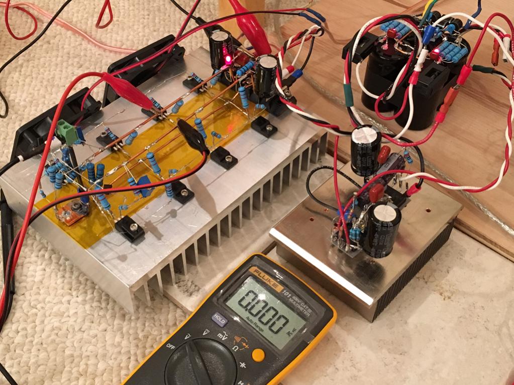

I implemented Juma's capacitance multiplier on a separate heatsink. I have to say that it was simple and I works very well. I am getting 22v rails no load and 19.5v rails under full load with 1.5amps bias current. Ripple measured with AC volts on Fluke is less than 1mV as shown below. Quite an amazing performance from the previous 40mV ripple coming from the CRC filter.
The circuit is so simple, I easily did it with P2P right on top of the IRFP240/9240's.

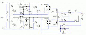

I think the cap multiplier is a real gem - sharing. My experience over on SS forum:
Would that be this one?
Did he happen to say why that would be?
Would be that you now have better matched ripple reduction and rail values
with just N-channel parts since the N and P parts have different Vgs and
transconductance?
transconductance?
That is a good argument for the topology, but doesn't give insights as to
why the IRFP044 would be the transistor of choice.
