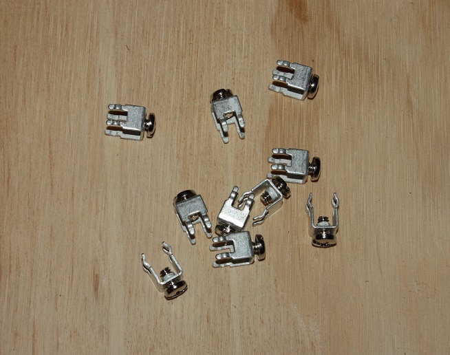

very practical in testing phase when you need to move and change things.
For your next Bürklin order :
Riacon single-wire screw terminals, 16A.
09H5920 (9x9mm) or 09H594 (5x5mm)
Section H of the paper catalogue, page ~930
(what a pretty avatar you have)

6.3mm spades are long-time reliable connectors. I do use them in my amp builds since more than 30 years without any failure.
There must be good reason, why they are applied in extremely demanding automotive applications, for example.

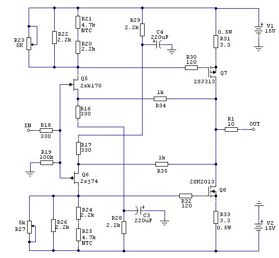

Single K2013 & J313 output pair
Anybody tried a single pair without source degeneration resistor nor the ntc at 600mA zero tempco point and dual 12V? Sounds ok, bad or fire maker? Plan to use on TL FE206.

I've used these Keystone connectors for years. They make a wide variety,
up to 30A rating. It makes a very solid connection right to the pcb.

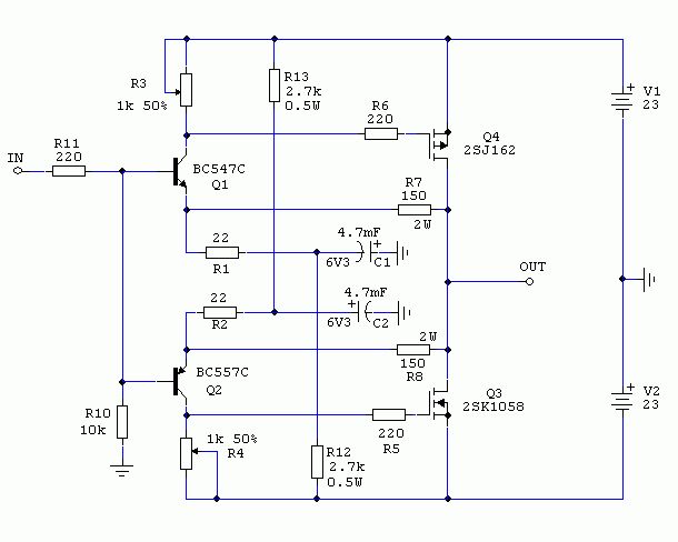

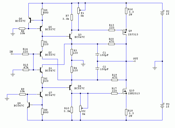

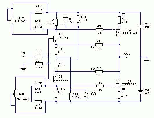

I attached 3 of Yours schematics. I want to build headphone amp based on 2SJ313/2SK2013 @ 200mA +-15V based on schematics 3. Because of unobtanium JFETs, it will be very nice if I can use BJT front end, just like on schematics 1 and 2, but that schematics are for different output devices.
So schematics is topologically identical as schematics 3, only Q5, Q6 are BC550/560 , and wanted bias current of output FETS (2SJ313/2SK2013) is 200 mA.
Doable?
Many thanks in advance.

Sure, see attachment....Doable? ...
This way we avoid JFETs and big caps in the feedback loop.
Q5-8 form CCSs (about 1mA) that supply the input buffer (Q1,2) which polarizes Q3,4 (about 3mA).
Output stage doesn't need thermal compensation (due to relatively high value of R16,18). Just take care to provide enough heatsinking for the output MOSFETs (each dissipates about 15V x 0.2A = 3W ) so that temperature on them doesn't rise to more than 15-20 degrees Cels. above ambient.
You can use bc550c/560c or similar on all positions.
Bias setting procedure (P1,2) is the same as for F5 - set the voltage drop over R16,18 to 660mV for Id=0.2A.
The value of freq. compensation caps (C1,2) can be adjusted for best square wave response and stability. Power rail bypass caps (100-1000 uF) can be added if they don't influence stability (that will depend on your build, PSU and the parts used).

Hi Juma, to further expand the number of (good) headamp schematics that are coming out in those days, what about a Cubie2 with 2SJ313/2SK2013@100.mA?
Guido
Guido
It will work great too - just take care about higher Vgs needed for k2013/j313 and don't forget to add source resistors for them (3R3-4R7) to provide sufficient thermal stability....what about a Cubie2 with 2SJ313/2SK2013@100.mA?...
