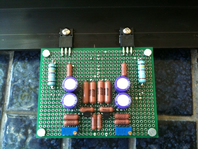

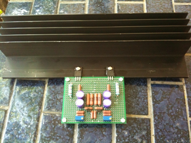

Looking good prakit
You should be fine with that heatsink, just use white heat-transfer paste more liberaly 😉

To follow up my attempt to try this a line amp...
I supplied each channel with a set Jung's super regulator set at +/-23V as seem the attached picture. I've been listening to the line amp for a week now. This version of F5 with a pair of k2013/j313 indeed makes a very good lineamp.
I tried varying the bias of the output Mosfets up to 450mA where the regulators seemed running out of steam(the heatsink for the pass devices became very hot). It did sound better at higher bias but the dc drift at the output was getting bigger too. I settled at 250mA where it sounded good and the dc stability was good too.
This circuit should make a very good sounding headphone amp too.
Anything I can do to minimize the dc drift at higher bias?
Regards
Regards
Regards
Of course, the most simple, but very effective thing to do is to add NTC resistors (like in F5). They are changing their resistance with temperature thus keeping the current through MOSFETs and DC offset constant.
