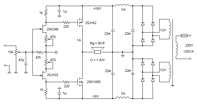

It's a transconductance amp, like BA-3. Its gain is determined as G=1A/V and the voltage on the speaker will largely depend on its impedance, so voltage gain cannot be declared as high or low since it depends on the speaker.found one schema of a sort of it but with even less gain and no feedback:
Absence of feedback makes it what it is. Insert a feedback loop and you'll get pretty standard amp.

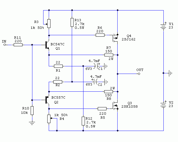

As it usually happens, looking for something else, today I found my F5 version with Lateral MOSFETs that I mentioned in post #4.
Laterals here need no source resistors and no thermal compensation.
3.5mA runs through the each of the input BJTs - BC550C/560C work here great too (matching is beneficial but not mandatory).
Biasing procedure is the same as for the standard version - the only thing different is that you can bias LATFETs somewhat lower (1A is OK) since the absence of source resistors and the specific curvature of MOSFETs' transfer characteristic enables much later (in terms of load current) switching to AB class regime.
Oh, and 4.7mF means 4700uF.

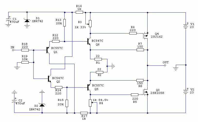

Hi fab,
that won't work very good (power rail connected to BJT's base) unless you break each R67/R66 into two 10k resistors and connect the big cap (say 220uF) from their center point to ground. Stiff power rails are a must and a big input cap too (I think that 22uF input cap does a lot more damage than the feedback loop caps). You might want to rework that scheme with some diodes around bases in order to polarize input BJTs but input cap would still be needed.
If you want to lose feedback and input caps much better idea would be the one that Hiraga used in hs 20W cl. A amp (see attachment). But that one introduces one more pair of BJTs at the input as an emitter follower stage. I tried that one too but the sch. from post #10 still sounds better to me.

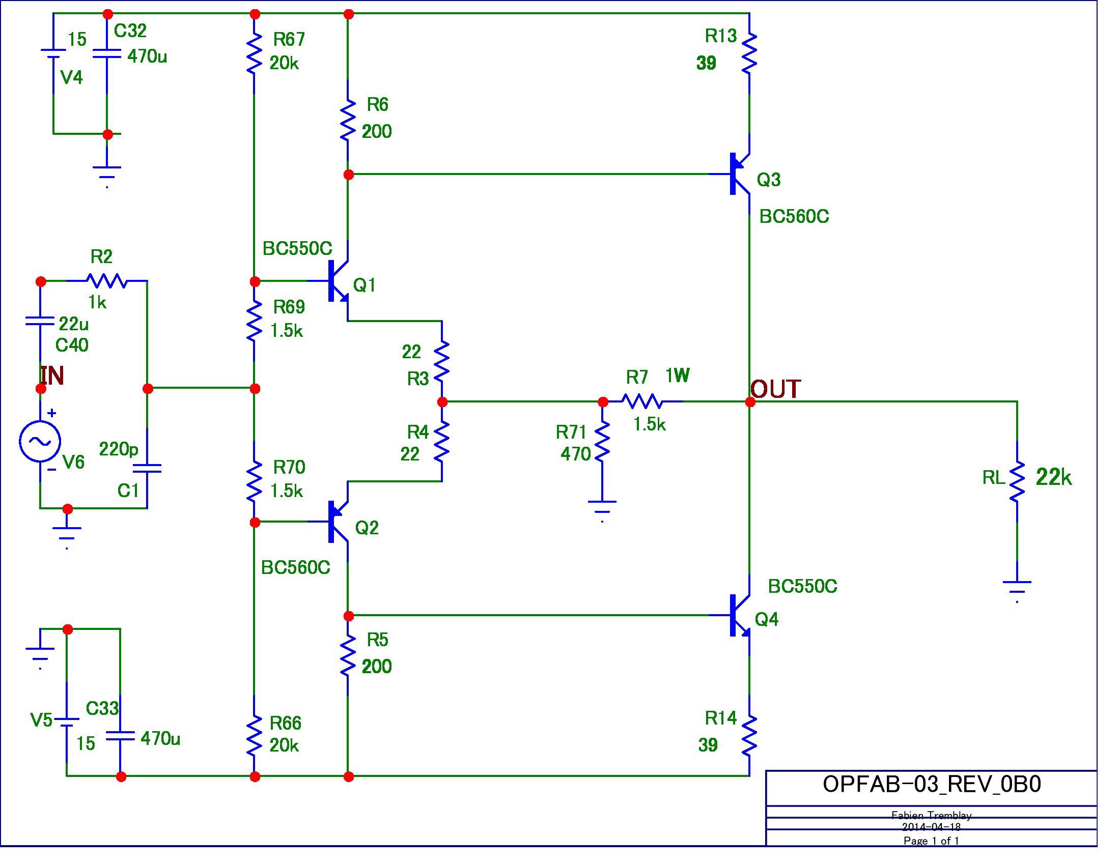

Hi Juma
Nice adaptation of the Hiraga input stage!
I am already aware of the Hiraga design. I have built 2 version and also the NX amp from Bonsai. Like you I prefer to limit the number of stages.
Thanks for the idea to filter input from rail (most important for a power amp) . R66/R67 could also be replaced by simple current diodes too. There should not be significant DC at input since it is at middle point of both supplies. The polarization is done with the, 2 resistors (R69/70) at base of BJT so no problem there...
I prefer the input cap anyway to protect the amp -then the speakers- from source or preamp possible DC ( failures) presence. So For that reason I think this circuit eliminates 2 feedback caps ( in reality 4 because of the bypass with 10uf too) and does not add an input cap....- at least this is my point of view.

Hi Indra1,
it works theoretically but it will inject all the ripple from the power rails into the input BJTs' emitters (which are very low Z, and they are inside the feedback loop) and you'll have enormous hum at the output.
So if you want to pursue that idea you'll have to come up with perfectly clean power rails.
One possibility is to break your R9/R10 into two smaller resistor each an put the very big cap from their center point to GND but that brings us to worse solution than the one we started with...

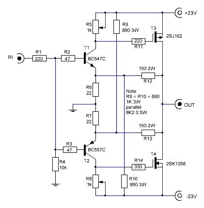

Shunt reg for the front end won't work here because you can not disrupt the Vgs circuit of the MOSFETs.
It might be a better idea to use two CCSs (38-40mA) instead of R9/R10 since CCS has a large dynamic impedance and will dramatically improve PSRR.
Each CCS will dissipate almost 1W so LM317 used as a CCS comes to my mind - see Walt Jung's article about them.
