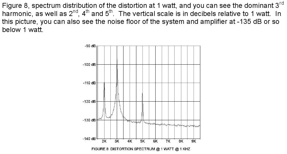

Well, R4 might be just a typo but the spectrum analysis is a screenshot from an actual
measurement with an AP, I believe. If it shows no 4th than there is none. I just wonder how and why this is the case.

I know, and as I found out this afternoon it's actually being mentioned in the 4th reply to the "F5 power amplifier" thread. I just thought I'd chime in. Sorry.
