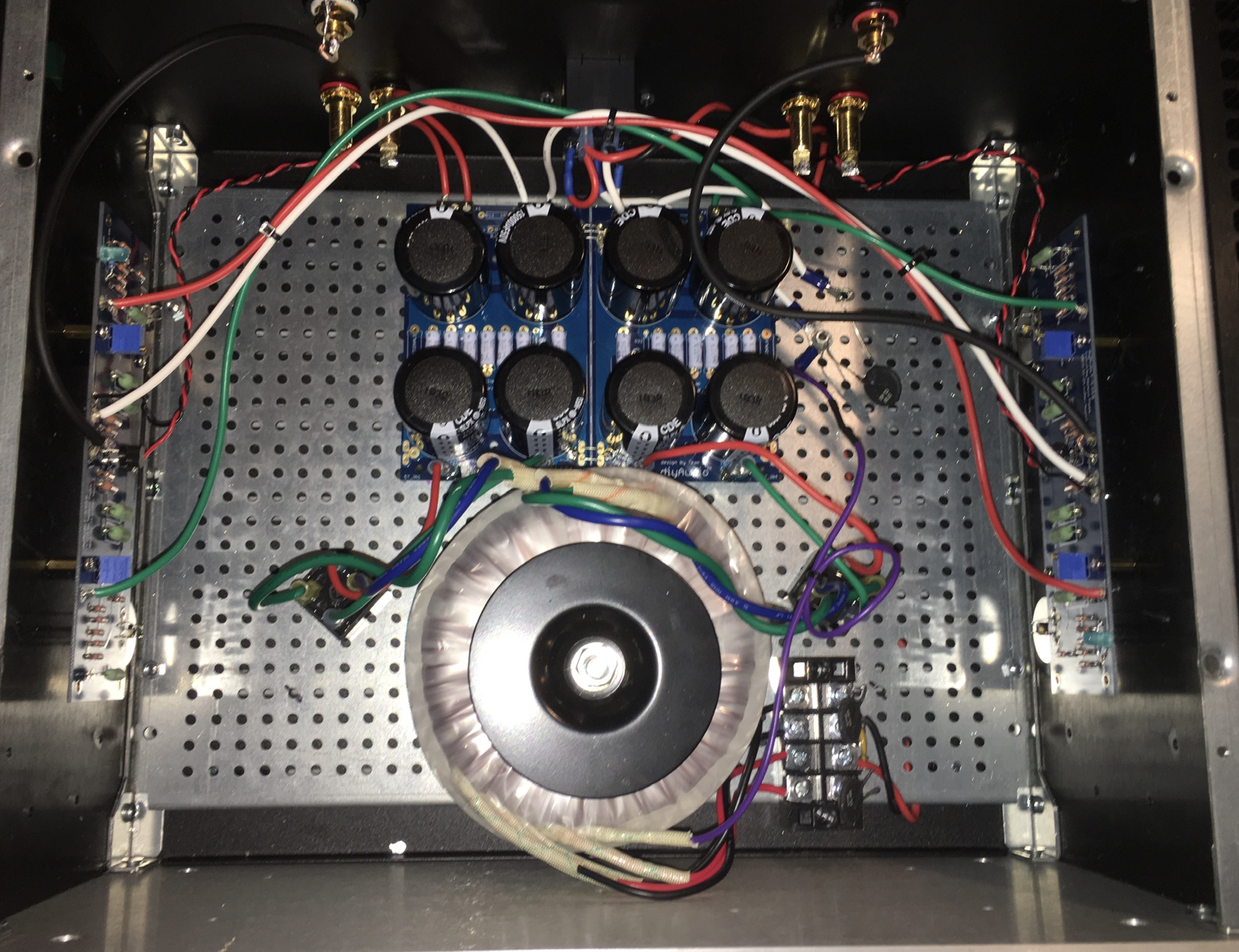

Amazing! This was a great holiday discovery. I've been using the F5 with a 97dB midrange. While I was able to get the hum down to what I considered good levels, there was still residual 120hz.
Cutting the jumpers at the bridge inputs just knocked the perceived hum down by at least 3dB or more.

Where exactly have you cut? Not sure I understand...!

I see in the pictures of your completed amp on the power supply board you have the points labeled gnd,gnd1,gnd2,gnd3,gnd4,gnd5 jumpered together which is correct.That point should go to your amp boards as well as thru a CL60 then to the 120Volt power ground.Then on the diode bridge end of the boards you have those same points (D-1 and D+2) jumpered together again so you have created a loop,remove that jumper,you only need the gnd,gnd1 etc. point jumpered together.
I've done as described here. In your original image you have a jumper right above the board marked ST_IN2/3 on the rectifier bridge side. I did too, as do a lot of others from pictures of the power supply.
Eureka!
I think I've found the source of the problem:
My system is a 2x3 channel Sitronik DSP feeding 3 stereo amps - 2 Pass F5s and one Thel Accusound. To facilitate cable routing I've had the left Pass fire mid-range and tweeter in the left speaker and the right Pass the mid-range and tweeter in the right speaker. well, this setup appears to cause a ground loop between the DSP and Pass! I hooked up one Pass to the tweeters and one to the mid-ranges and the hum is now gone! I've ordered some longer speaker and hope the hum remains absent!

Hi again,
I'm going to try star-grounding the amp in the following way (unless you guys tell me otherwise):
Star Ground point will be a post isolated from the housing using a CL-60 thermistor. This post attached to:
1. PSU board ground
2. F5 board grounds
3. Speaker negative posts
4. Input terminal grounds.
All using equal length wire.
The inputs signal tabs will be connected to the boards with coax wire, with the shield only attached at the board end.
Will that work in theory?
