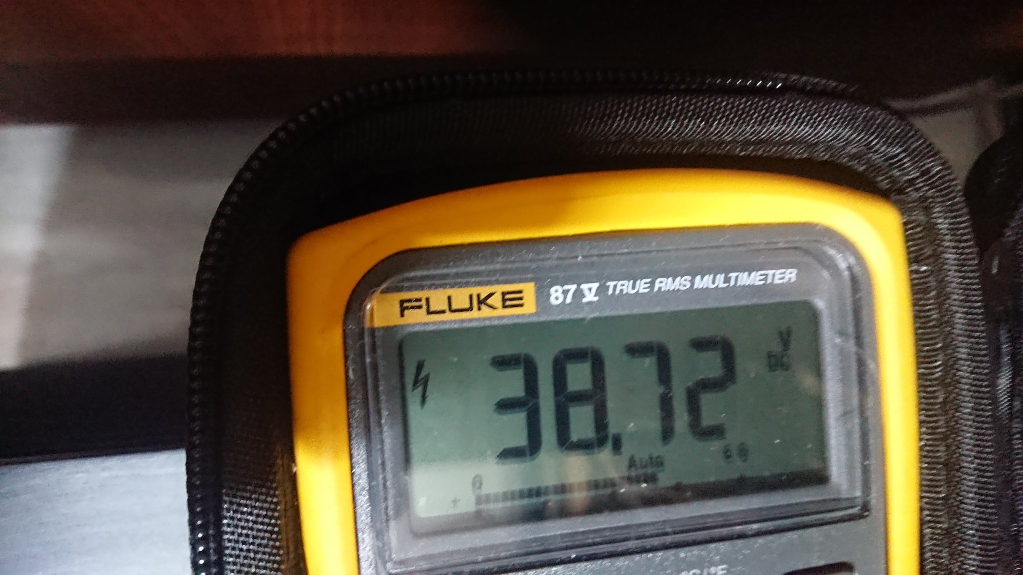

I built an F5Turbo running at 39V rails(with load) some time back and recently started listening test. I also have Aleph2 with 56V rails.

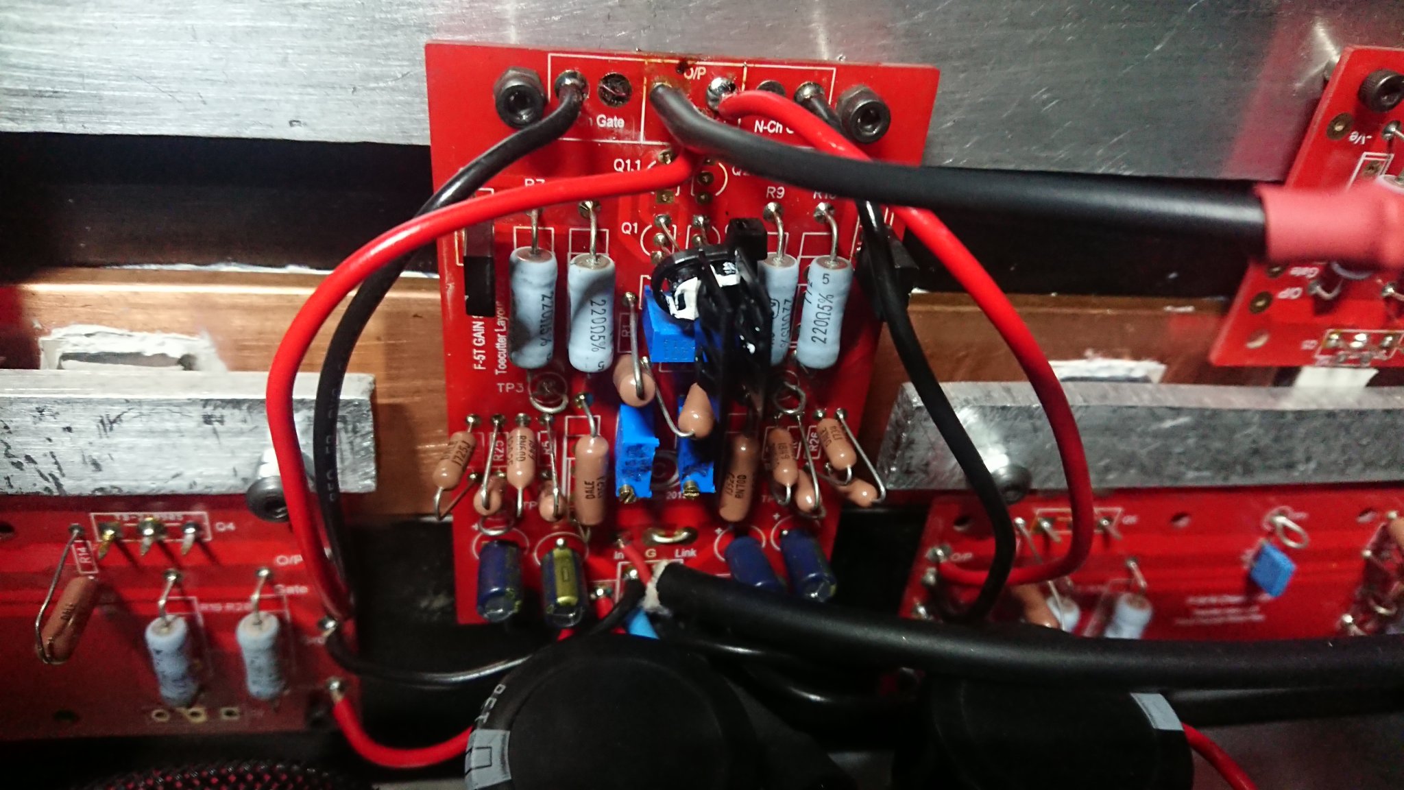

Currently I am using one pair of JFET and cascode transistor and no diodes in O/P boards.

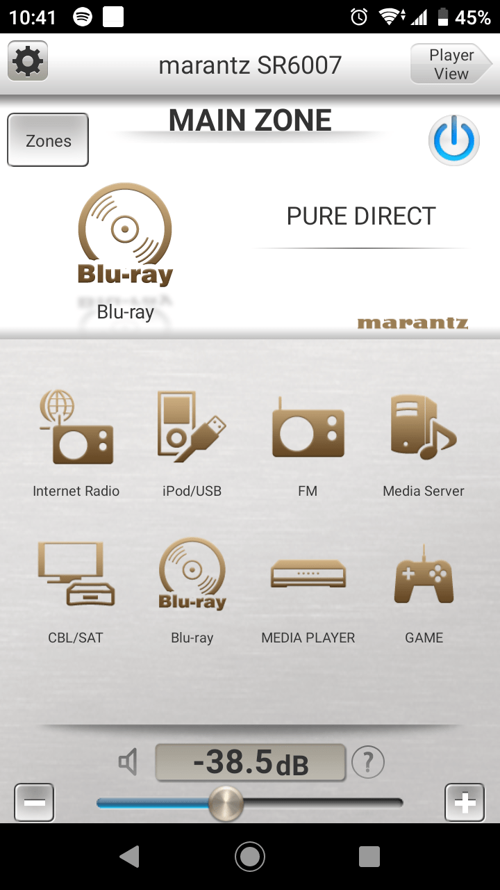

Observation:
With Setup1 I do not hear anything when the volume slider is midway, only when I slide past centre I begin to hear music. The sound is clean.
With Setup2 I hear music when volume slider is midway. I believe it has to do with gain of each amplifier.
F5T is bit louder than Aleph2.

1. If I use 2 pair of JFET, can I increase the rail voltage between 50-56 VDC without any other changes to circuit(Caps are rated 75VDC)?
2. Currently with rail voltage 39VDC, the P-Channel bias 0.356V and N-Channel bias 0.327V, does increasing bias beyond this has any advantage? if yes what value should I bias them to for 53VDC rails(what is the upper limit without compromising sound quality).
3. Will above two steps help in what I am trying to achieve.
4. If I still need more gain, with below approach what resistor value should I use without any impact to circuit functionality or sound quality. What I mean is I do not want to make more changes since I do not understand the functioning.
Someone's post : "Using the search function showed some comments on using 380R resistors in parallel for R7 - R10 increasing the gain to 26db instead of the 22db.I was aiming for +6dB over the V2 turbo (21.6dB) could I use 500R resistors in parallel or is that too much decreasing the feedback ?"

Increasing rail gives higher max output voltage swing for greater max power. Higher bias current gives higher class A power into lower impedances. Additionally, increase bias tend to lower distortion. Note either of these changes increase dissipation. Heatsinking and dissipation/temp for the output mosfets are usually the limiting factors here.
Increasing rail gives higher max output voltage swing for greater max power. - So that there is no clipping.
Higher bias current gives higher class A power into lower impedances. Additionally, increase bias tend to lower distortion. - Understood
Can you please help with calculation. With 39VDC rails biased to say 0.4V , how loud can I go?
At what AC volt measured at speaker terminals, will the amp leave class A and when will amp clip. How many watts of classA.
