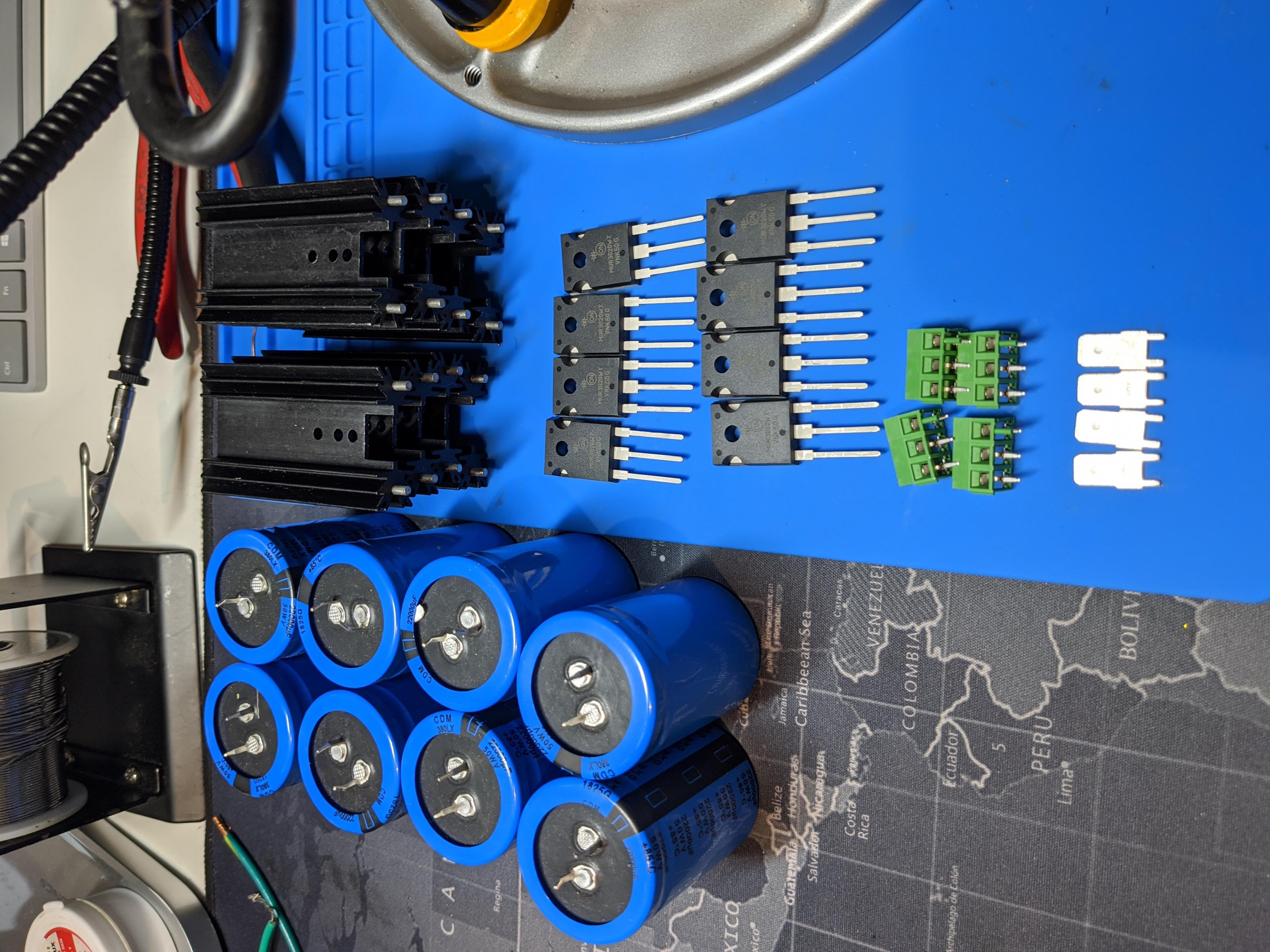

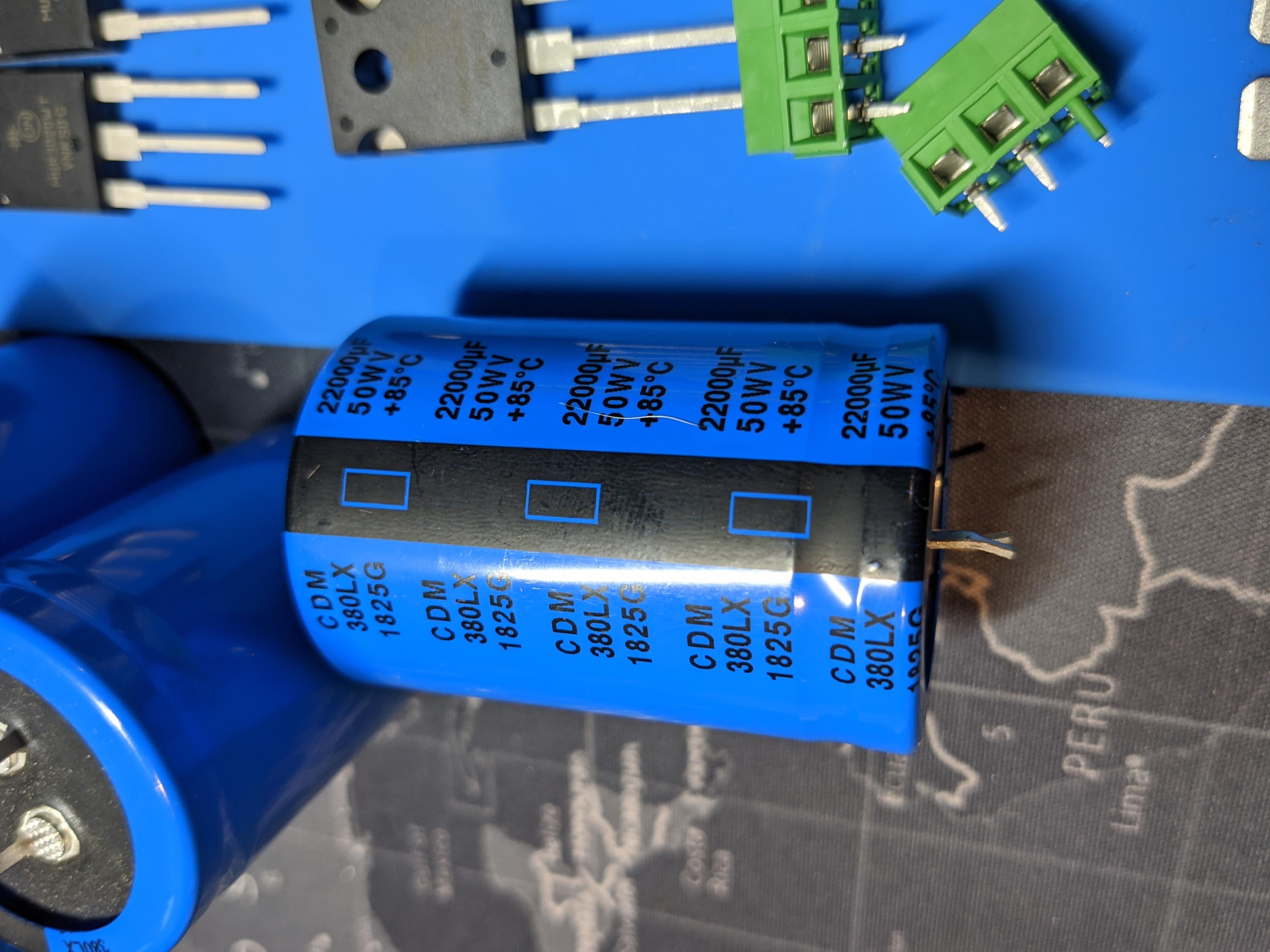

Components
Another massive research project. This is worth doing to understand the different types of resistors (metal film, metal oxide, carbon ....) and capacitors. If you look in the BOM for the F5Turbo it has the part numbers so just get them.
1. I bought the vishay-dale metal film resistors for the amplification. After all the research I am still not sure how each of the parts affects the signal except for the transistors. But I spoke to 6L6 and he informed me (correct me if I am wrong here 6L6 if you read this) that the resistors and capacitors in the F5Turbo are not the most significant component and that I didn't need audiophile resistors that cost an arm and a leg.
2. I bought the matched JFETS from the diyaudio store way back when - the B-grade ones.
3. Thanks to some members here I got some matched FQA12P20 and FQA19N20 (I need to double check that)
4. But essentially, for the F5 Turbo v2, get the active parts from there now that they have them.
5. Get the pre-drilled chassis from the store. So much easier.
6. The back parts I got these from PartsExpress (the store was sold out) and they fit the back panel perfectly (dont forget the Shurter power entry module (see BOM) and 2 x 2.5A slow blow fuse):
- 1 x Neutrik NF2D-B-2 RCA Jack D-Series Red/Black (Part # 092-232)
- 1 x Neutrik NF2D-B-9 RCA Jack D-Series White/Black (Part # 092-239)
2 x Dayton Audio BPFI-G Fully Insulated Binding Post Banana Jack Pair Gold (Part # 091-630)
ok now on to the build...

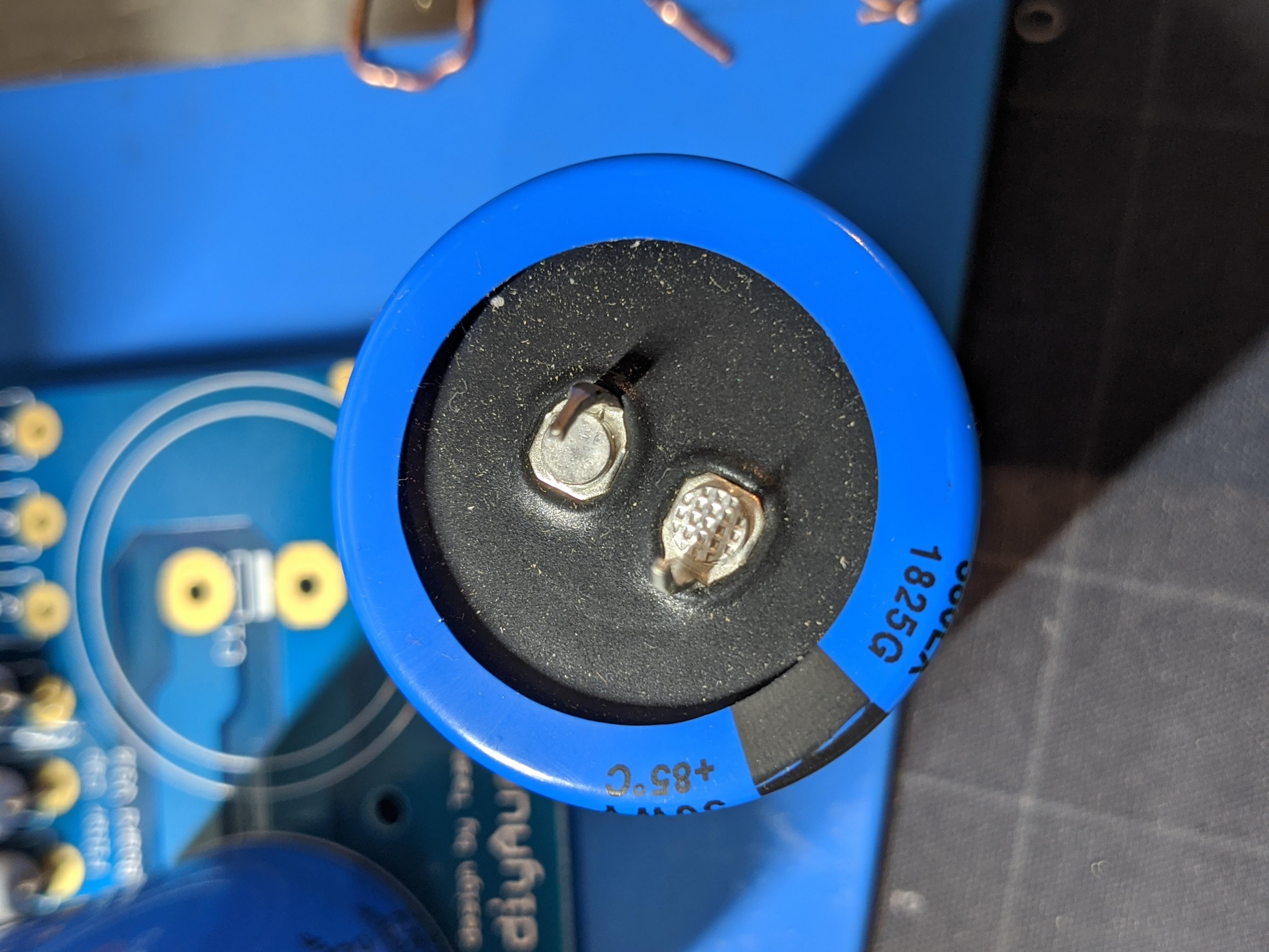

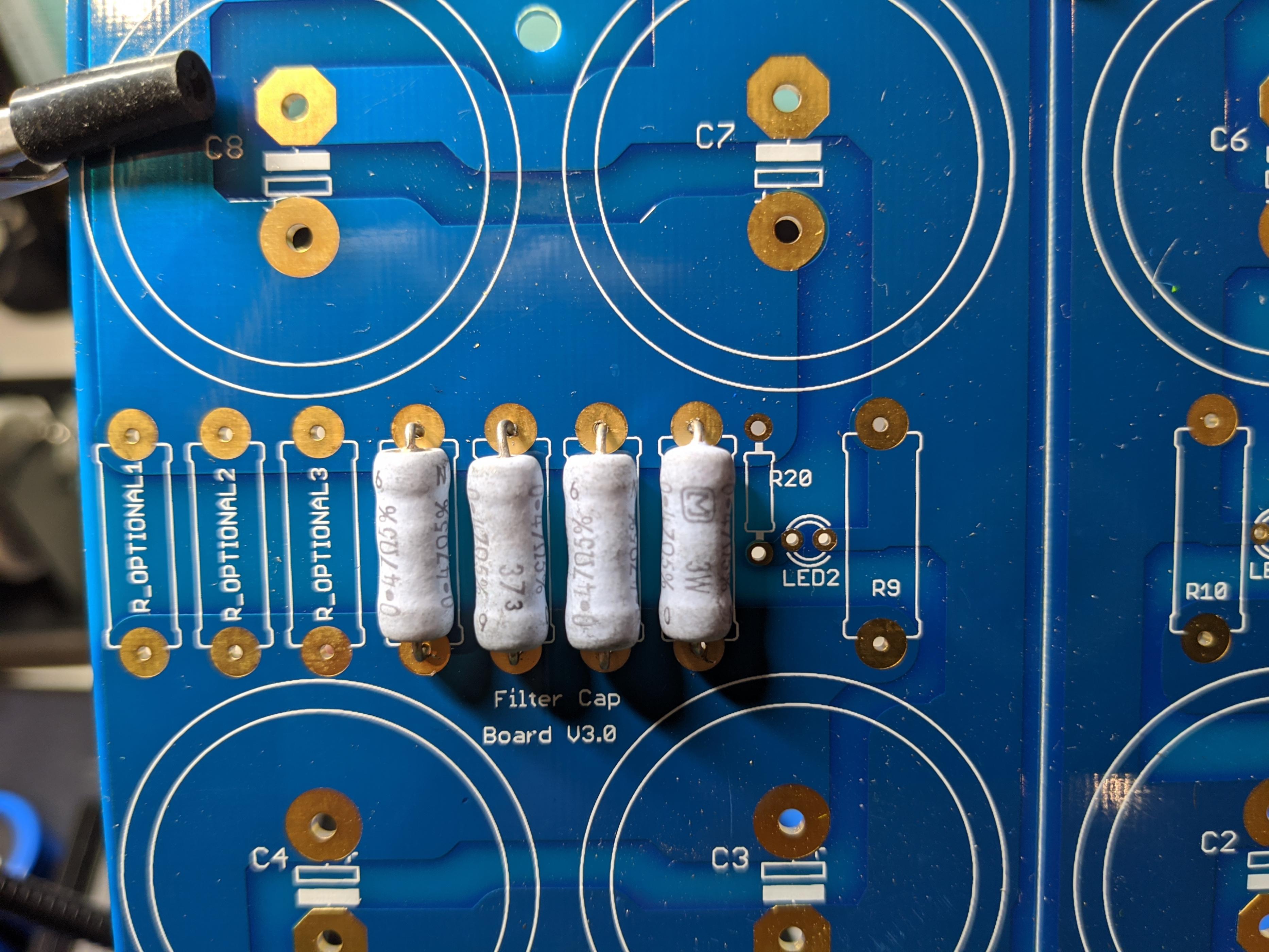

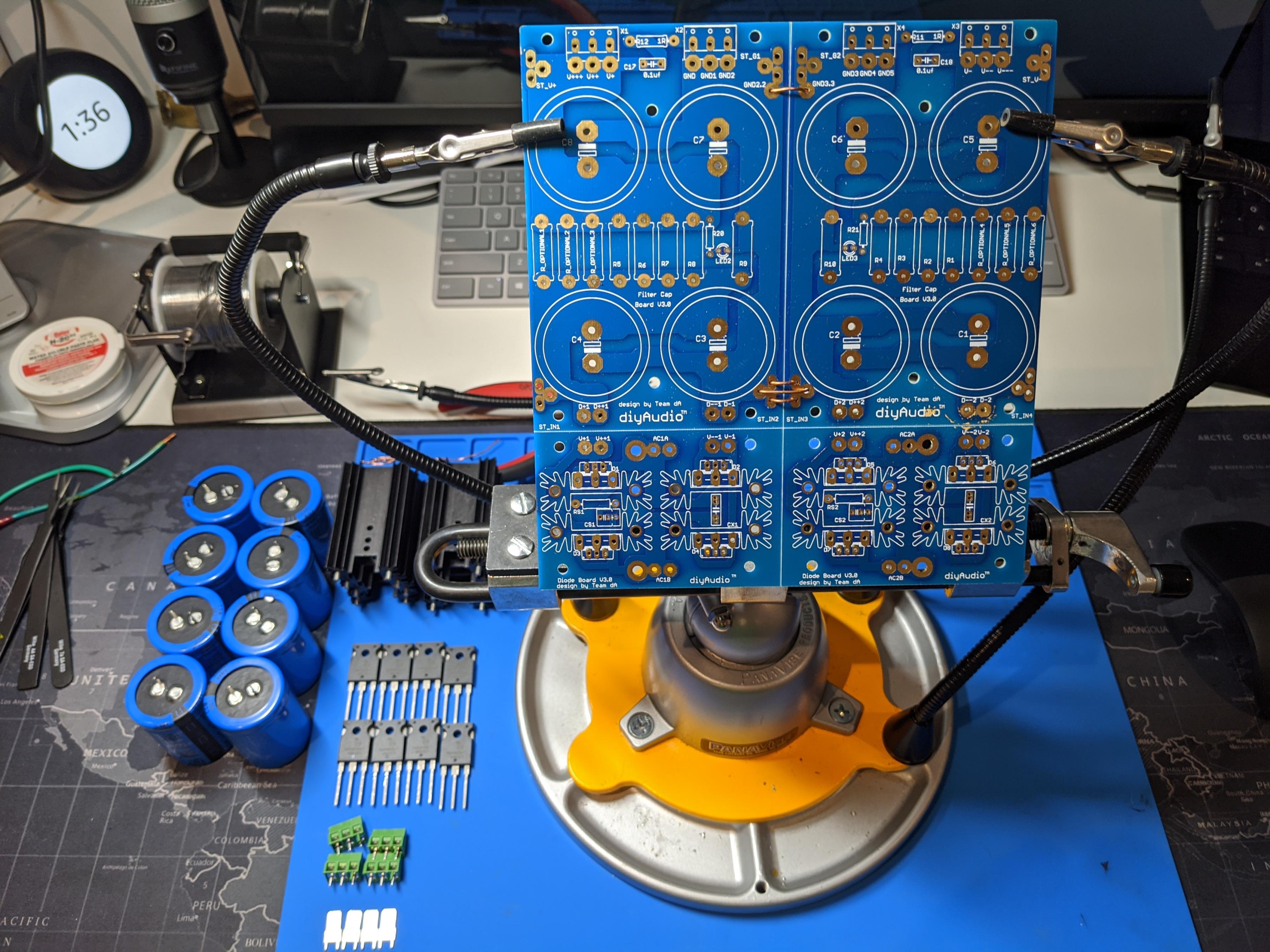

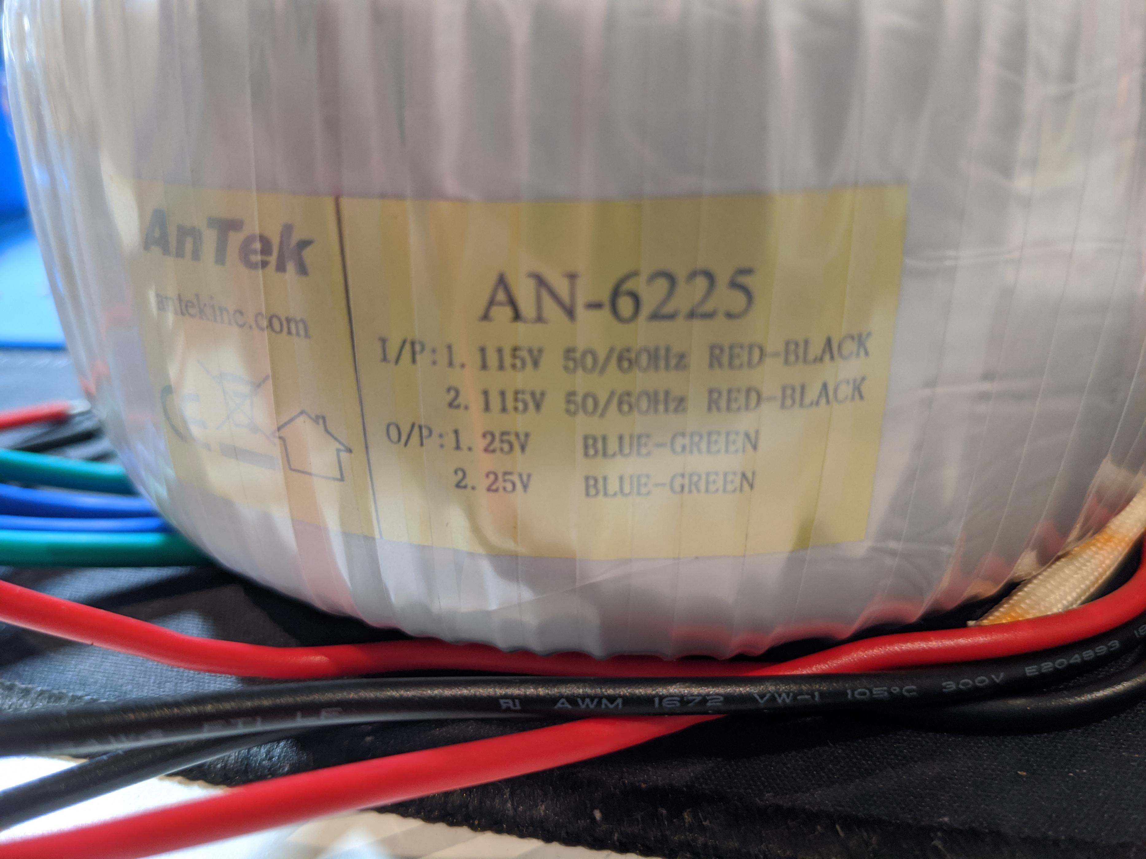

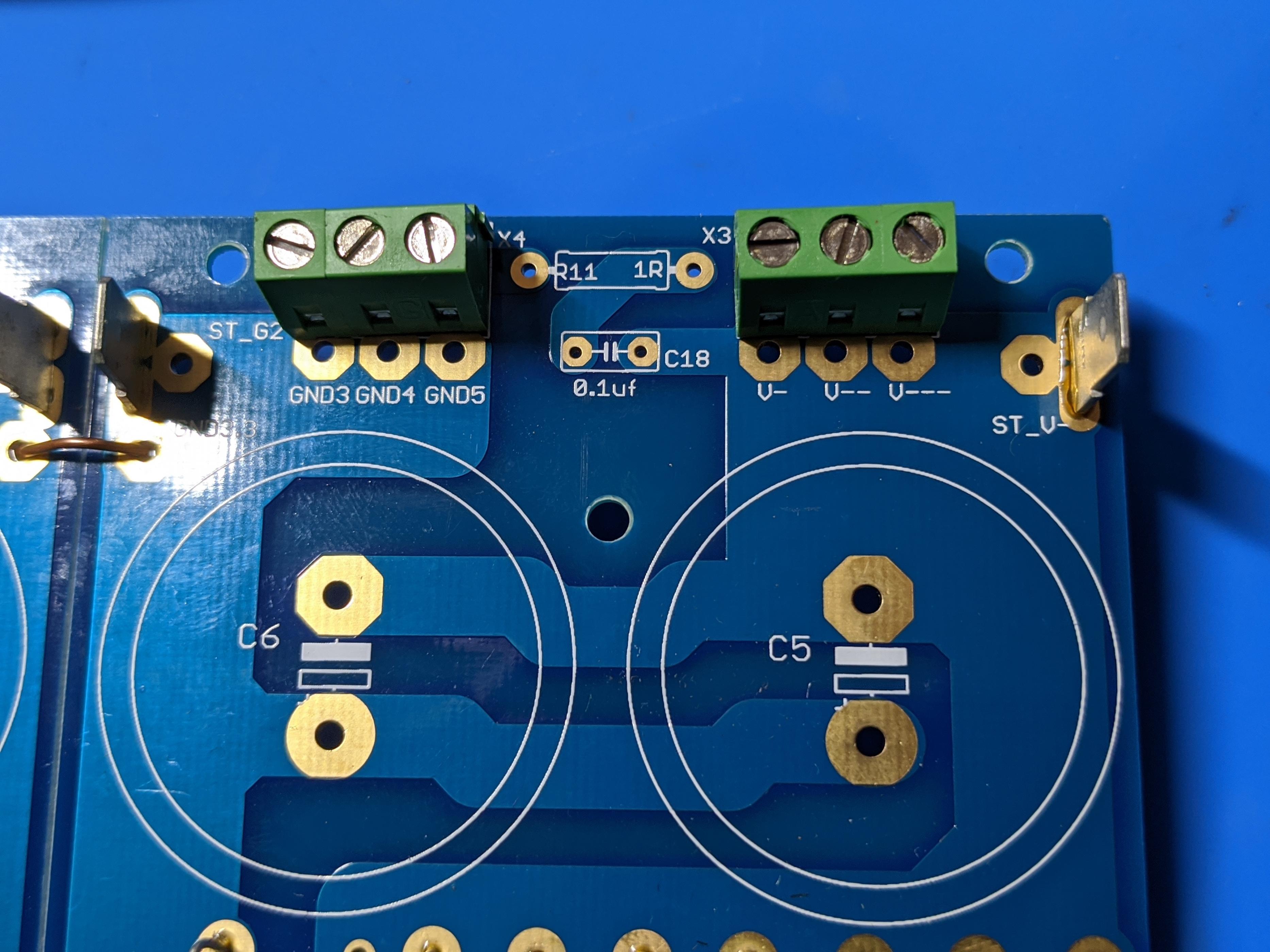

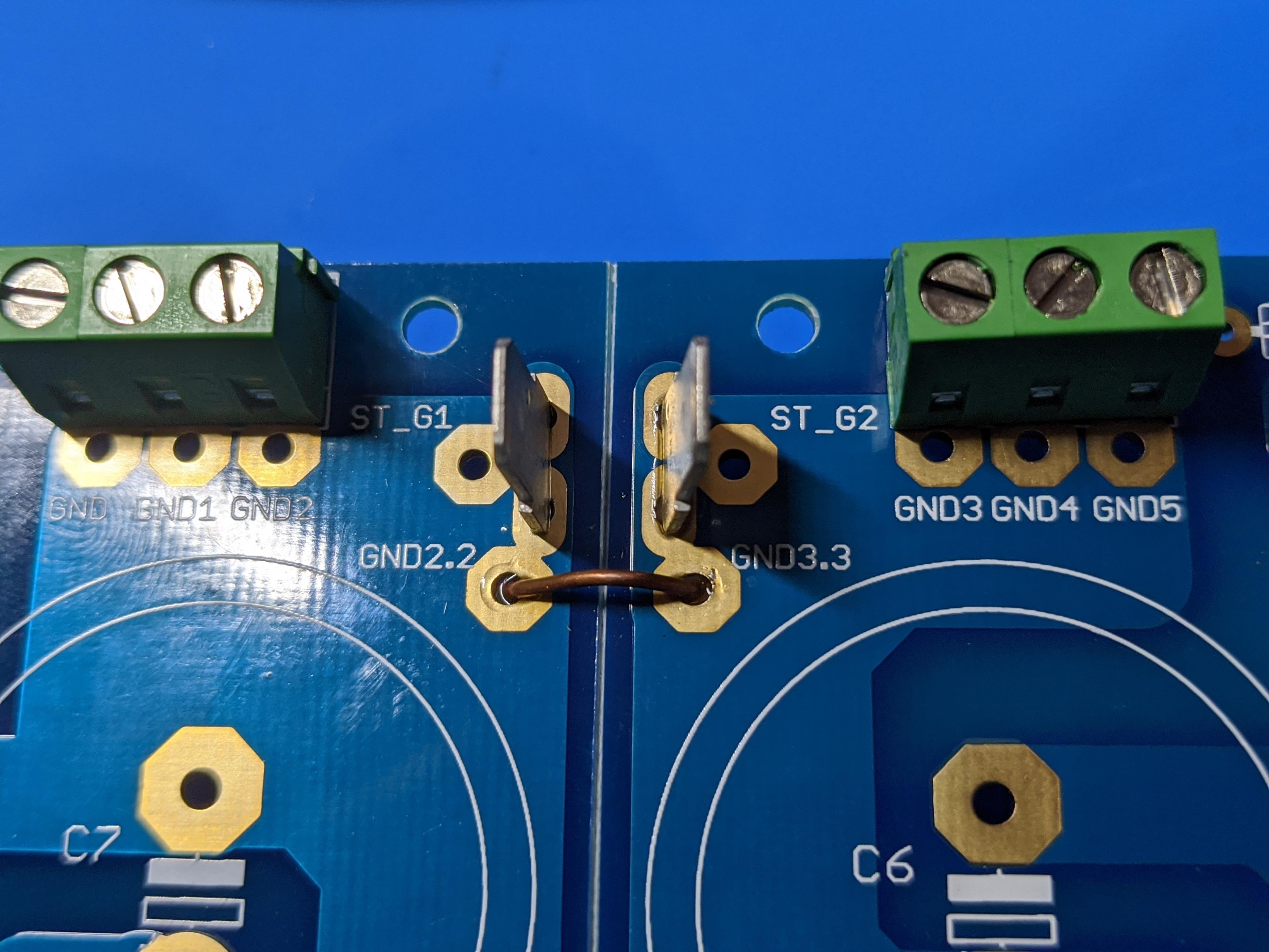

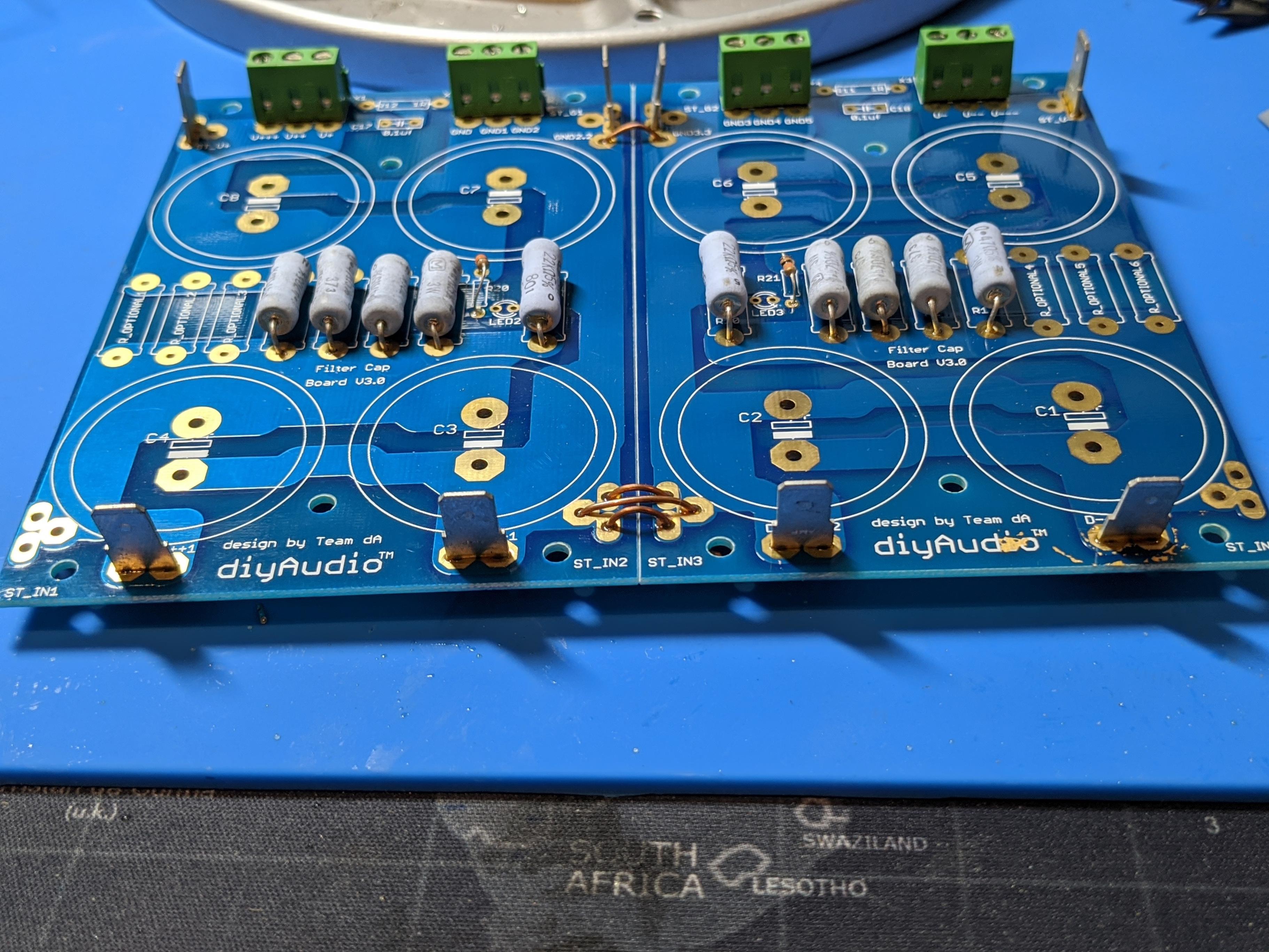

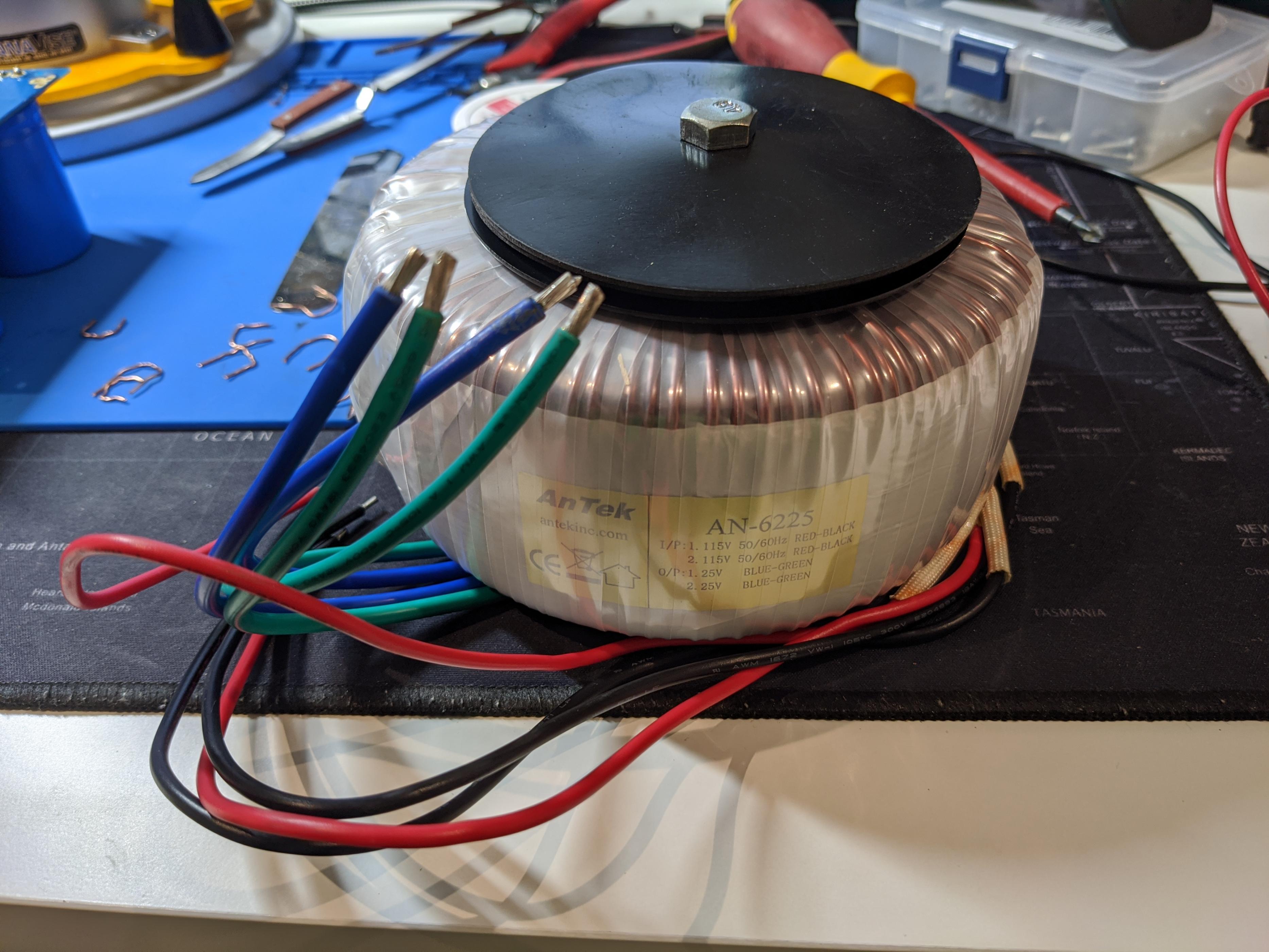

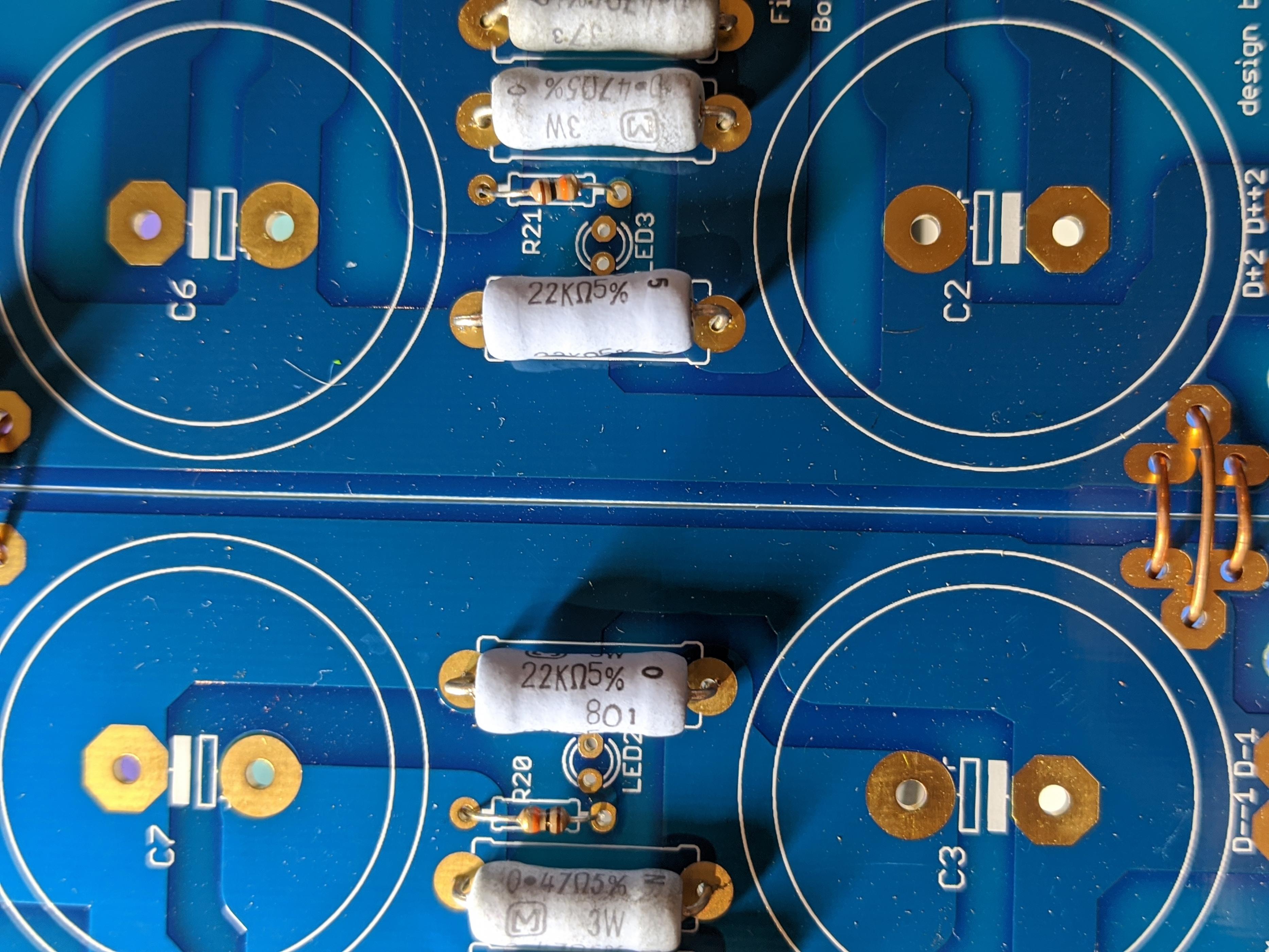

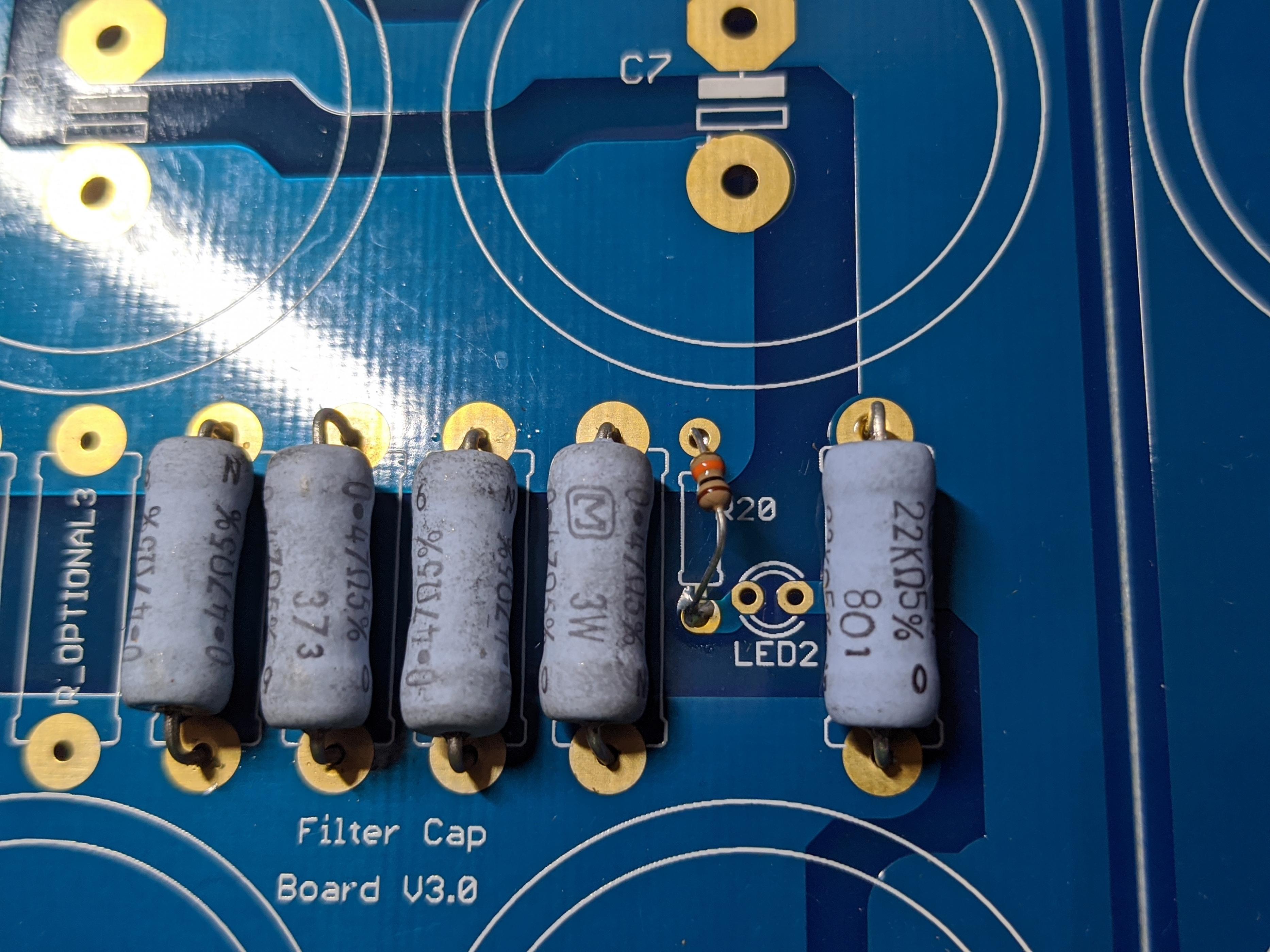

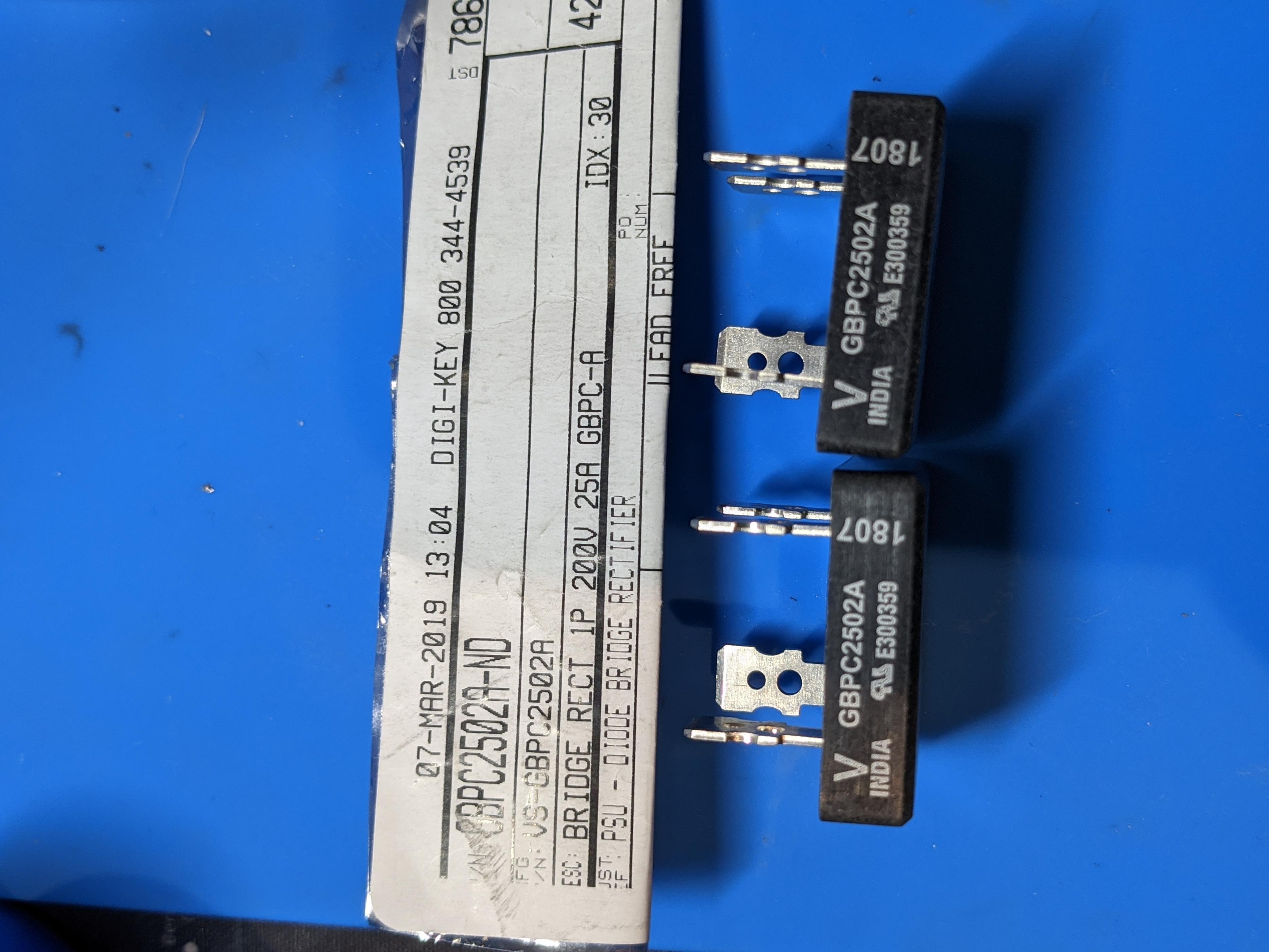

Here are some more PSU pictures.
I used the Rectifier bridges, no the individual diodes shown in the first pictures
more PSU.

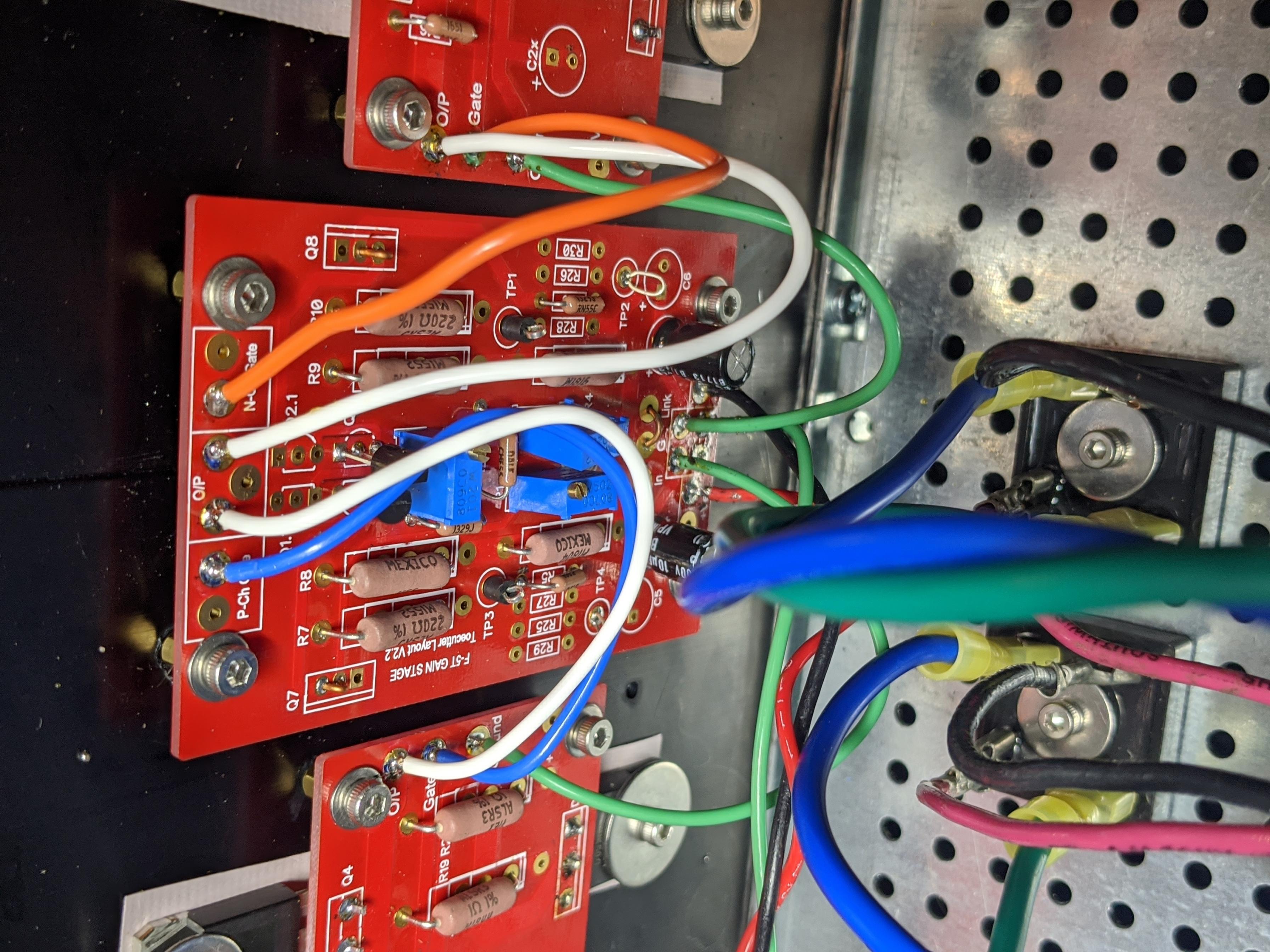

I have more PSU pics but uploading them is such a punish I'll just skip to the amplifier stage. I have just finished soldering the connections for everything except the input and output signals.

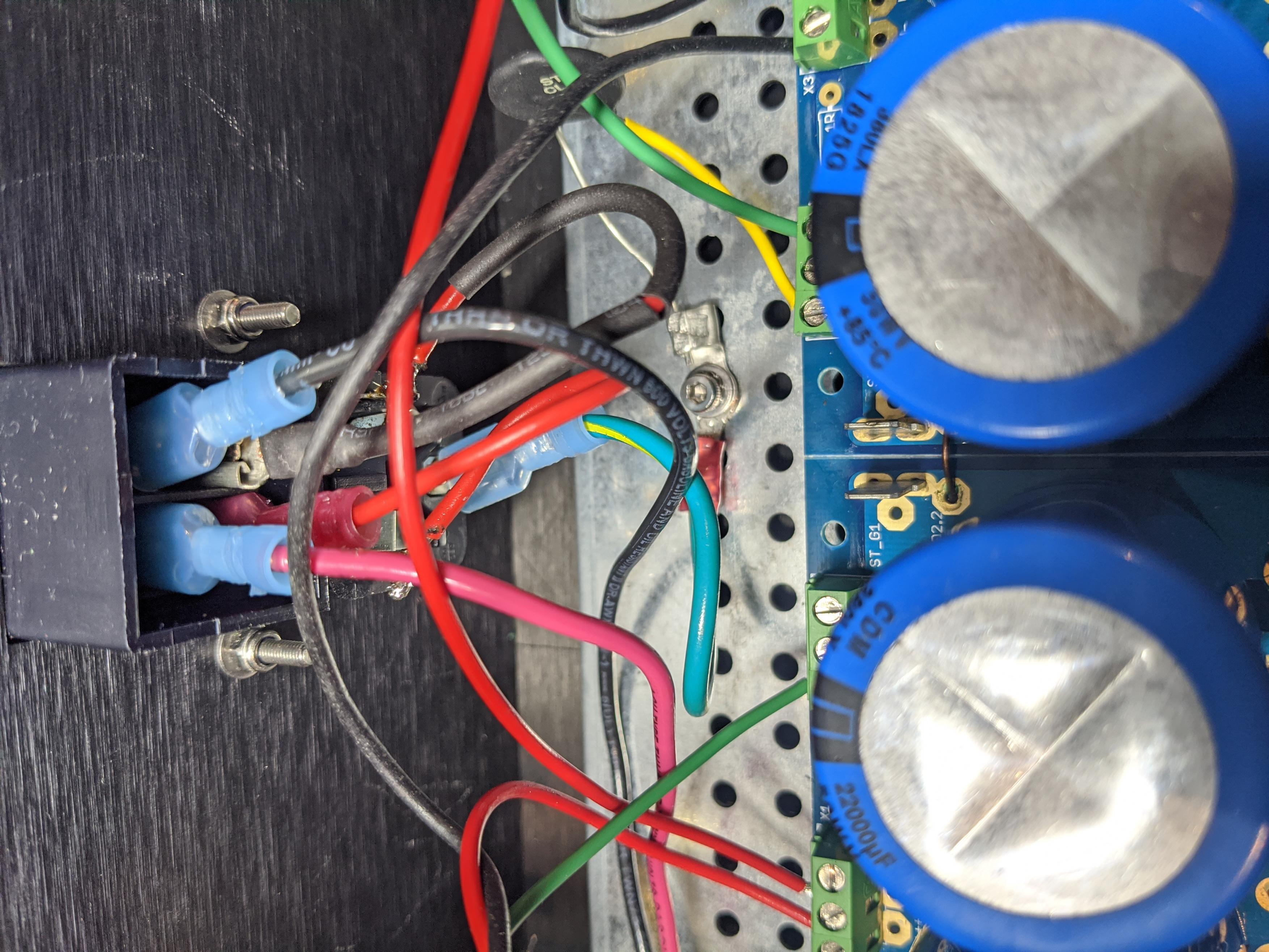

The PSU powers up well and nothing burns up. I'm getting +/- 36 VDC.

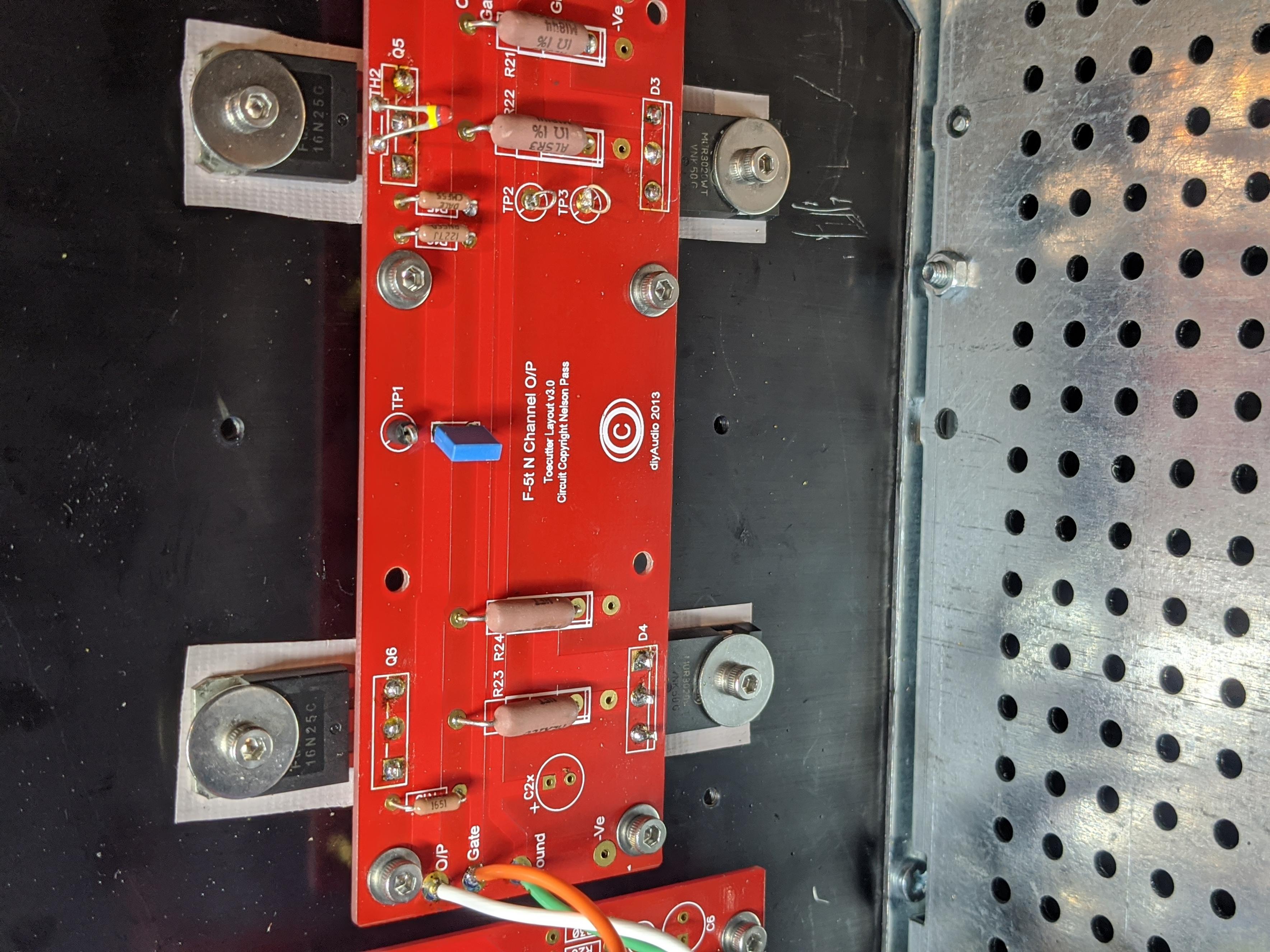

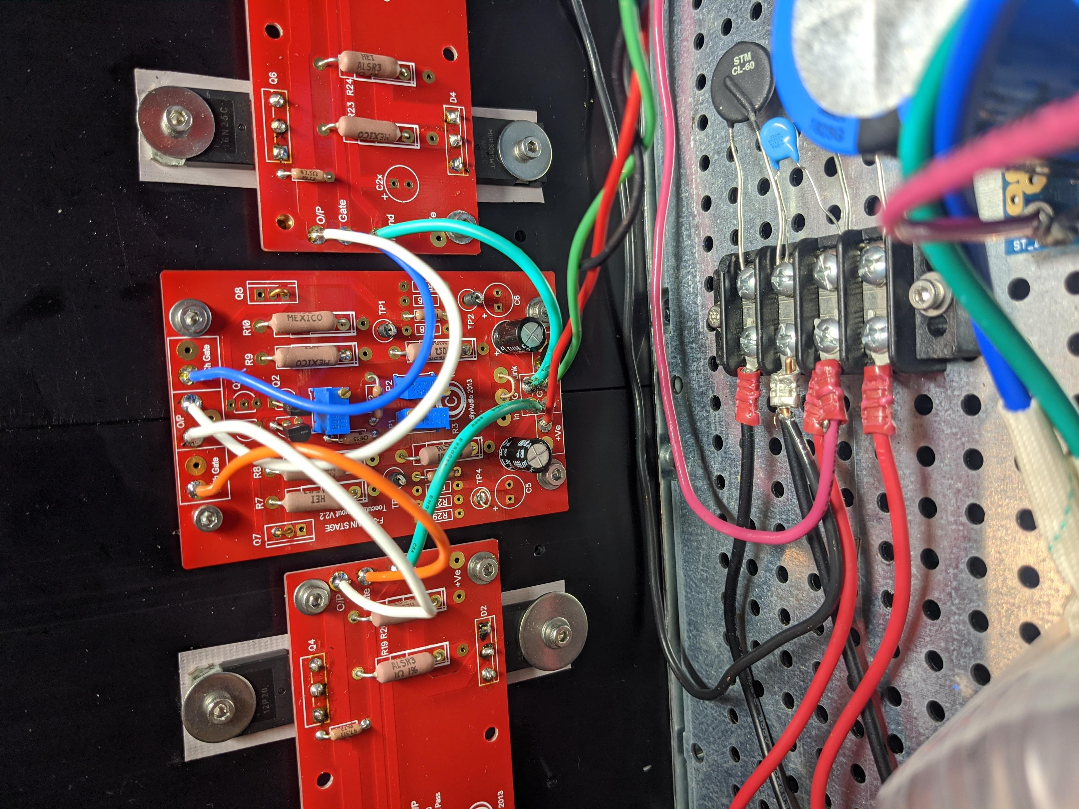

Here are some pics:

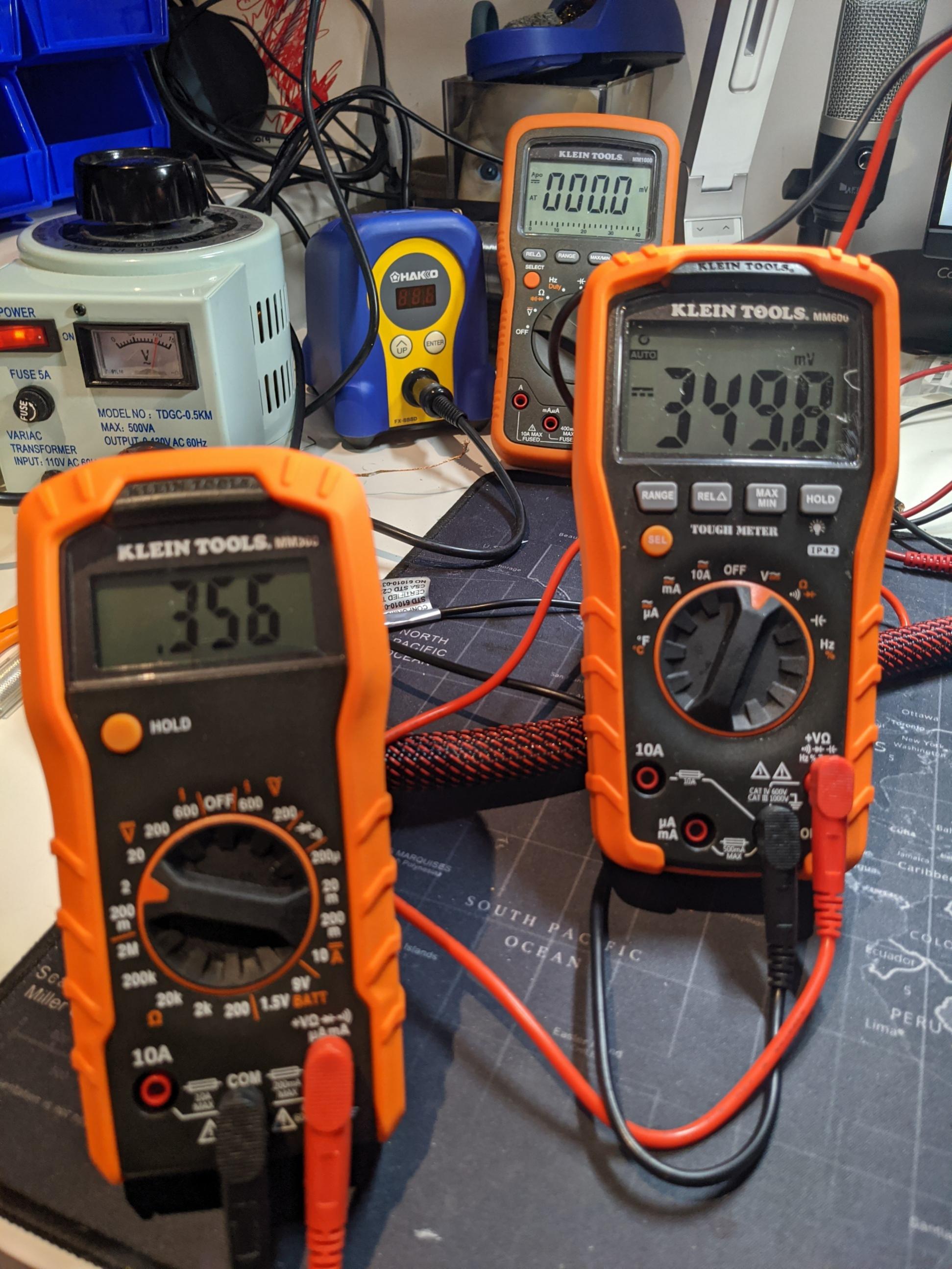

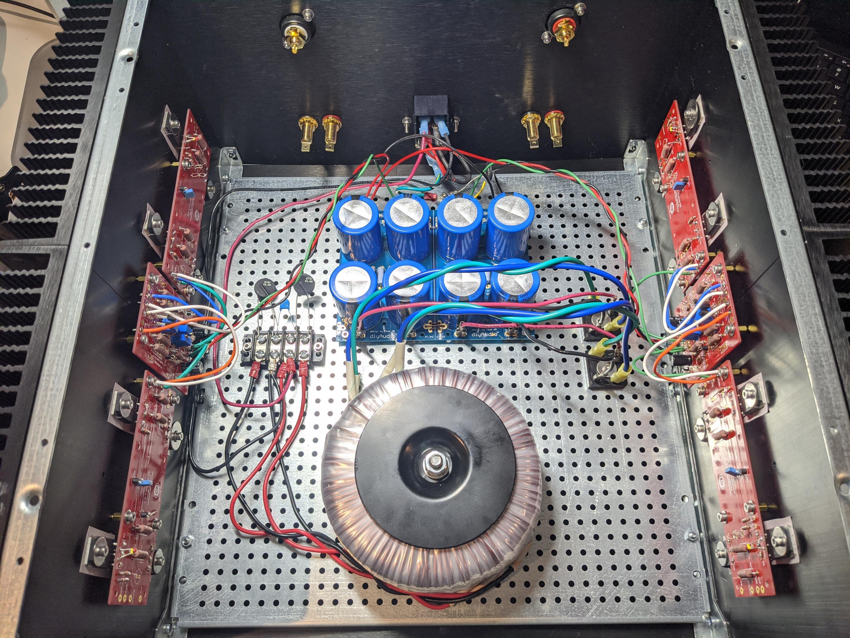

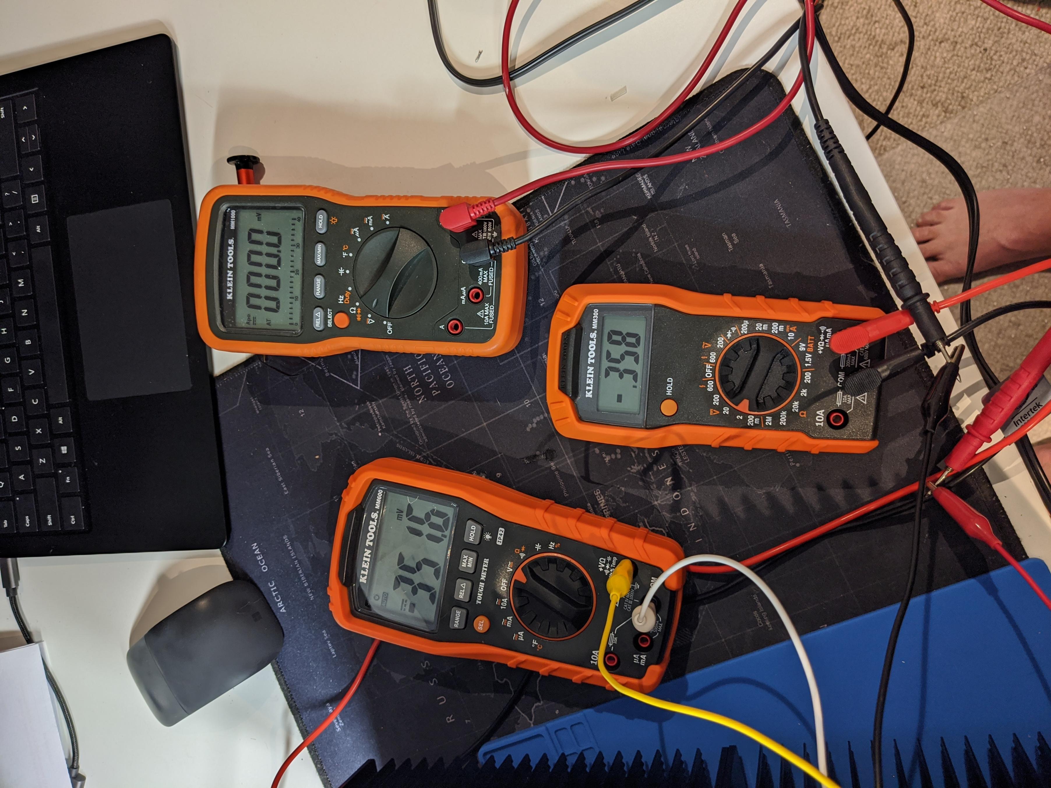

So last night I finished the amp and set the bias with the help of 6L6.
I have added the final photos to the album so have a look at that. The link is here:
Microsoft OneDrive - Access files anywhere. Create docs with free Office Online.
The photos here show the final bias ~350mV and 0V DC offset across the speakers.
Thanks again to everyone and if anyone (especially new members with limited knowledge) have any questions please ask away and I'll do my best to answer. I am more than happy to talk about process itself if not the specifics of the circuit.

- Solder (or connect) the wire to the gain stage board before attaching to the heat sink!! It gets pretty busy in there and becomes increasingly difficult to add wire. I would actually attach all the required wire to that and then secure it to the heat sink and then from there attach the other end of the wire to wherever it needs to go.

- Make sure the mains are at max voltage. Remove a light bulb tester if you are using one.
- Set your three DMMs to check DC voltage. If the DMM is manual, set to 2V or 20V.
- Using alligator clips, attach one DMM to TP2 and TP3 on the output boards: One on the P-Channel and one on the N-Channel. Ensure it reads 0V. These will measure the bias.
- Attach the third DMM across the speaker output. Ensure it reads 0V. This will measure the DC offset.
- Grab an insulated screw driver and turn P1 (or P2 – it doesn’t matter) 360deg. There may be no change on the DMM. This is normal.
- Turn the other potentiometer 360deg. Again, there may be no change in the voltage. This is normal.
- Continue alternating increasing P1 and P2 with 360deg turns until you start to read a voltage across the potentiometers.
- While increasing the resistance, keep a watch on the DC offset. It will increase or decrease depending on which potentiometers you turn. It should remain around 0V.
- Continue alternating turning P1 and P2 and bring them up to 300 mV (0.3V). Ensure that the DC offset remains at 0V.

- After 20 minutes, and if the bias readings have settled, and there is no smoke, increase the bias to 350mV by alternating turning P1 and P2.
- You may not get exactly 350mV bias on both boards at the same time as keeping the DC offset at 0V. This is normal. Get the bias between P1 and P2 as close as you can to each other within the 350mV range all the while with DC offset at 0V.
