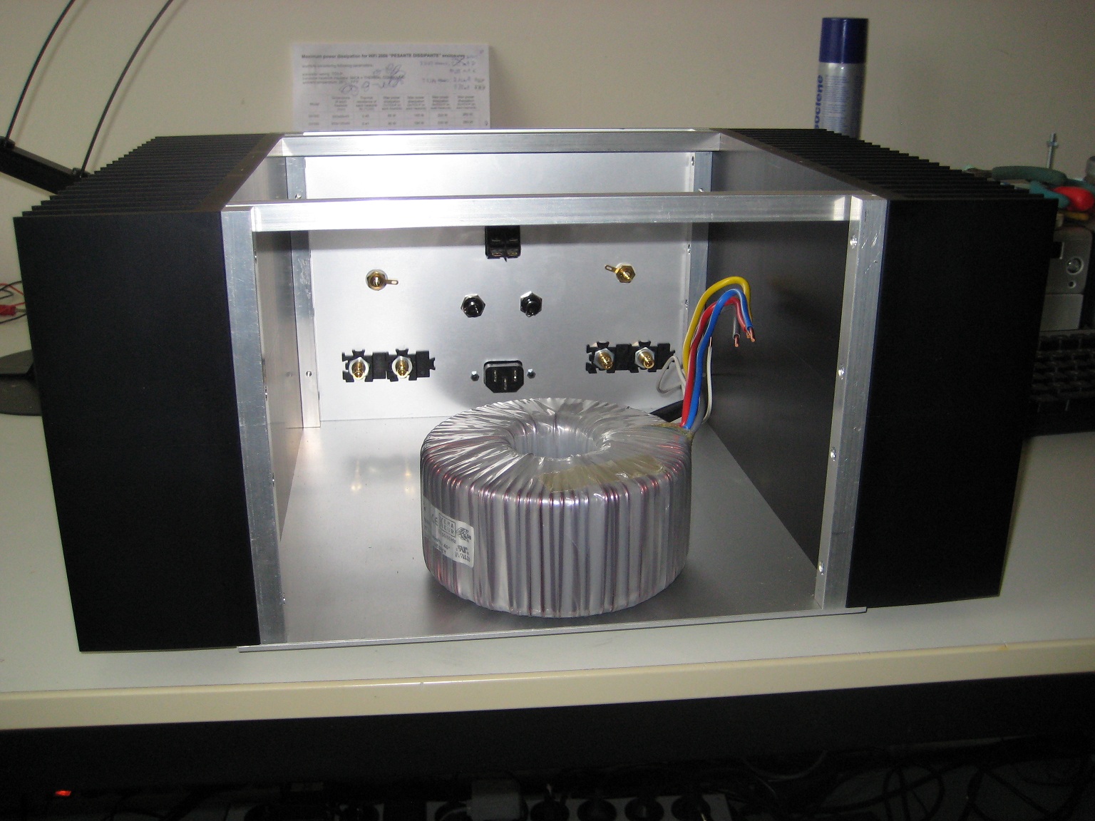

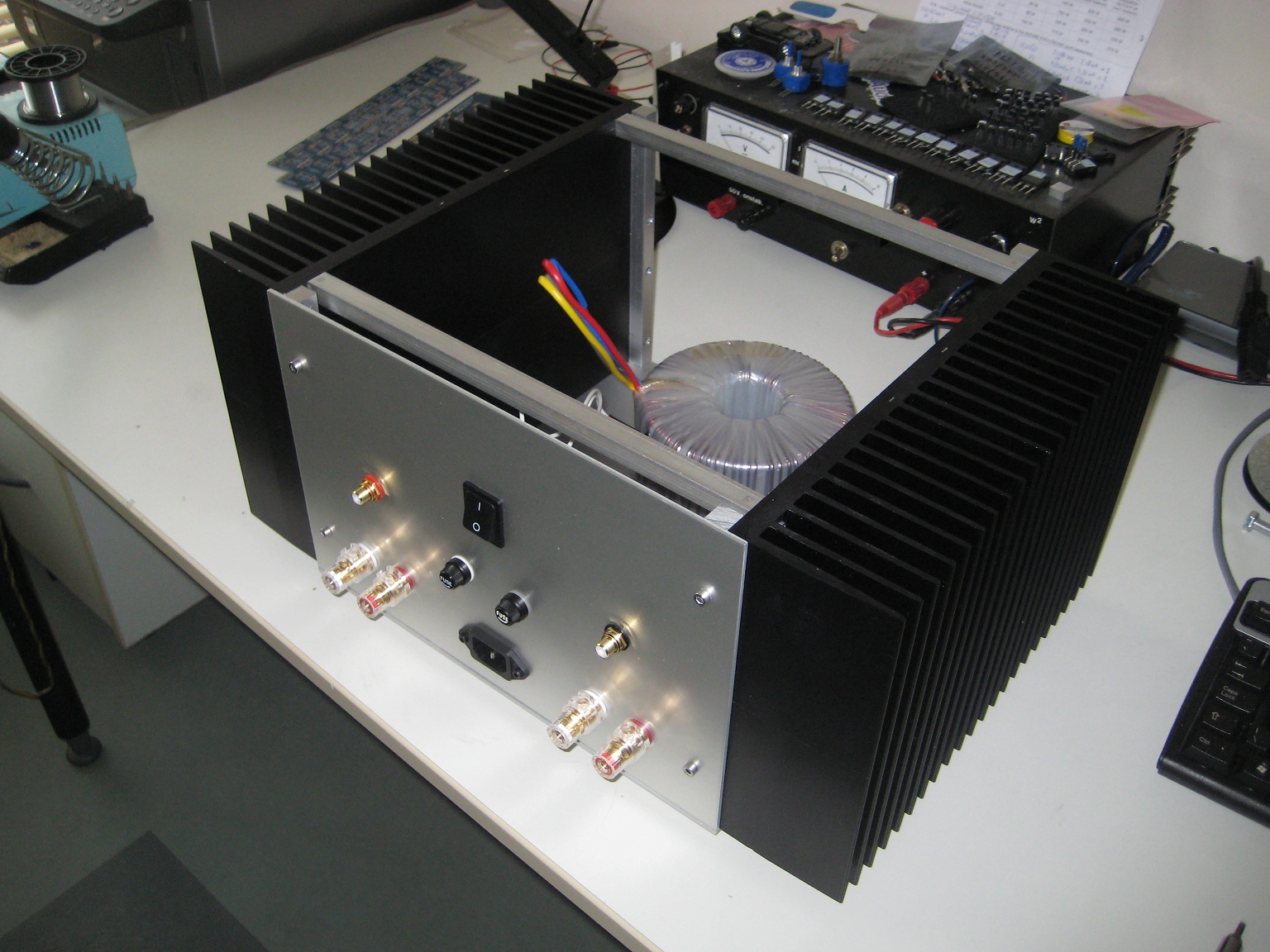

I'm waiting for these split boards to get on with my F5 Turbo version 2... See picture... I've ordered another two heatsinks which will go on top of these heatsinks. So i really need the split output boards...

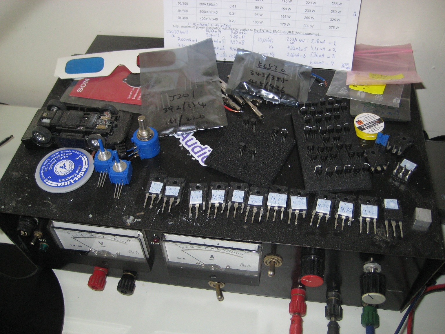

haha, no it's a no-name electrical racetrackcar I have to repair for my boys...
The transformer on the picture is a 2x25V 625VA Amplimo, if it fits I will have two of those in my F5T v1 or 2. I go for CRC.
Capacitor bank will be 88.000 uF per rail. I have 16 CDE 22000uF/50 volts who also has to fit in😀
I guess when finished it will be around 25 a 30 kgs 😀
