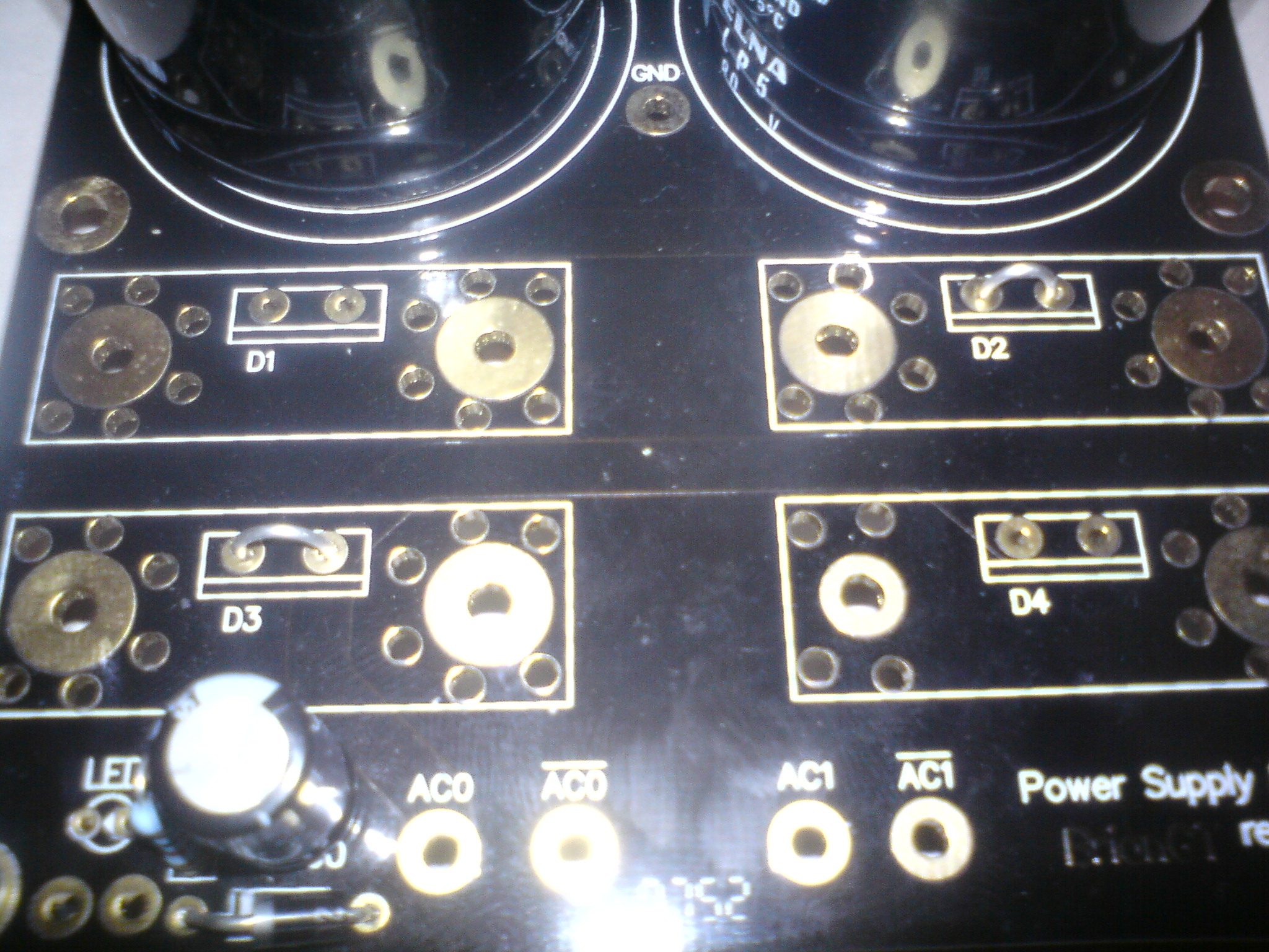

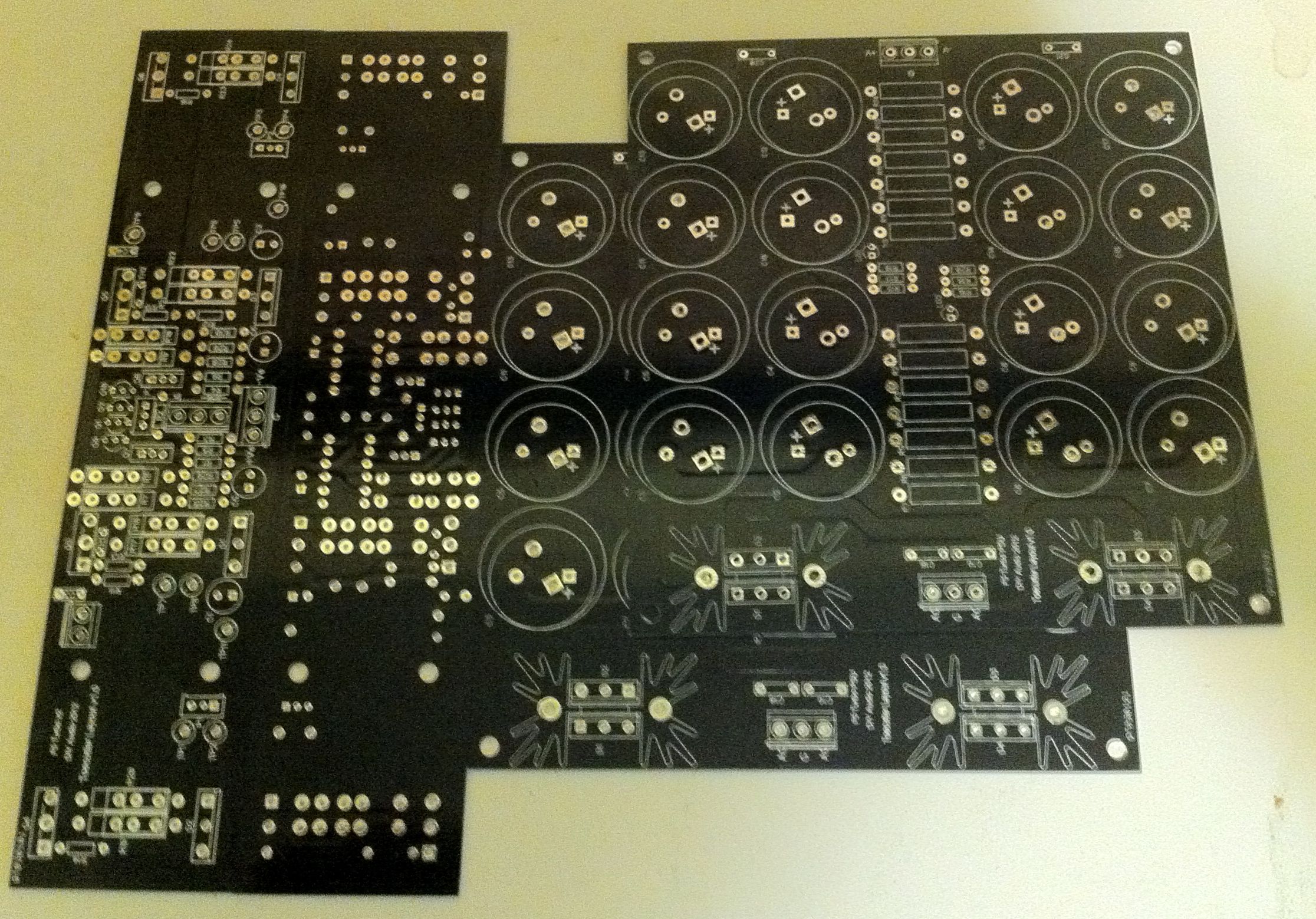

Capacitor board
Just need rectifiers bit and your faw cap choice
Left it big for duble caps diameters.
who said one picture is worth 1000 words?
No not selling, just free ideas from SAS
(Spagetti Avoidance Society)😀
cook your own board like one on this post
Plenty big straigt tracks any caps size you like all is needed is new set of holes.
and the rectifier bit but as there are so many different tipes to be had I did no bother with it
These won't fit - 35mm 🙁
so it is for F5turbo and F5turbo PSU. then drop the voltages down just a bit.

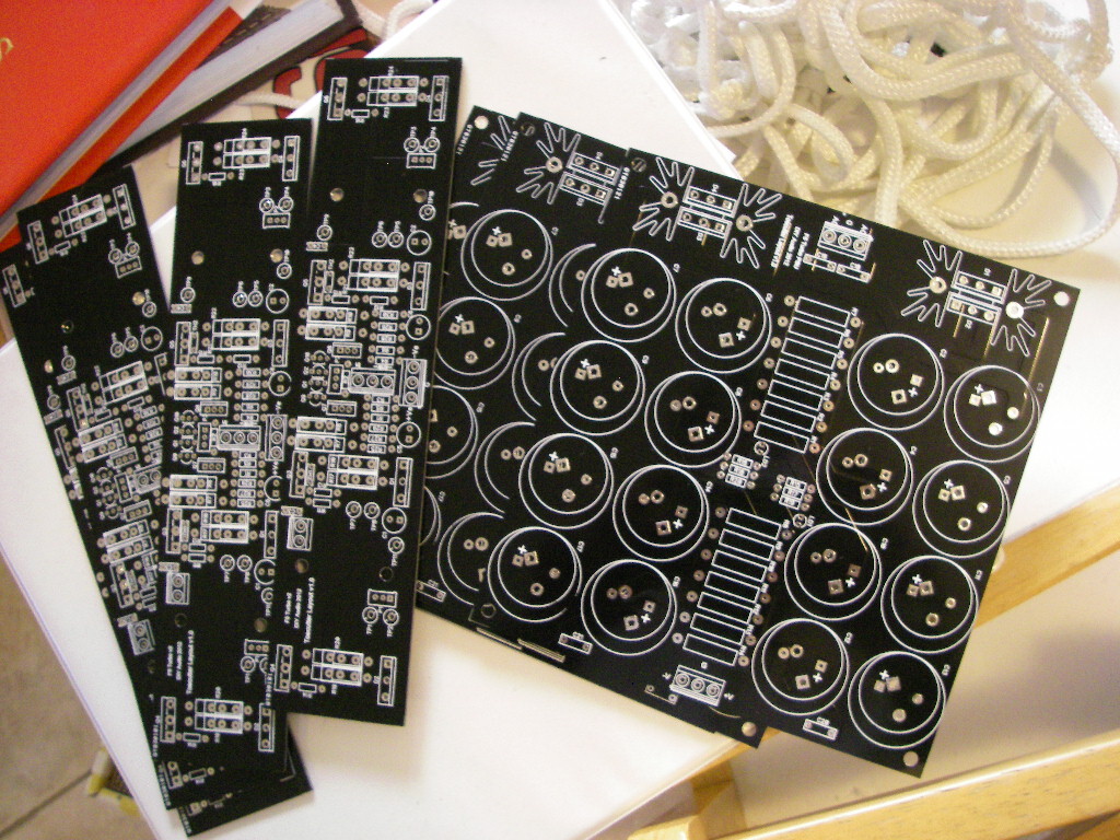

I will relay the boards to accommodate 35mm for the second batch
That's very nice. Thank you!

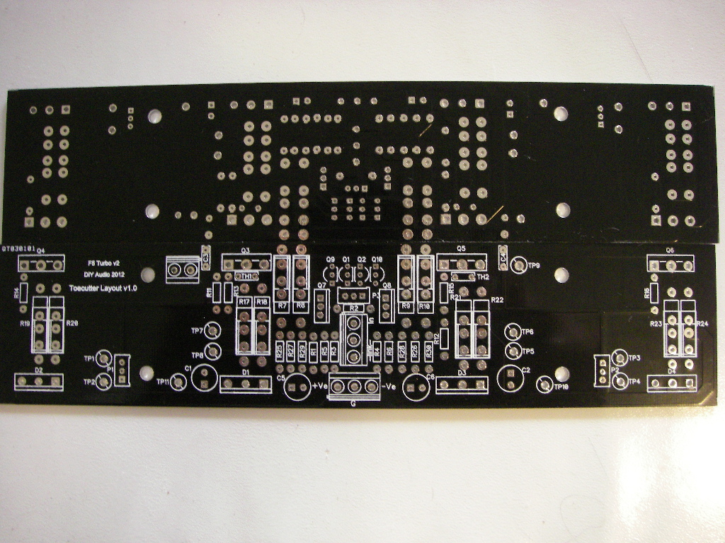

hey Rush , any chance of a better pic of the amp board ?
cheers Woody
cheers Woody
Hope this is better.
Rush
