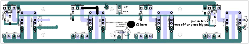

How about this one.....?
MOSFET spacing is 80mm. Resistors moved about a bit.
Size of board is 290mm x 50mm.

Mo bettah.
You might want to run the trace that goes from the Mosfet leg to the resistors horizontally rather than down and back up... that way you can add some pads and holes at an even wider spacing.
I know people say that these resistors won't get hot, but based on the F5 I have worked with, fully biased they get hot, and if this Turbo is fully biased up for low Z loads, I expect it will pass a fair amount of juice...
Also that C1 cap would do well to move up and over, and the TP on top can be moved to more open space too... and of course the dual TPs are not offset here...
If it were up to me I'd do much the same on the V2 board...

Bear, I created the 80mm spacing layout some time ago to try and match the UMS. It doesn't match the UMS actually anyway but I had it on my PC already so I tweaked it a bit with your suggestions.
UKtoecutter, I tried to show what I am talking about with a crude markup...
TP5 should also be moved to another area, so that it no longer is in line with what is now below it... maybe over to the right between another pair of mosfets...
_-_-bear
_-_-bear

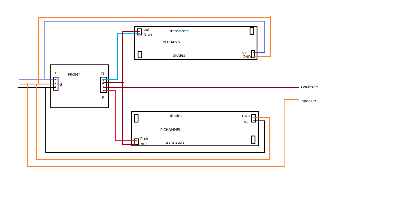

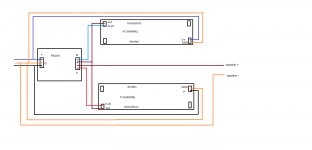

and also. C1 need to be turned 180degree on P channel?
same on the original output board. C1 and C2 need to be changed a bit. they must be monted the same way.
and turned 180 degree on P channel.
EDIT: never mind 🙂 just use C1 on P channel and C2 on N channel 🙂
Yes, quite right about C1...
I'll ammend.
