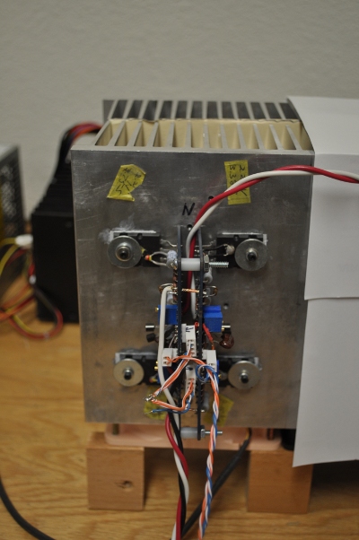

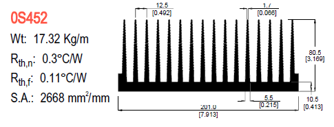

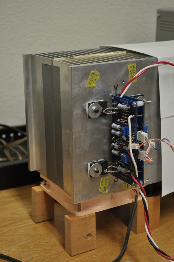

Here is today's experiment with a balanced F5 on 1/2 E007 at about 108 watts dissipation. The boards are Cviller v1.2 F5 boards from the DIYAudio Store. One of the boards has the polarities of all active devices swapped so that rails voltages are directly strapped from board to board.
The design is for rails voltages of 17.6V and bias of 1.7A per MOSFET. Output power should be around 46 watts. Currently I cannot run it above 1.5A because of limitations of my bench power supplies. With these limitations the 1/2 E007 heatsink is only rising about 20C with 108 watts, being cooled with a Noctua NF-S12-800 fan (800 rpm, 59 cu-meters/hr airflow). The heatsink must be cut in half before I can believe the temperature rise measurement.
I fired it up today. The 2nd harmonic was adjusted to a minimum in bridged-mode (ie. the JFET source resistors grounded) . The THD measurements directly follow the curves in Nelson's F5 Manual.
The idea is to make an identical copy on the other half of the E007 heatsink, placed fin-to-fin to form a heat tunnel. This will provide a compact 40+ watts class-A per channel balanced stereo amplifier.

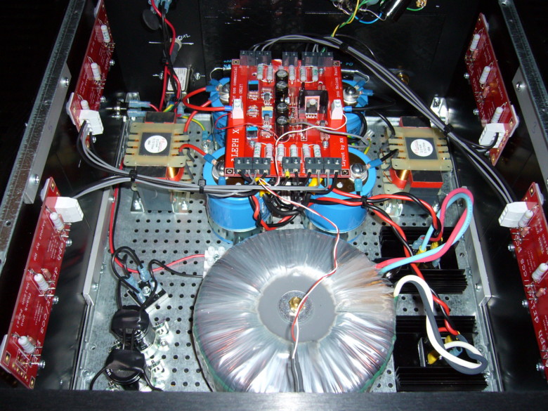

Could find only these. It's a modded Hifi2000 enclosure.

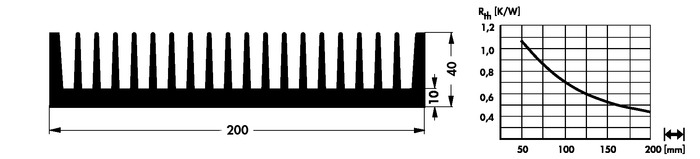

Any ideas whether the Hifi2000 5U cases (400 mm depth) are sufficient to house a V3 ?
Can't find dissipation figures anywhere...

On the modushop Website you will find the heatsinks as individual item and they have the dissipation information. If I'm not mistaken it is 0.3w/c per heatsink and each side has two of those.

Modello: Profile 200 X 40 H 165 mm
Used for the 4U enclosure 400mm deep temperature coefficient 0,38 C°/W
2 are used per side, so 0,38/2 = 0.19 C/W (assuming perfect heat transfer between the two heatsinks)

Modushop mentions 0.28C/W for 2 heatsinks lined up (210mm length) , sounds a little optimistic.
Placing two heatsinks side to side drops efficiency, so a single heatsink would have to do lower than 0.56C/W
For 25C above ambient, i wouldn't try to get more than 150W from a 5U case.
