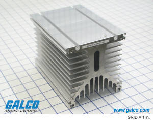

6 of these, 3 on each side, ~15" deep stereo amp.
Good for 100W Class A, manufactured all over the world.
Do the crime, pay the fine.

Found the cut sheet here:
Semikron P3 Heatsink Data Sheet
These guys sell the heatsinks in the US. You have to ask for a quote, so not sure how much they run. They do look nice.
HEATSINK-KL-285P/180
Whats the cost on those sinks .... ?
