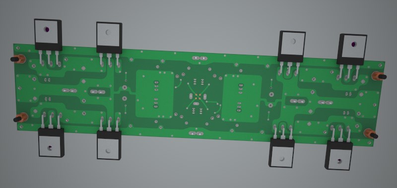

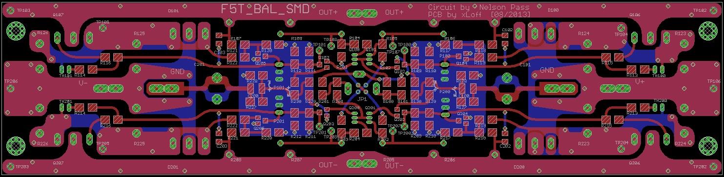

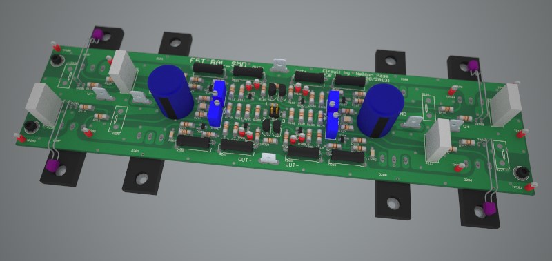

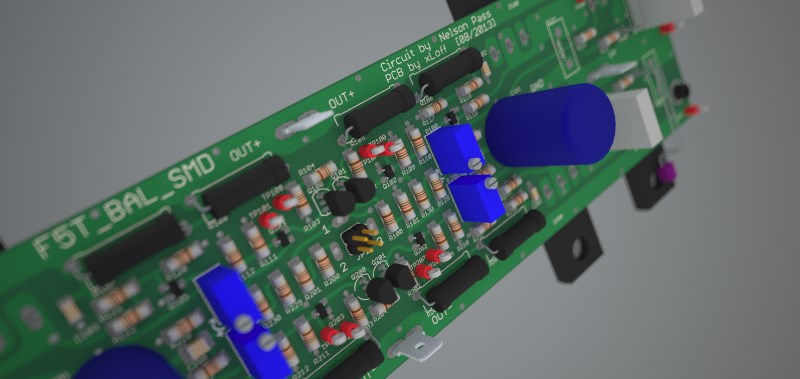

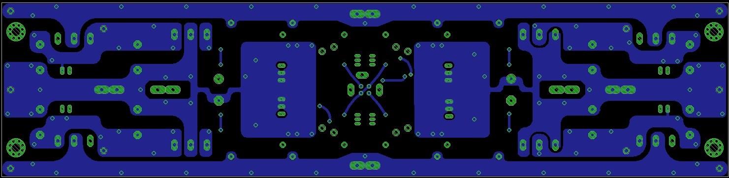

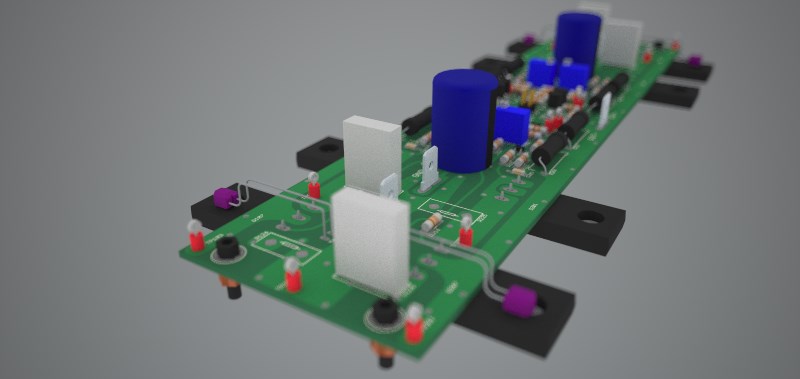

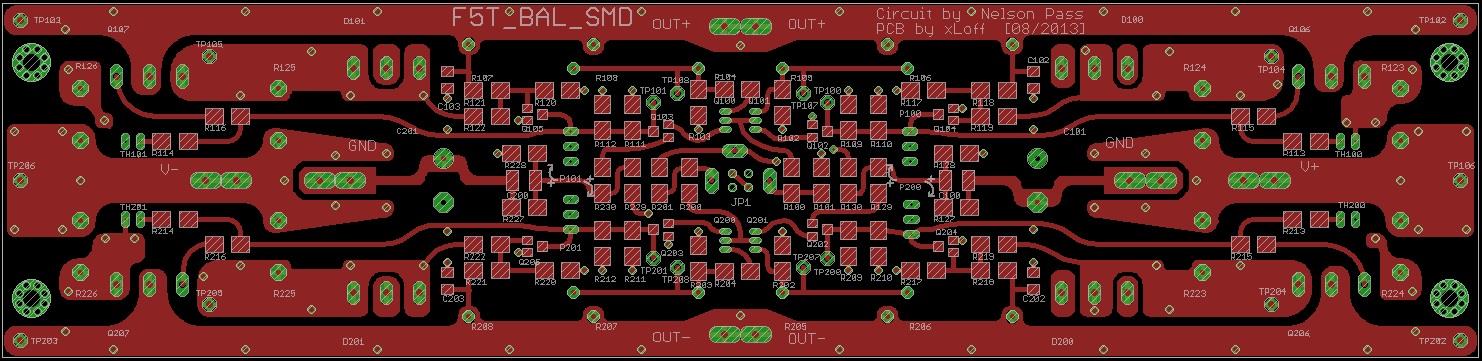

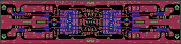

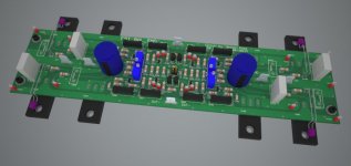

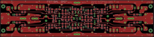

I have been working on a P5T PCB using mainly SMD components in the small signal path (MELF resistors, 1206 also possible). It started out as in Nelson Pass' Turbo article, but has evolved with inspiration of EUVL's work on F5X.
Planned specs:
- Bias 1.2A - 1.5A
- PSU: 2x625VA, 18V AC secondaries, DIYA Store Boards
- Modu / Deluxe 5U 400mm Chassis
Some of the decisions on this design may be overkill / unnecessary (e.g. cascaded input stage), but I like to have room for future modification/tuning. Also, the value of the BE-resistors of the protection BJTs have to be updated in the schematics. NP uses 150Ohms in stock F5, but with the turbo diodes I believe they should be increased up to 3k-4k for Rx17/Rx20, for limiting to ~0.75V over source resistor/diode parallel connection (10A@60C?). Are they populated / which values are used on the DIYA store boards?
Any useful feedback for (hopefully minor) modification would be greatly appreciated before I order boards.

Use 1206 Susumu RG or Vishay TNPW. Spec wise, you have to spend a lot of money to beat them. Also check out Isabellenhuette PBH for your power resistors, same thing applies. I am not sure the legs on your thermistor will allow you to stretch that far. May be able to go under tha board. I have considered an uncovered pad right at drain pin to attach it to. This should give pretty good thermal coupling to the heat the fet is seeing.

F5T (V3) Balanced SMD [II]
Thanks for the replies. I was mainly hoping for some PCB layout hints and feedback, not to start a theory discussion (enough of other posts of textbooks on this topic).
Thanks, I’m finally getting there… I prefer SMD as I have more experience with SMD PCBs, mainly high speed switching stuff though. They have smaller footprint, less parasitic (lead) inductance, don’t require though-hole drillings (messing up potential ground plane) etc. These are usually not critical for audio, but without compensation the F5 BAL may have gain up to 3 – 5 MHz.
Fancy specs, alright. At 10mg, they cost more than gold per gram...

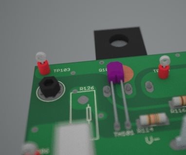

Thanks, good point: On the 3D-model the legs are way too long. You mean attach it to the PCB at Drain right next to the soldered pin? (neat)
I hope to bring it up to 40W Class A, if the temperature on the heatsink allows it. I already have the cascodes there, so if necessary for future speakers, I could also increase the rail voltages. However, I use a different calculation than you.

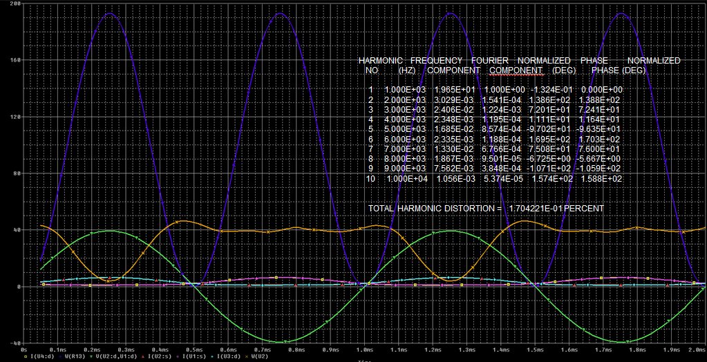

My main concern is, like flg pointed out, is the maximum current. Also, the grandmaster mentioned the SOA of the 2SK/2SJs in the turbo article. From a simulation, I expect other distortion mechanisms to dominate before Class-A crossover.
Input signal 4.1V sine at 1kHz, 8 Ohms output. Blue = load power, Green = differential load voltage, Orange = Positive output HS PMOS power, rest: current though all 4 FETs (overlaying). At 3V VIN, same circuit simulation gave ~3.8E-02 THD. [calculation of output power left as an exercise to the reader 🙂]
