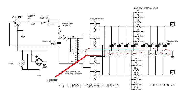

and one 24VAC secondary??? you need 2x24VAC
This source is not symmetrical, have + and - there is no point 0.
Where I turn on 2x24VAC in PSU...
I must be confused or to do evil thing!!!
You are absolutely right, I apologize for my inexcusable stupidity, and I did an F5, brbrbrbrb. Rectification common to 2 channels completely confused me.brbrbrbr😕here is the 0 point.
one channel, P&N rails
