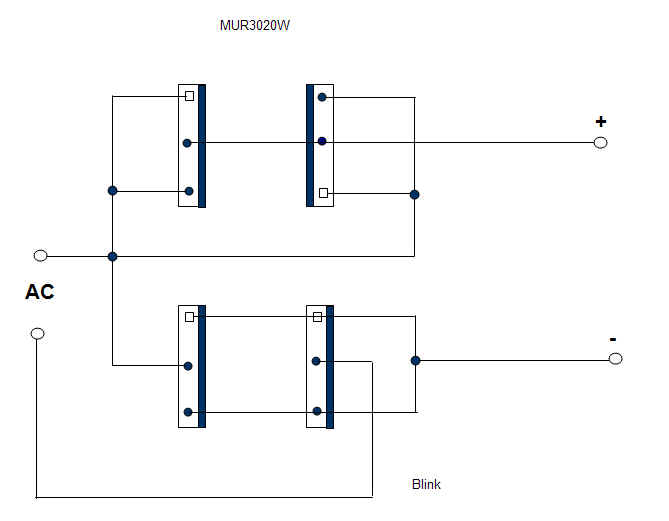

Hi Blink,I'll build the PSU to F5T 2 in a board made by me, but there is a doubt on the links of MUR3020W!
Thanks to confirm that the connections are correct. thank you
This is the correct connetions

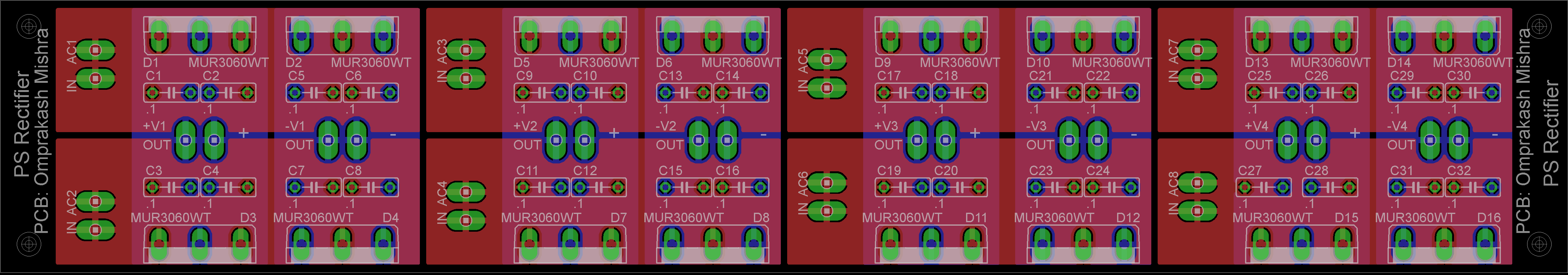

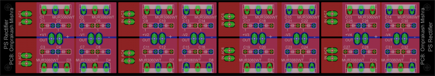

It is easy with 2 layer PCB. See how I made it for 4 blocks, you are referring one of them.
They are all the same, change the color? The rectifiers in this scheme are separated from PSU?
What is the value of the capacitors connected will bridge?
Saw its construction in Hifivision and really liked...

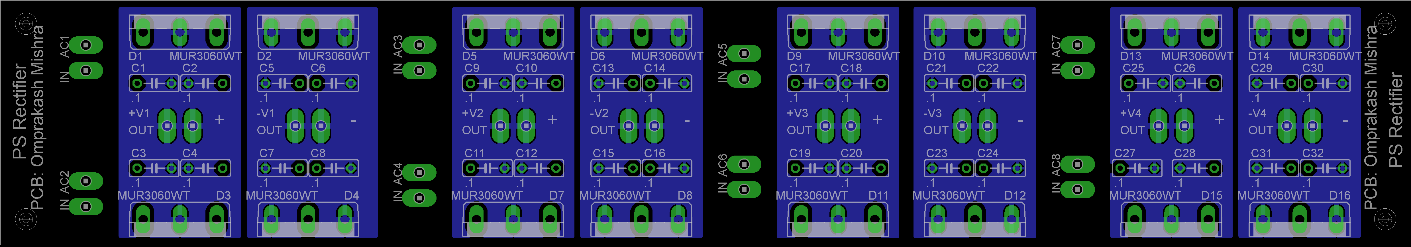

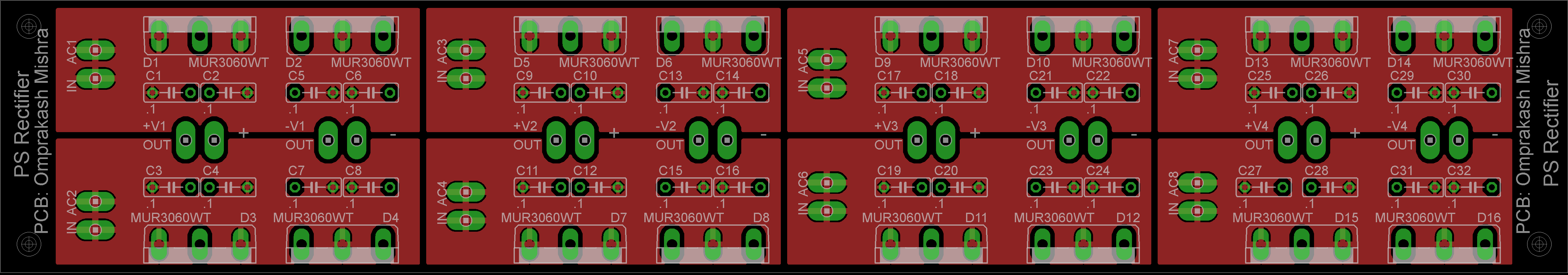

Thanks ! First one is two layer PCB (red+blue), second is top layer(red) only and third is bottom layer (blue) only. All these layers are shown where diode pins are connected to specific layers only - either top or bottom.
Caps across diodes are 0.1uF, 100V film caps. This will connect to CRC filter board where each rail of single channel will have 4X 15000uF, 50V caps. There will be total 4 of above in stereo amp.
