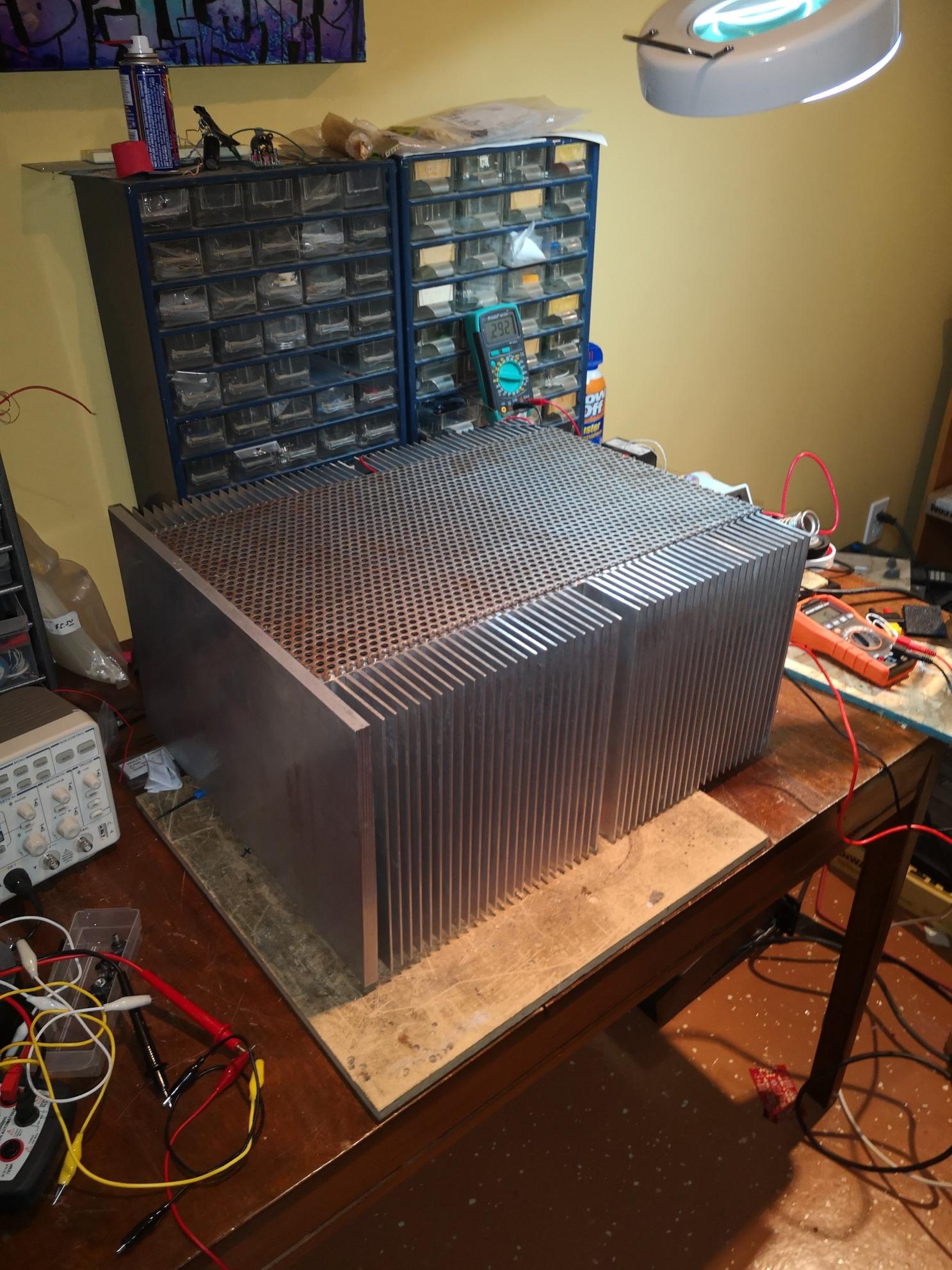

Both channels now show the same DC offset shorting plugs in or shorting plugs out, I think it is basically done....
43.3 deg C 21.5 ambient, biased at about 290 mV, rails at 36.6 volts, about 86 WPC peak Class A power.
Can easily bias higher, but in the summer those 30 degree C days will push the heatsinking to the limit and I've got no A/C.
I guess the only thing to do now, is let it cook for a couple hours, then rebias both sides and close it up.

I've ordered a wooden dolly to help move it around. I'm not so young anymore -- It's really heavy. It is coming on Tuesday -- I will listen to it then.
This has been one big weekend for the build, so I am going to quit work on it now. It is cooking with the lid on. Both channels are below 4 mV DC offset so far. I am thinking of measuring THD+noise at some point. Perhaps tomorrow

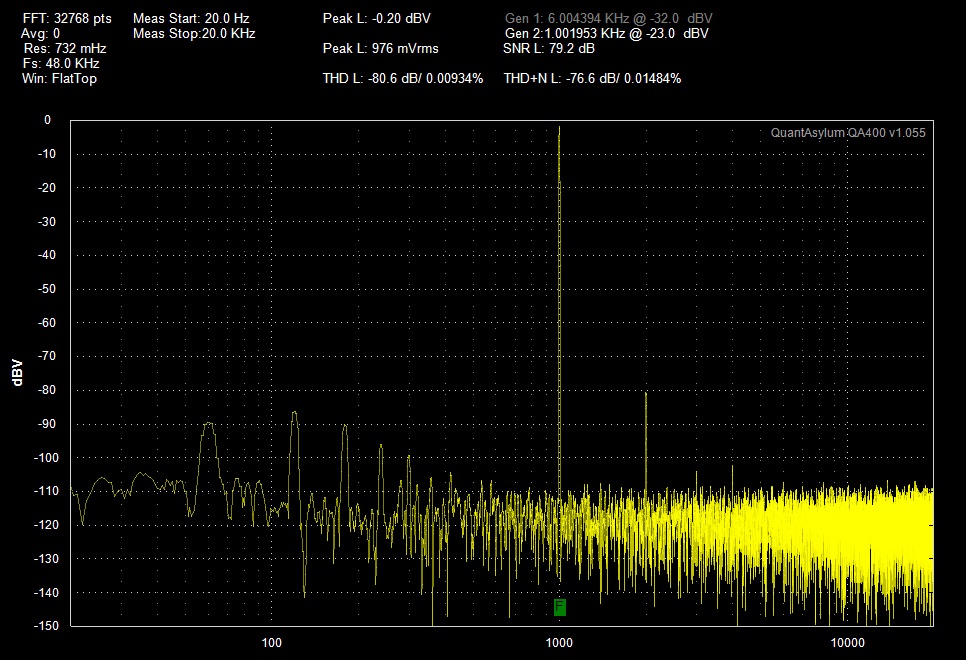

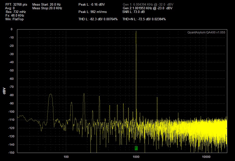

Awesome!!! I had a bit of a scare.... the THD testing on the right channel did not show any output at all.... turns out the rca was shorted with the smallest of solder bridges.
After fixing that, here are the distortion figures I get using the QA400. I know, not quite at 1 watt output, but check the SNR is different between the two channels.
I wanted to measure the effect of having snubbers on the diode bridge in real life.
I know both pics say Left channel, but the file names identify the correct channels...... the Left channel has a LOT better SNR. It has the resistor/cap snubbers on the diode bridge. It is also biased a little higher... 5mv or so? But I am guessing the reason is the snubbers, as the noise that dropped is at mains frequency and multiples.
These are the teabag power supplies. I will be adding the caps and resistors to the diode bridge on the Right Channel for sure.
There are no snubbers on the power transformer at this time.
THANKS AGAIN. THIS HAS BEEN AN AMAZING BUILD FOR ME BECAUSE OF YOU GUYS!!! I'd never have gotten this far without your help.
Not quasimodo. That's the next step. I had it in once, but realized it should probably be built from X rated caps, so I removed it. The snubbers I'm talking about are the standard resistor/cap across each diode found on the Teabag boards to sink the switching noise of the diodes in the bridge.
I'm going to leave the bias, fix the diode bridge and retest. Just to take the difference in bias out of the picture, as higher bias seems to be a bit better too. After letting the real left channel rise further, I measured under 0.01% THD...0.008 it was -- and at very low power.
Bear in mind that these figures are taken at *less than 1V output* over an 8 ohm load. To get that load I wired 8 of the 1 ohm Fukushima resistors together, so it's an accurate 8 ohm load. The signal to noise ratio will be below -90 db at 1 watt output ( 2.83 volts ). The power here is near a tenth of that... this is a very very quiet amp.
It *does* have a hum breaking resistor on the Front end boards, and it is true dual mono -- only the power cord is shared.
