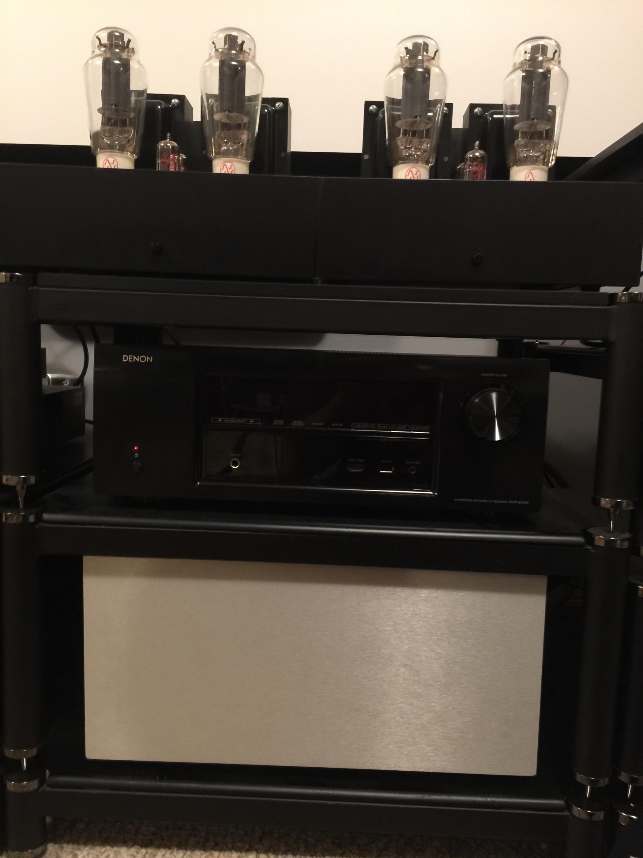

@McQuaide - If those are VTI racks (If they are, I have the same ones in a different color scheme) - you'd need to lift the rack just a wee bit for a 5U with the "isolation feet" to tuck it under the bar, but there's clearance. I have run the 5Us in the bottom slots and in "open air" on top. I get about a 4C difference from "open air" to the bottom. With the bias set normally on a F4, F5, Aleph J, SissySIT, and M2x - I've never approached 55C on the sinks - internal temps seem fine. I set the F5 to just a shade over 1A8 last week, and it's been in the rack for quite a while. My room stays around 70F year round. Whether it's a good idea or not... I leave my amps on pretty much all the time unless I'm out of town.
So... you might be just fine in PA. If you want it the coolest... then use a babysitter or put it on the top rack as others have said. Just thought I'd chime in since I think we have the same racks. YMMV based on the amps and the bias. F5T may run quite a bit warmer.
Yes that is a VTI BL-304 rack, it's good to know the 5U will fit in the bottom. That's an F5 biased at 1.5A in there now and there are no heat issues. I suppose I could try an F5T down there and see what the temp difference is vs. running it in open air.
If I run it on the floor I thought I'd get another VTI bottom shelf to raise it a bit.
@McQuaide - We have the same family of rack. So, yes - if you have the 9" bottom rack, then you can just squeeze one in. I don't think the anti-vibration feet are all that wonderful IMHO, and if you install just the standard feet, you may gain even just a tad more clearance. See below for the fit with the anti-vibration feet. Current sink temp (stabilized) with the F5 at 1A8 is 47C in a 21C room. Enjoy!
That's a standard F5 biased at 1.8A or .85v? Mine runs at about 50c biased at .7v, in the 4U case.

Yes. Standard F5. I wandered over to this thread after contemplating how to potentially try something with more current for 4ohm speakers. I'm just learning.
I think I understand your question - Yes. With my standard 0.47ohm resistors it's roughly 1A8 / 0V85 with a rail voltage of ~24V loaded, I get ~39 to 40W on the device. Still trying to get my arms around all the bias calcs for the various amps etc.
I did my set up originally at 1A5 / 0V7, and it was running ~43 or 44C if I recall correctly. I also use an el-cheapo laser thermometer off of Amazon, so I have no idea if my temps are accurate. I usually try to find the hottest spot on the direct opposite of the device.
If we have the same ambient... then it's kind of cool (see what I did there) to know how much additional cooling the 5U provides.

My room is around 22C and I use the same type of thermometer. I don't think I'll push it past the 50C I have now.
