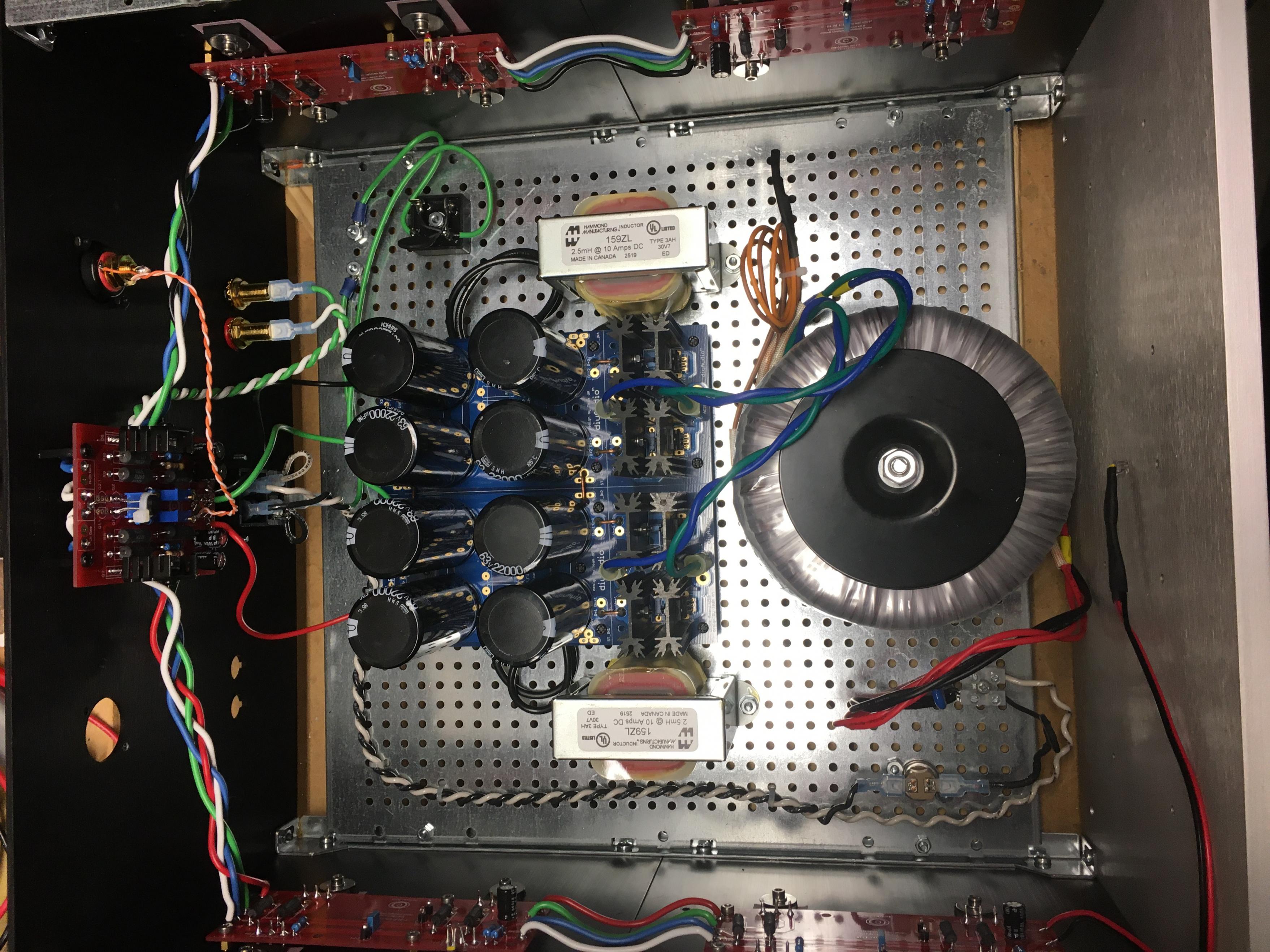

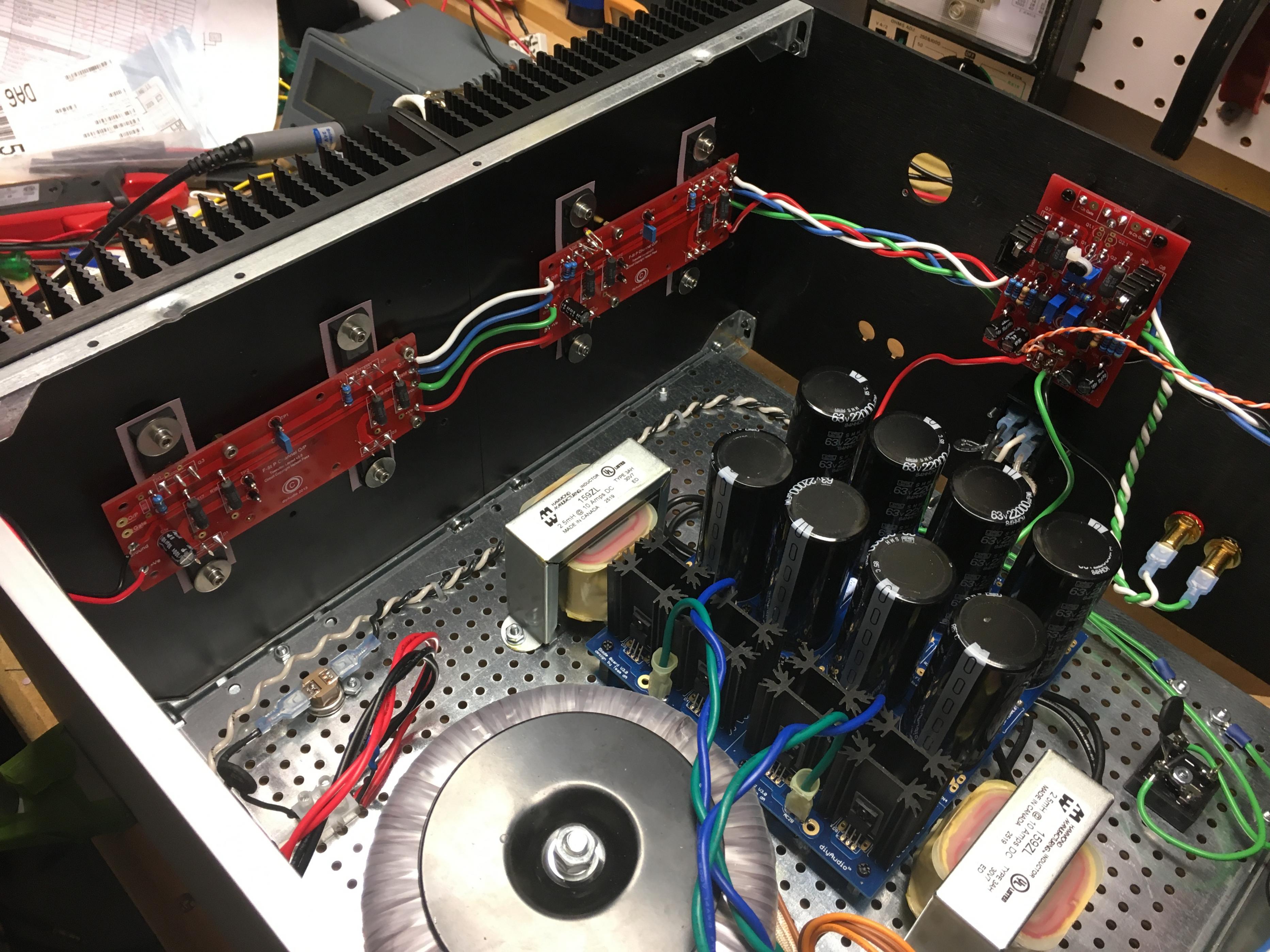

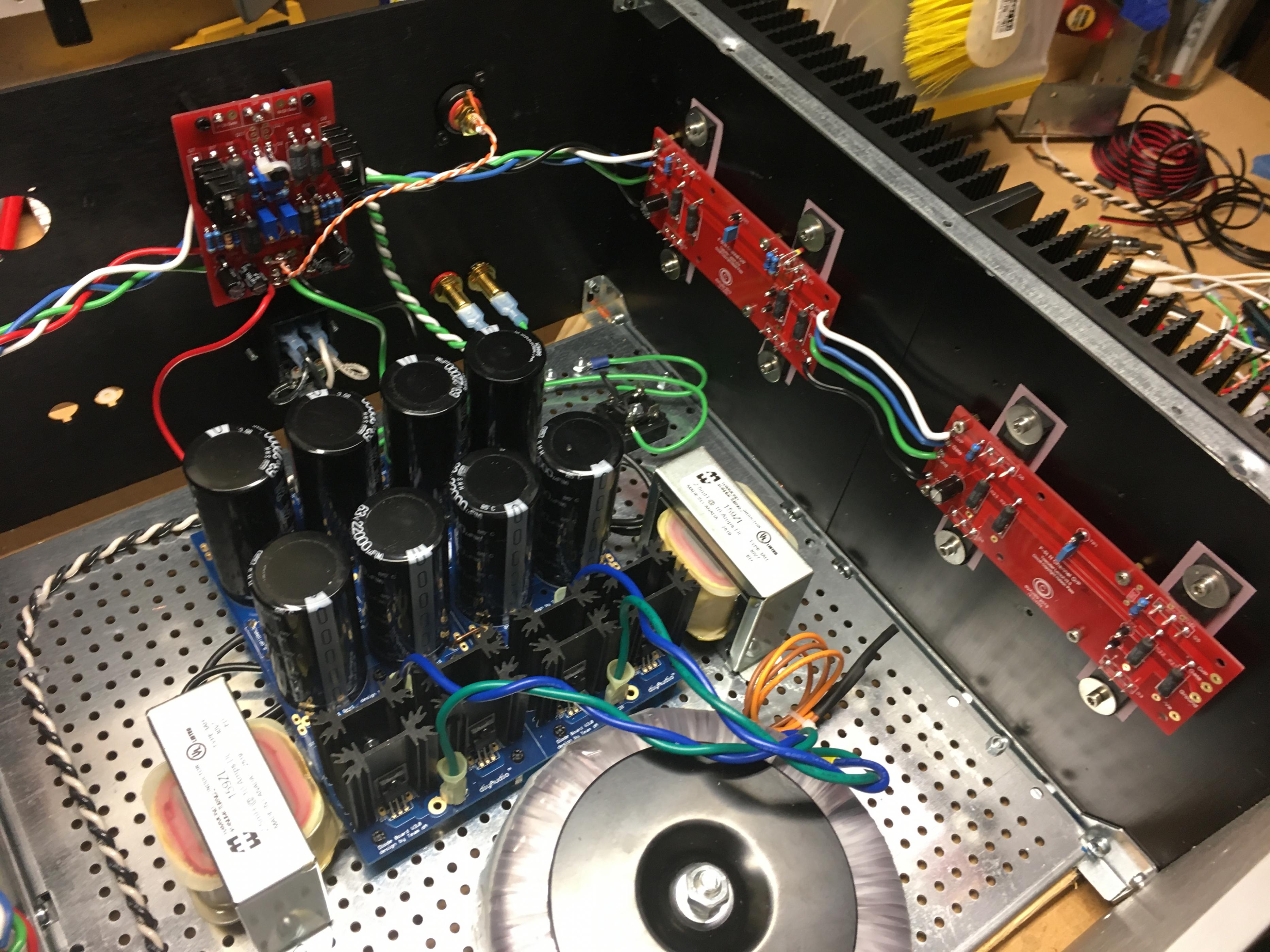

Monobloc 1 of 2 done. This is the V3 turbo I’m making for a good friend. Unfortunately I’m all dressed up with nowhere to go. Either my buddy didn’t order fuses or I misplaced them in my messy work area. I’ll order fuses and get to work on another amp. I can’t wait to fire this up, get it biased, and hear it rock.
