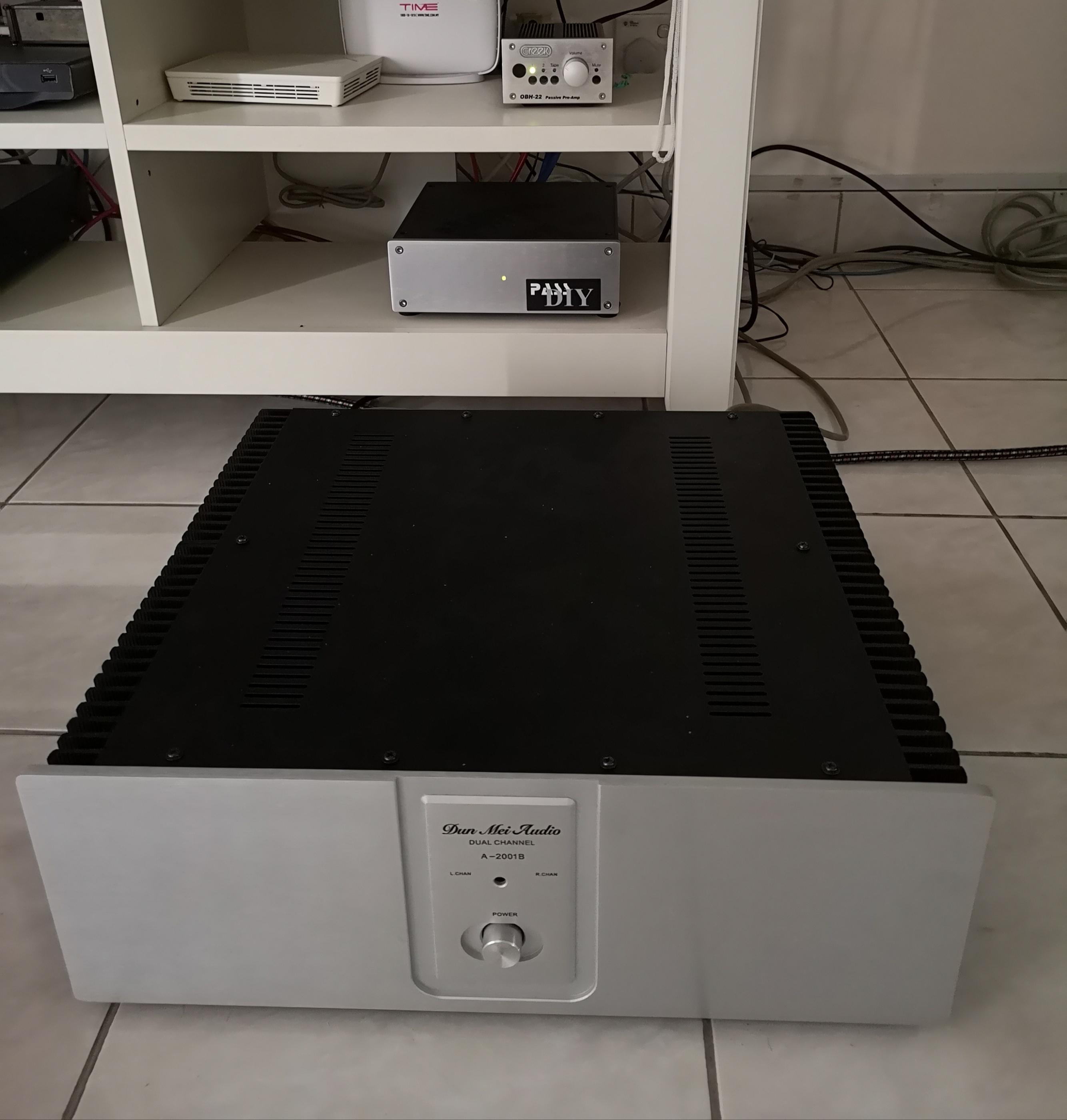

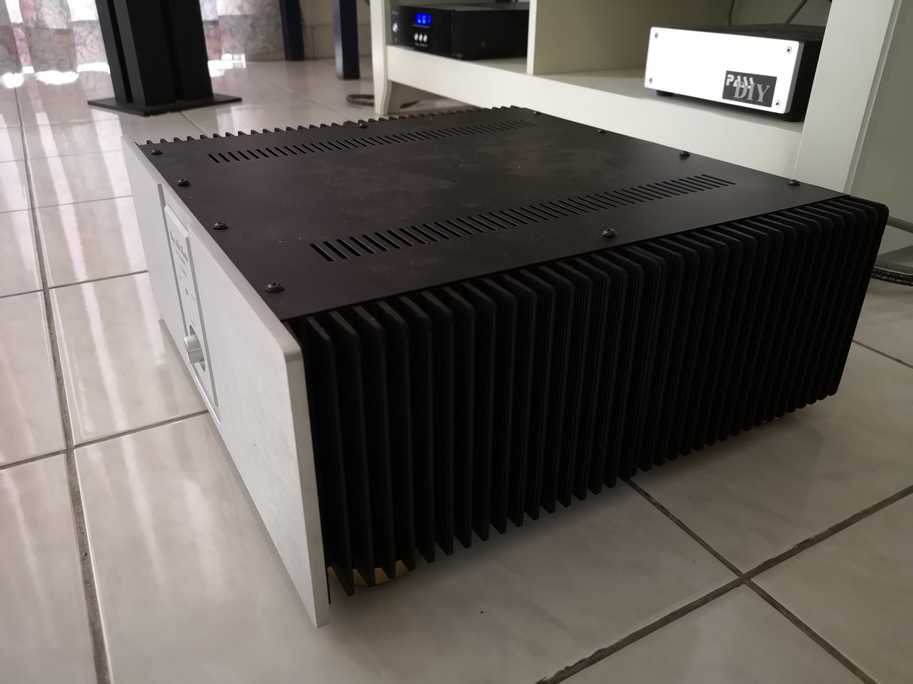

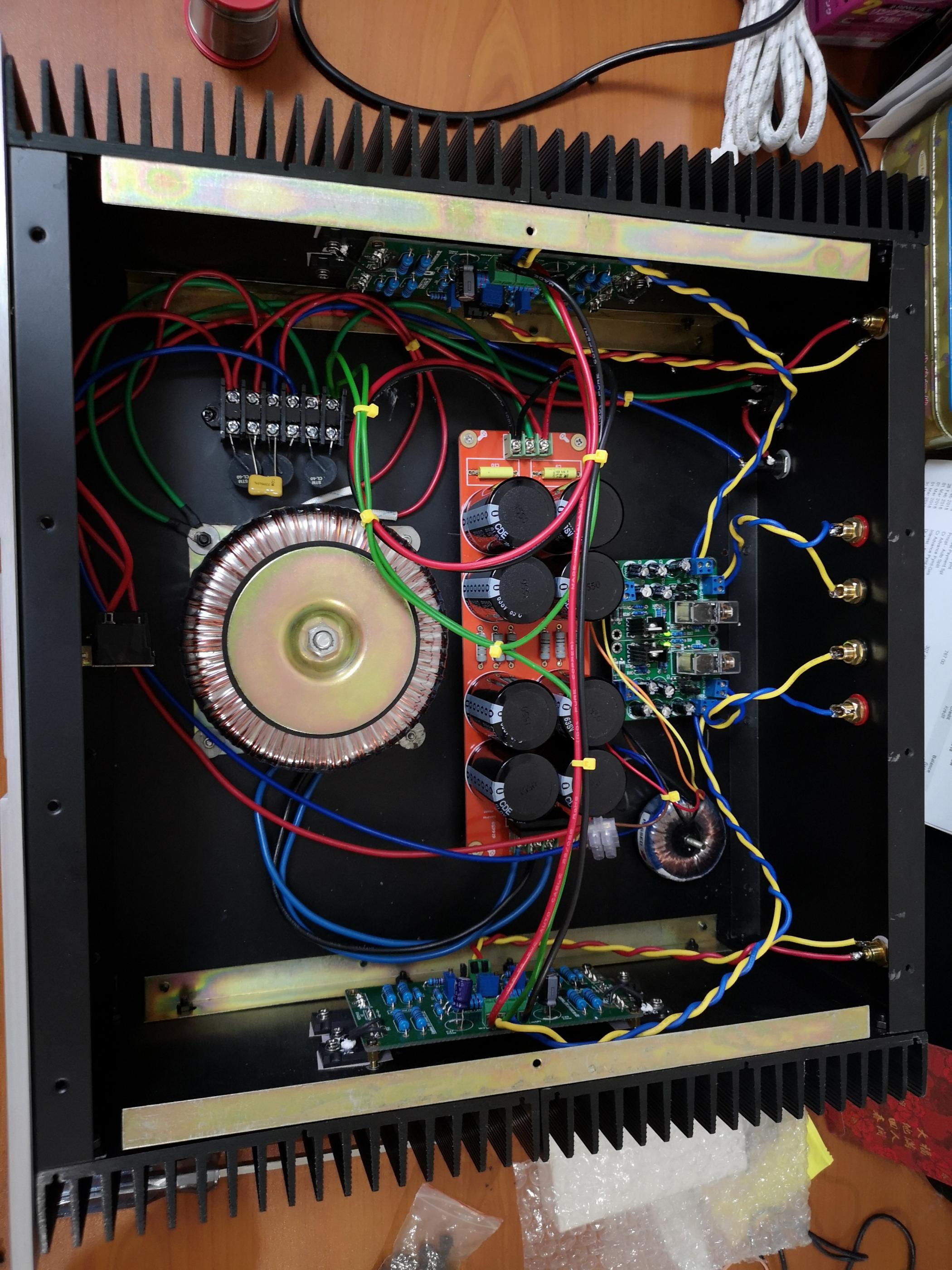

Hi All,
A friend wanted to have a go at DIYing a Pass design that is reasonably powerful and since I have some experience with F5T and MoFo, I agreed to help him with it. After some weighing on cost, speaker load & physical space requirements etc. we arrived at the decision to build a single chasis stereo F5T V2. We considered a few choices of PCB, including the ones from diyAudio Store, but my friend feels that 3 boards per channel would be too complicated for him, so we looked for a single board per channel version, and found a version made by fellow diyaudio member La Mer who has posted about his boards previously on the forum, which got the permission of Papa to make the boards(he forwarded a copy of the e-mail to me).
His board is slightly altered from the original V2 circuit, in which there are 2 pairs of fast recovery diodes in parallel with the source resistors with 2 pairs of output transistors in the article, while La Mer has changed it to 1 pair of diodes for 2 pairs of output transistors, and he has also used a different fast recovery diode (S10A2CIC by KEC) instead of MUR3020W as in the original design to save space (it is a TO220 package).
Anyway, long story short, it is completed and biased up (after changing R5 & R6 from 1k to 2 x 4.7k in parallel). Voltage across the 1 ohm source resistors come up to 290mV, with the output offset around 15-20mV. I attach some pictures taken while it is breaking in and playing some music paired with B1 buffer.
My friend is a new to DIY world, and is very impressed with the sound of the F5T. on behalf of my friend, I would like to express our gratitude to Papa Pass for sharing the wonderful design. Thanks a million!
Best regards
Liu

Hi Lo_Tse,
Thanks! I followed the original V2 as in the F5T article, using 24-0-24 transformer, resulting in +-32V rails, and that gives 50W into 8 ohms. The bias current was set at around 290mV. The chasis has quite good heat dissipation capability. Following the rule of thumb by Papa, i can touch the heatsinks for 10 seconds, so the temperature should be around 50-52 degress celcius
