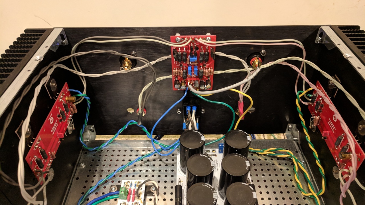

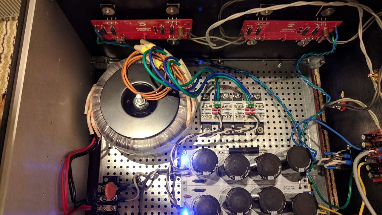

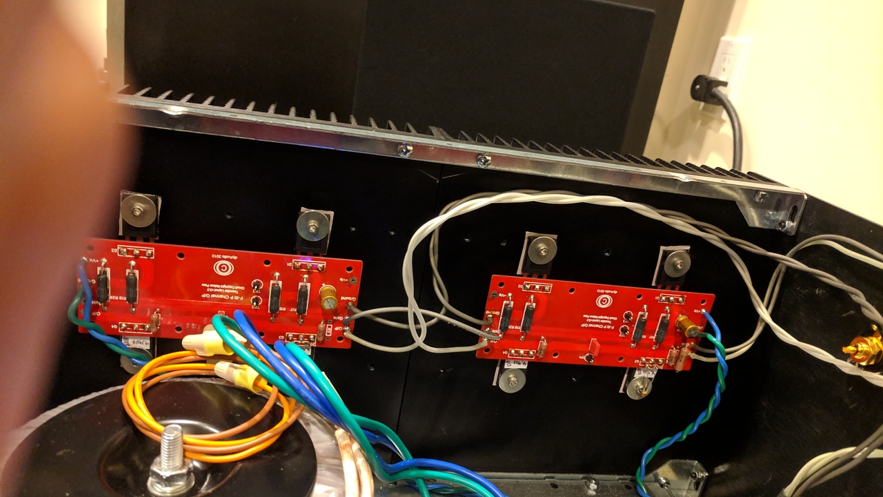

Each output board get it's own connection to the power supply, each output board gets connected to the speaker terminals doubling the number of conductors for less resistance, perhaps more capacitance and inductance, who knows. I have not bench tested the amps, they are super stable, DC offset around 10 mv when thermal stability is reached. I hope this helps a few diy'ers. Cheers!
Here is what I can share: I finished the V3's last week. In 2017 I had built a V2 with 4 cascoded Jfets per front board running at +/- 43 volts, bias at 0.7 A per output devices, total bias 2.8 per channel, using the store's power supply boards it sounded fine but I wanted more power my NHT 3.3's.
This time a used Toshiba Jfets bought on eBay from a seller Nelson recommend the seller based on Sacramento CA (punkydawgs is his seller name), I upgraded the power supplies using Tea-bags dual rails boards running the same voltage. I took a chance buying Panasonic 27,000 uF 50 V capacitors from a guy on eBay (I think he has more of them, $8.99 a pair) they are doing fine so far, no humming on the outputs.
What I have realized is: Toshiba's Jfets are quieter, sound better (I gonna get in trouble by saying this but my ears tell me it's true) they are very low noise= more subtle sounds come through. More class A = sweeter sounds at loud volumes, currently running at .350 V across Rs's so total bias is 5.6 A per monoblocks. I think I'm getting close to 100 watts class A. The upgrades have made a big difference in the sound.

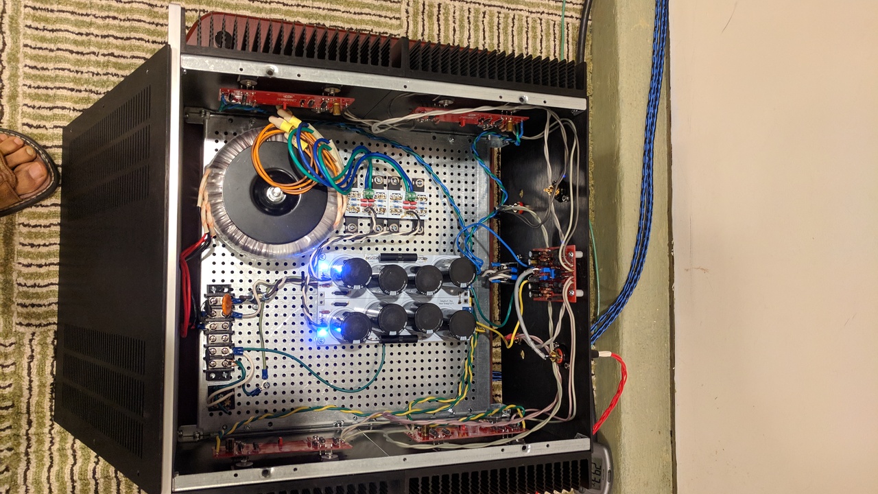

2 more. It's a bit messy but works fine
Thanks for the photos.
By my calculations, if you wire it that way, it is unnecessary to use anything over 20 AWG.
For silver coated Belden 20 AWG, the Max Amps that may be carried is 6.5 Amps. As the boards are in parallel, the total amps that can be delivered to the speaker by the wiring is 13.

Using 20 AWG and wiring the output boards in parallel does not pose an issue.
If the boards are wired in series, then the limit of 6.5 A is at the power supply side and the output side.
