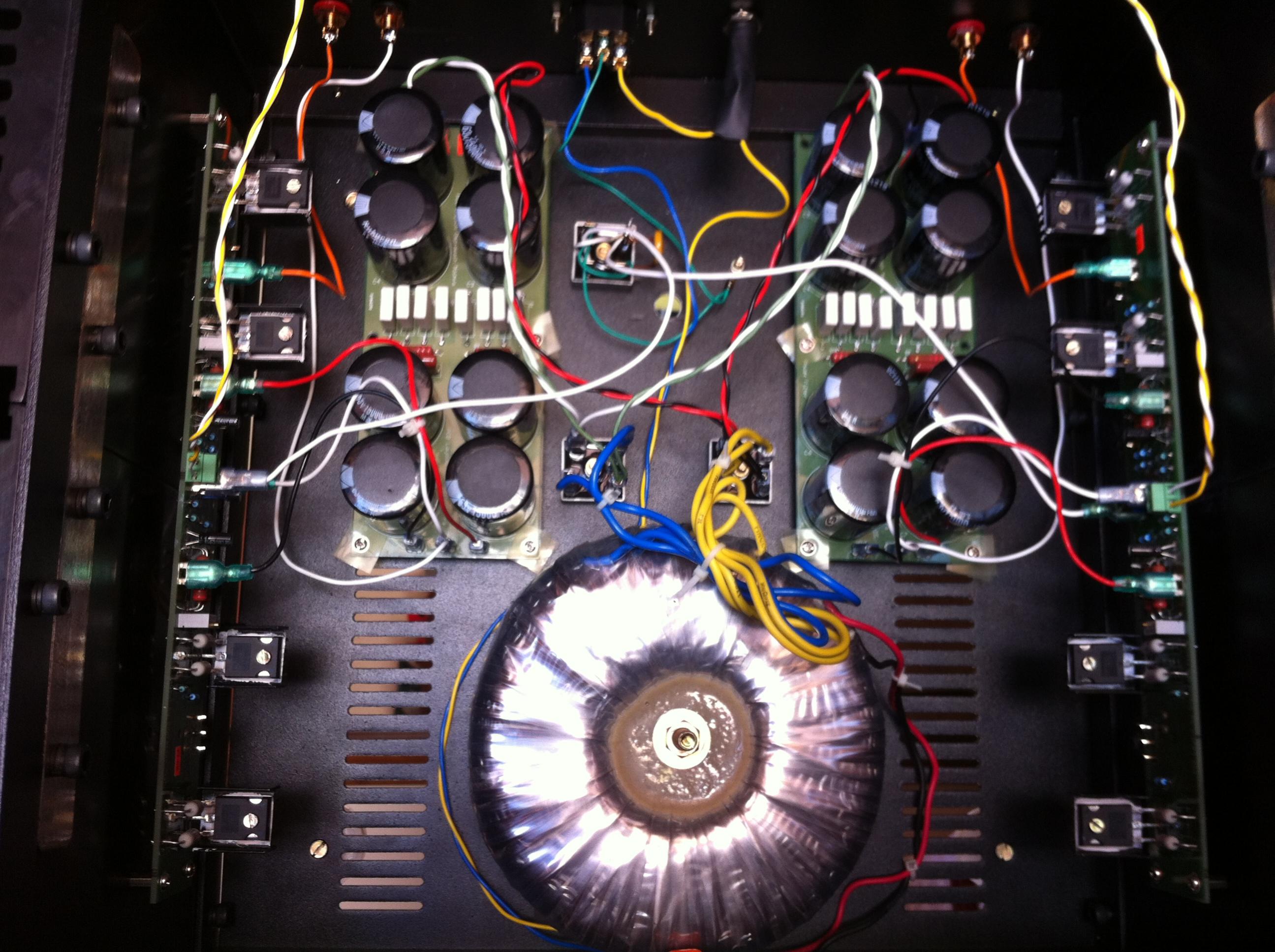

Completed F5T v2 - few problems
Completed building F5T v2 exactly as per the schematic using boards designed by fellow member Om Mishra as a part of a group buy on an India forum.
Heatsinks are massive 20 KGs per meter heavy duty ones.
Pictures are enclosed.
The amp biases nicely and have biased to 350 mv on each channel. Provided individual heatsinks to each of the switching diodes at the outputs. Gets to around 40-45 degrees centigrade. Tried playing music. One channel plays really well and on the other channel there seems to be no gain, with very feeble output. Every resistor is measured and soldered. There cannot be too many errors on the solder as I have gone through each solder with a magnifying lens before powering on.
The power supply is showing 33.5 on each rail on load condition. Could it be the case of a bad jFet pair on the bad channel? Don't know where to look.
Need help from the gang please....

make a break for few days
after that , go back and compare channels visually
then power up and compare them with DMM
Bad jfet is easy. Test V drop across source resistors. Take voltage readings at various places, starting with FE. Report back. All this after taking a break, as ZM suggested. It is amazing how many mistakes I have found after taking some time away from a project.

Thanks. I think you are right. Having spent two full days on putting it together, I definitely need some rest.
Yes, I have a good identical channel to compare the readings. One more thing the jFets are at 8.7 mA IDSS and the supply voltage is 33.5 V DC per rail. Papa's article talks of 8 mA IDSS. I dread desoldering on a thick doubled sided PTH PCB.
Thanks.
Is that Idss measured in circuit or before installation. Are both channels showing that Idss? That seems high for a degenerted BL grade. IT is possibly too high in terms of dissipation, but ZM may have more insight in this particular area.
IDSS rating given by spencer and is measured before the installation.

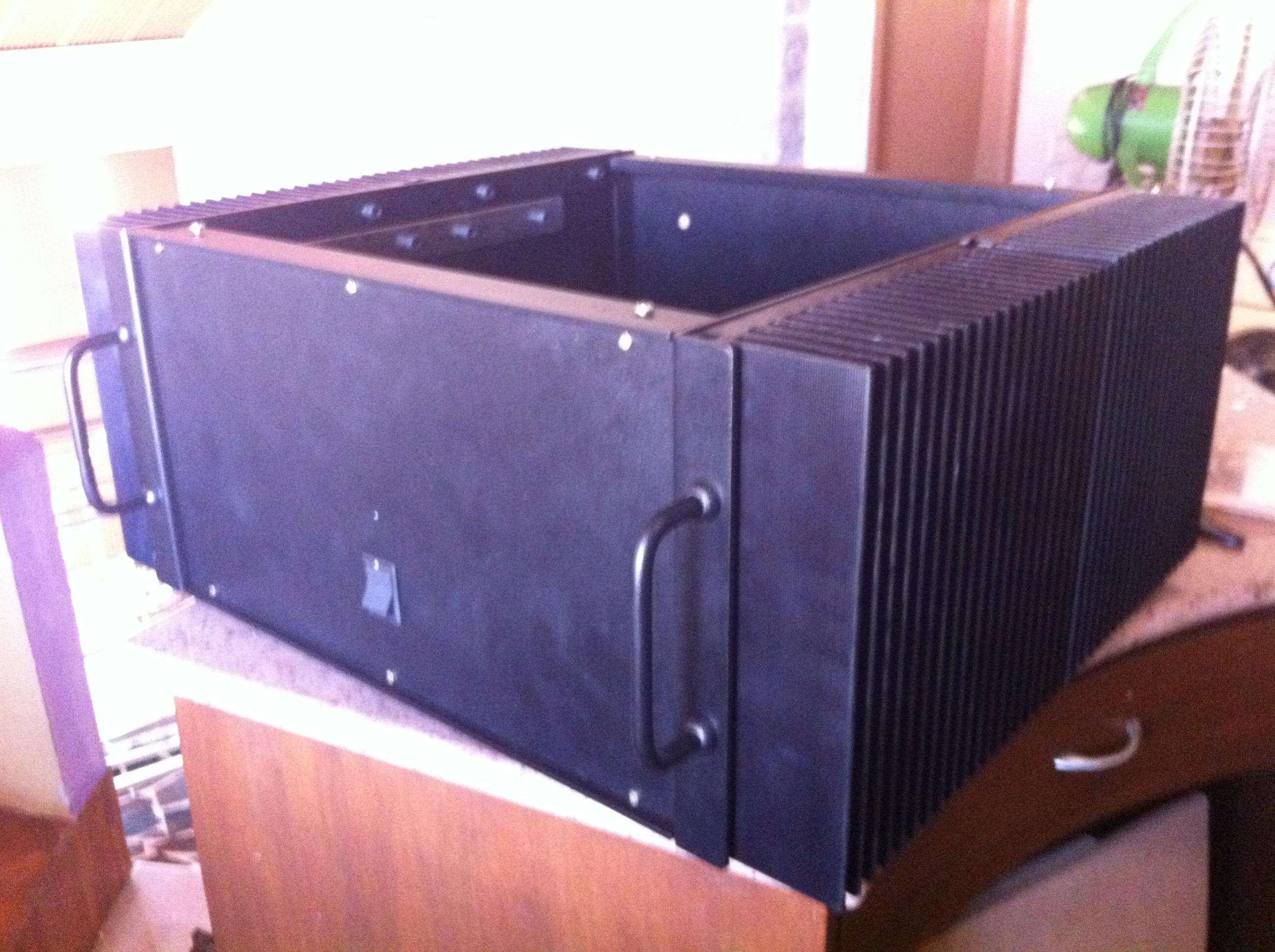

Nice case, Anil 🙂
Bad input FET is what it might be. There was someone who had the exact same problem on the F5 thread and there were some questions on being able to set the bias with a busted jFET, but apparently it is possible.
I wouldn't worry about desoldering from a double sided board. Just snip off the leads and solder the new transistor on top of the pad (no need to go all the way through). Works when the holes won't open up. Mostly though, a hot iron (very hot) an bit of solder to get the flow going, and some solder wick does the job of opening up great for me. Never had an issue even with very tiny through hole components.

Thanks Sangram. How is your Turbo build coming along. I saw the pictures of your cabinet.Nice case, Anil 🙂

First I will measure and compare the working and the problematic boards before I change any component. Surprisingly the amp biases very well.

Do eliminate any errors in the input circuit as well, track the signal before it hits the input stage. Small oversights could be the case here.
