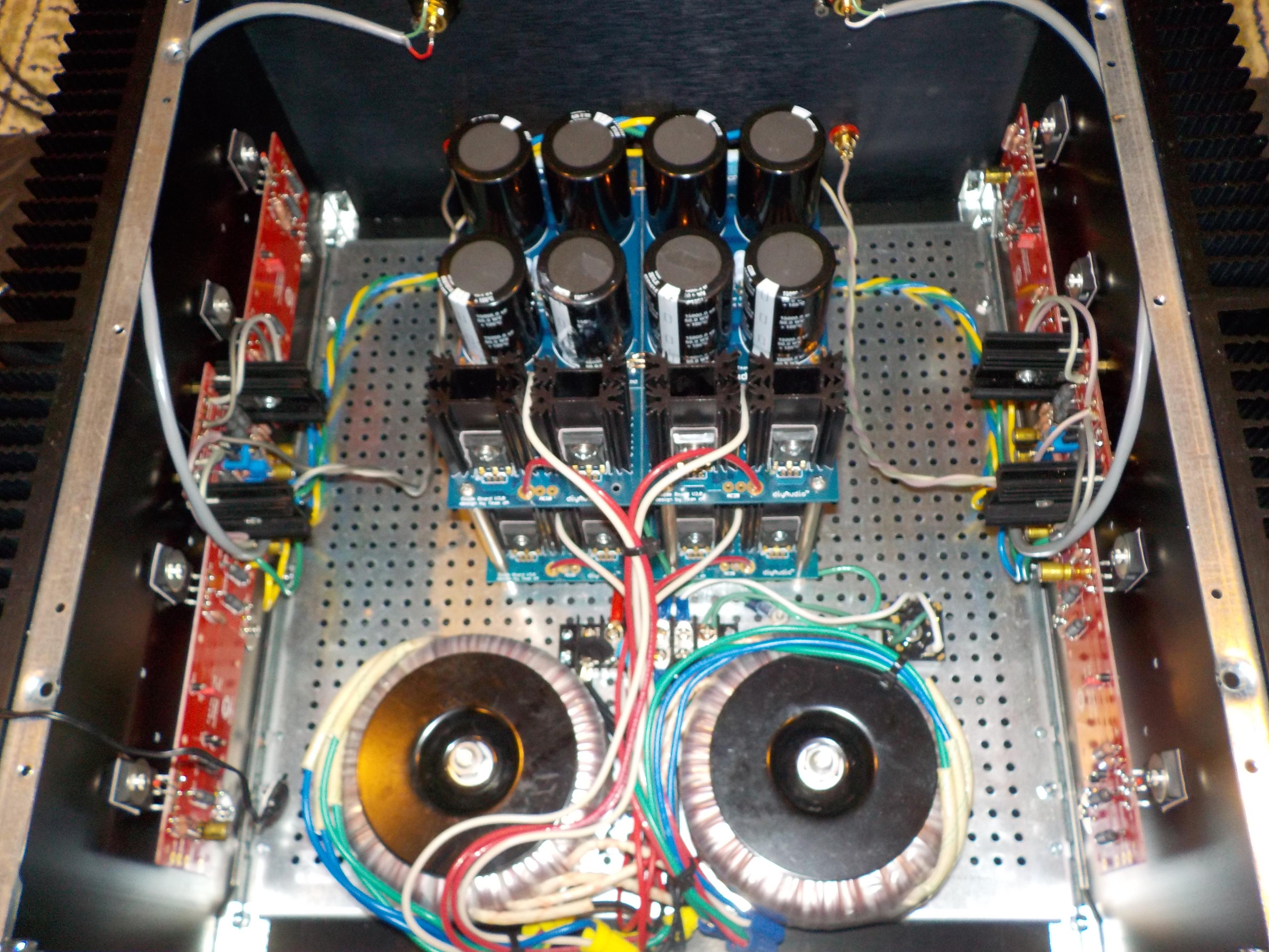

I built a F5T V2 with dual mono PSU's using 2 of the V3 boards from the store. Currently running at +/- 40 V DC rails with 2 300 VA transformers. Following Nelson's diagram, I implemented a ground isolation system with a diode bridge, thermistor and capacitor.
The amplifier sounds great with the exception that it presents a low level of noise that can be heard at the mid range and tweeter drivers.
There is no humming at the woofer.
Each dual rail power supply has 120,000 uF of filtering. 8 15,000 uF capacitors 50 V DC. Using and oscilloscope I can see a ripple of around 32 mV rms, 120 Hz with the amplifier boards connected. It drops to almost zero with no load.
What do you recommend to do to improve the amplifier?
Thanks in advance for replies.
You say there is no hum from the bass speakers and that there is noise from the Mid and Treble speakers.
Seems noise is your problem, not hum.
The measurements you give for ripple are related to minimising hum.
Have you measured the Hum+Noise at the amplifier output?
What are the sensitivities of the three speaker drivers?
Do this with the inputs shorted with zero ohm dummy plugs.
Repeat with long interconnects, again shorted at the far end with zero ohms dummy sockets.
Repeat with long interconnects to a source with the vol pot turned right down.
Post all the results.
Thanks Andrew. I suspect a grounding issue. Last night I managed to blow the output FETs on one channel. Amp is back in service. While on the bench:
DC offset with open RCA input and no speakers connected: less than 50 mV. I connected a shorted RCA male to the input, the DC offset jumped to a bit more than 0.5 Volts.
If I plugged an interconnect to the input the DC offset jumped to a bit under 0.5 Volts even with the other end in the air, about the same if connected to a source. Connecting speakers did not change these values much.
I adjusted the DC offset with the input shorted, below 30 mV now, does not change much with the speakers connected. This remains true as long as there is an inout connected, when an input is removed, the DC offset goes up to around 0.5 V. What is happening?
I don't know how to measure Hum+noise, what tool(s) do I need for this?
The speakers are NHT 2.9's sensitivity is specified at 87 db.
Reports on test suggested:
With open inputs the amplifier is quiet.
With shorted dummy, noise is present but not low.
With short interconnects more noise.
With long unshielded noise is stronger with open end, stronger with cable in vertical position, less in horizontal position. (RF interference?)
With long cable if a short de end to plugged to the amplifier, noise drops to low level.
With cable connected to a source is quieter with short shielded cables than unshielded and long cables.
If source is off but connected to amp the level of noise is greater.
Next thing to try tomorrow is the install two ground rods to improve the grounding system of the electrical system of the house. Isolated grounding? May be, I will keep chasing. I think is a grounding issue... we will see.

I see two possibilities.
Either:
a.) the amp is oscillating when the open input has an aerial picking up interference attached,
or
b.) You have a DC coupled input and the source "resistance" seen by the input changes when you change the source connection.
You need an AC voltmeter. I use a variety of cheap digital voltmeters that have a 199.9mVac scale and even though they are not accurate they give a very good approximation to the H+N at the amplifier output.
A 1.999Vac scale is not sensitive enough to get reasonable estimates of output H+N.
These two results are the opposite to what we usually find for a normal power amplifier. The quietest operation is usually with a zero ohms input plug fitted to each input.
An interconnect with an open remote end acts as an aerial picking up interference. This is generally noisier than any other connection.
Yes, the shield is the return route for current entering from a source. Where no source is connected the interconnect core acts as an interference pick up aerial. The screen does not provide effective shielding for an open ended core.
This is normal. The short at the remote end is a test I recommend when testing a stereo amplifier. Connecting two long interconnects is the next stage. then shorting the remote ends together is the third stage. shorting the remote end screens together is a test to find your amplifiers tolerance to being connected to a stereo source that has a common "ground" for the signal returns.
This is a bit unusual. With an interconnect cable terminated at both ends, it normally makes little to no difference to the noise from the power amplifier. Maybe one of your interconnect cables is faulty?
This is quite common. An OFF source can present any of a variety of source impedance to the input cable and the input stage. If the OFF source impedance is higher than Zero ohms, then some noise will be added to the input and may become audible, certainly measurable.
NO !!!!!!!!
Do not alter a correctly installed mains distribution system.
If you suspect a fault in your mains system get a qualified electrician to come and check your installation.
The reason for NOT adding Earthing Rods is due to the voltages and currents in your locality during an electrical storm. With the correctly installed earthing system that the mains electricity distribution company has provided, the whole house and you and all your wiring is at the same voltage during a lightning strike nearby.
You must NOT interfere with this. Your life depends on that equality of voltage during the nearby lightning strike.
If anyone installs extra Earthing Rods then there exists the strong probablility that two different voltages can appear at the two Earth rod installations and you end up with differing voltages between the two rods during a lightning strike.
If you were unfortunate enough to be very close to a high potential difference (say an output socket relative to the floor of your house) you could get a lightning arc from the socket to you, through you to your floor. You have added an unauthorised and untested earthing rod that bring the lightning INSIDE your house !
Similarly electrical equipment connected between the two differing Earth Rod installation could end up with a high voltage between them and get damaged/destroyed.
