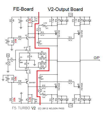

As you did not give a specific recommendation I chose to increase R5/R6 which to me is just an extension of the range of resistance of P1/P2. The immediate result was the massacering of a set of MOSFETs illuminated by some bengal fireworks in my chassis box. Simple reason was
a) not having zeroed P1/P2 before pushing ON button
b) having chosen 5k in series with R5/R6
Now I know, that my PSU is powerful enough to blow and burn 2 pairs of IRFP240/9240 within sec's.
With the other channel left still in proper condition I tried more carefully adding 330Ohms only in series with the 1k pot and certainly turned it to zero. Now I got exactly what I expected: I was able to tune easily to Iq=800mA/device and still had some turns left, so I am sure I can go to 1A and probably beyound. As you mentioned, that the bias of the JFETs could be affected I measured voltage across R7/R8 but it did not move at all.
Question: Are there any objections against this change from R5=1k to R5=1.3k???? Doesn't sound dangerous to me.

I am fighting the mechanics of this Forum. Tried to embed into the text as others did but seems not to work. I have added it as an Attachement and wonder how this works. Wuill see. I have marked all components in red which I have changed from the original. Everything else is just like the schematic (guess this is what you call "sch") in the build guide of 6L6.

Using too much resistance in parallel with the pot will:
a) make the adjustment too sensitive
b) leave room at the top of the adjustment that allows toasting outputs
You've already discovered (b). But as long as you zero the pot before each run, and monitor the output temps, you can prevent toast even with a really big R5/R6.
So if you are fearless (ie: you believe you'll always re-zero and will always watch your temps when adjusting the bias), then any value of R5/R6 that doesn't make the adjustment too sensitive is fine.
If you worry about (b), then step R5/R6 up slowly until you've got just a little bit of room on the pot above where you want to be. It sounds like you're already there if you want 800mA (and possibly even 1A). If you do run out of room again, you may need to go up a bit higher.
Jeff.

Thanks Jeff, for very usefull comment!
I will stay for a while with the 800mA as my heat sinks are too small anyway. After adding some fins I hope I can go to 1A or more pending on the temp rise. Then I will do exactly what you said, adding resistance to R5/R6 just enough to get the desired Iq plus 1 turn left for final trim.
You have done the correct modification to get adequate bias voltage to suit the output devices you have.
I suspect your jFETs have slightly lower Idss than the average Builders.

Yes, you are right, Idss is low and measured across R3/R4 it is about 4.5mA. Per NP's article this should be 8mA, shouldn't it? Do I need to do something about it?
How do I get it up?
I do use cascoding because of rail voltage of 40V idle. I noticed however, that voltage drops to about 35V when biasing one channel only with 800mA. Guess it will drop further, when I add 2nd channel as well and maybe even go to 1A bias. If it approaches 33V or so, should I swap cascoding at all or is that too "fearless"?

Idss=4.5mA means you have used a GR rated 2sk170.
The spec requires a BL rated device.
But you can still get the necessary drive voltage to the output devices by altering the drain load resistances.
Earlier you stated
you cannot measure Idss in circuit.
Measuring the voltage drop across the source resistor allows one to determine the Id, i.e. the actual quiescent operating current. This is NOT Idss.

As Andrew stated, what you measured is Id rather than Idss. (Idss will be higher.)
In any case, the only thing you would need to do with a lower Idss is to raise the drain resistors to allow reaching the desired bias point (which you've already done).

If I understand Jeff correctly, the advice of increasing drain load was already done by changing R5/R6 to 1.3k, right??

Yes, increasing the value of the drain load increases the bias voltage applied between gate and source of the output mosFET.
If you start with a lower current jFET, then you need a slightly higher drain resistance/load to generate the necessary bias voltage.
Some vertical mosFETs (eg. 2sk1503/j201) and most Lateral mosFETs require a very low Vgs to turn ON.
This may require the drain load resistances to be lower than a standard F5 build.
If one used the standard F5 resistance values for the Toshiba 2sk1530/j201 output pair, you would find that most of the jFET current passes through the variable resistor. This would not suit long term reliability of the VR.
