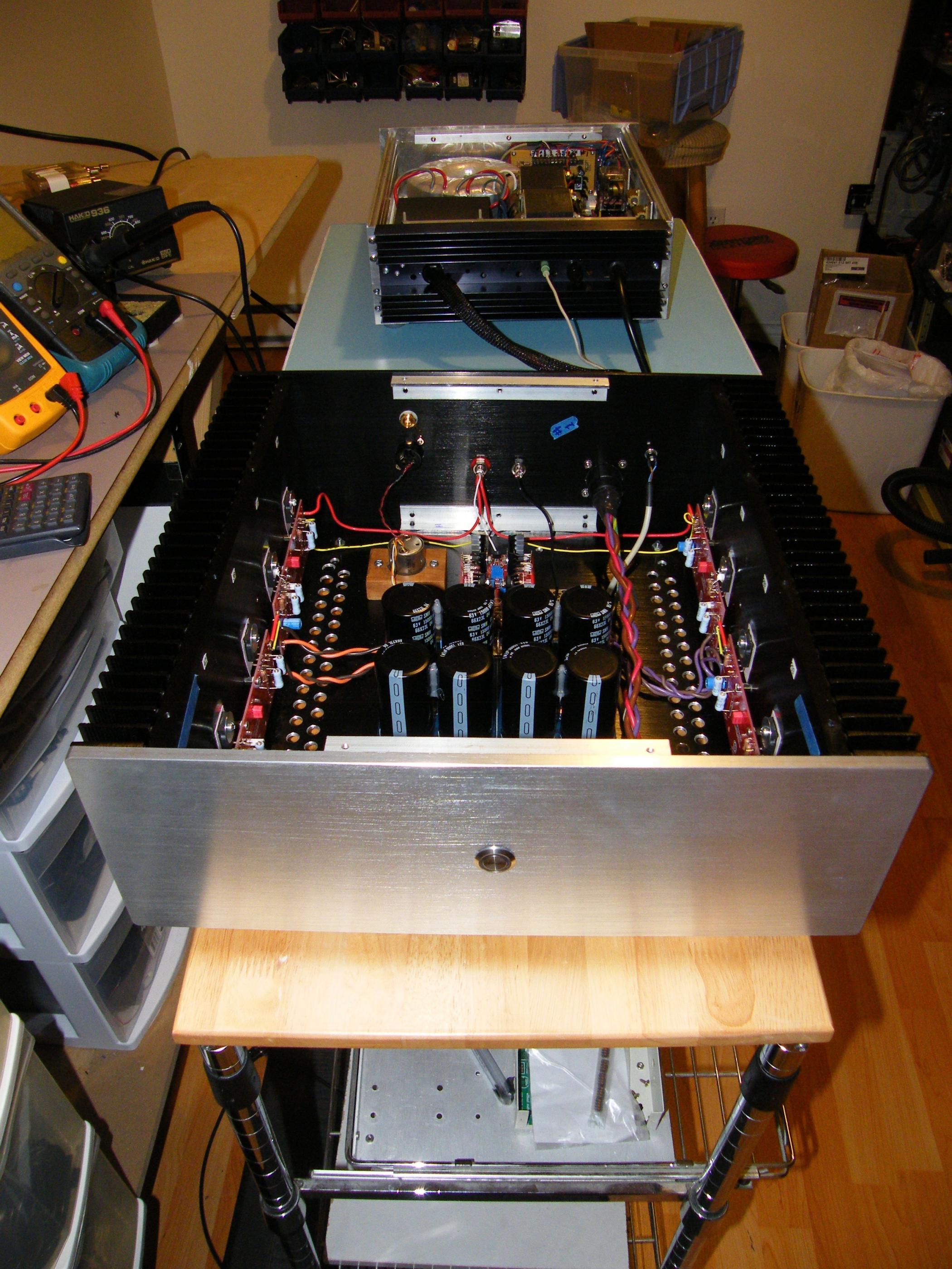

I got the amps both adjusted today and put everything together for a test listening session. I had to scramble to find 2 stands to stack the supply and amp cases on. I did some basic checks. Bandwidth is flat at 20khz,-3db at about 90k, -6 at 115 and -20 at 215khz. Flat at 20hz on the bottom end. Noise - I calculated it at about 60uv wideband. Dead quiet at the speaker in practice.
It sounded very nice. Since I haven't listened to the system for long I will refrain from making any judgements but it did seem to have that special way with sound stage size and decay of notes that I have noticed from other class A SS amps.
Couldn't listen for long, maybe an hour or so.

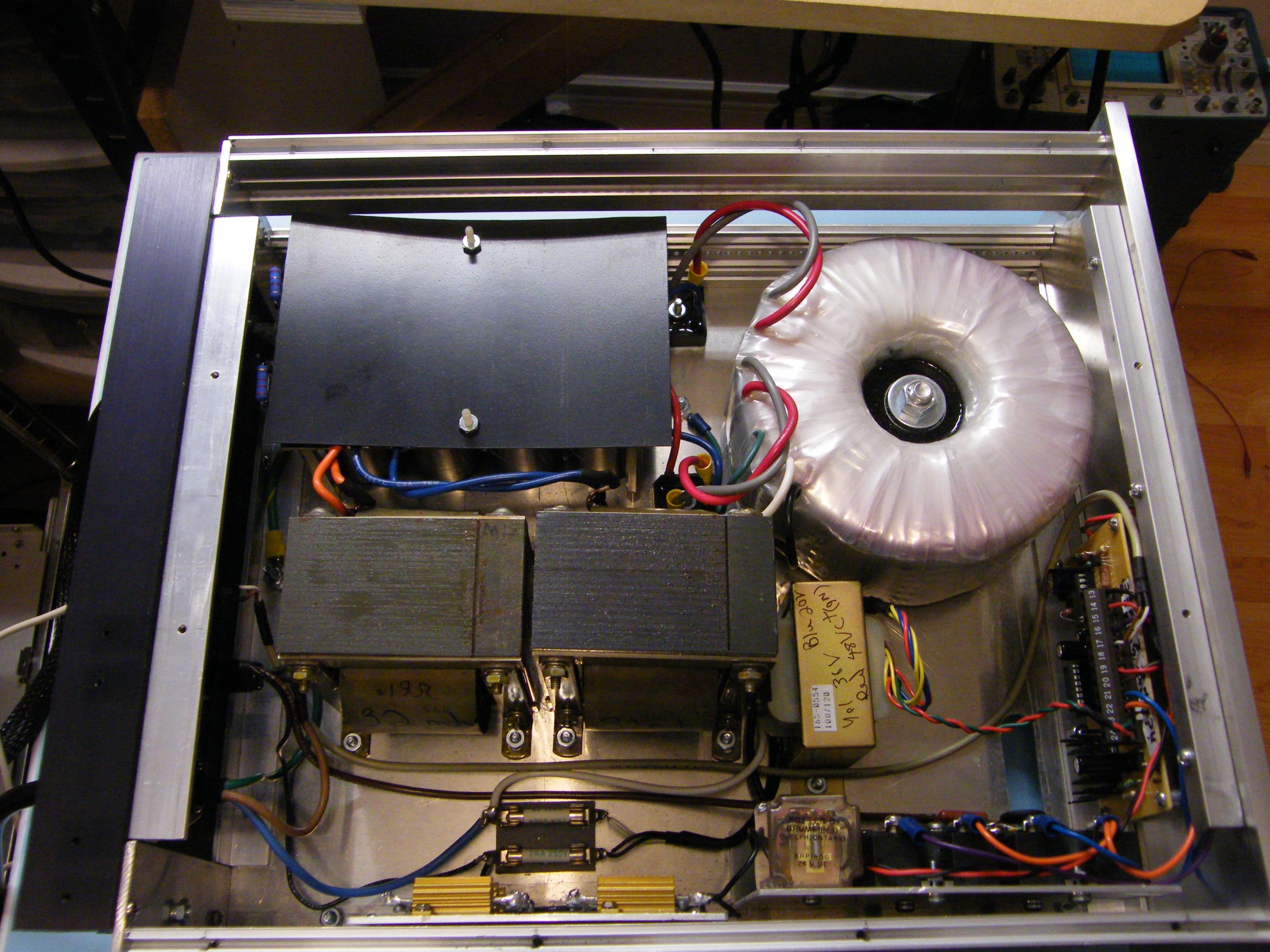

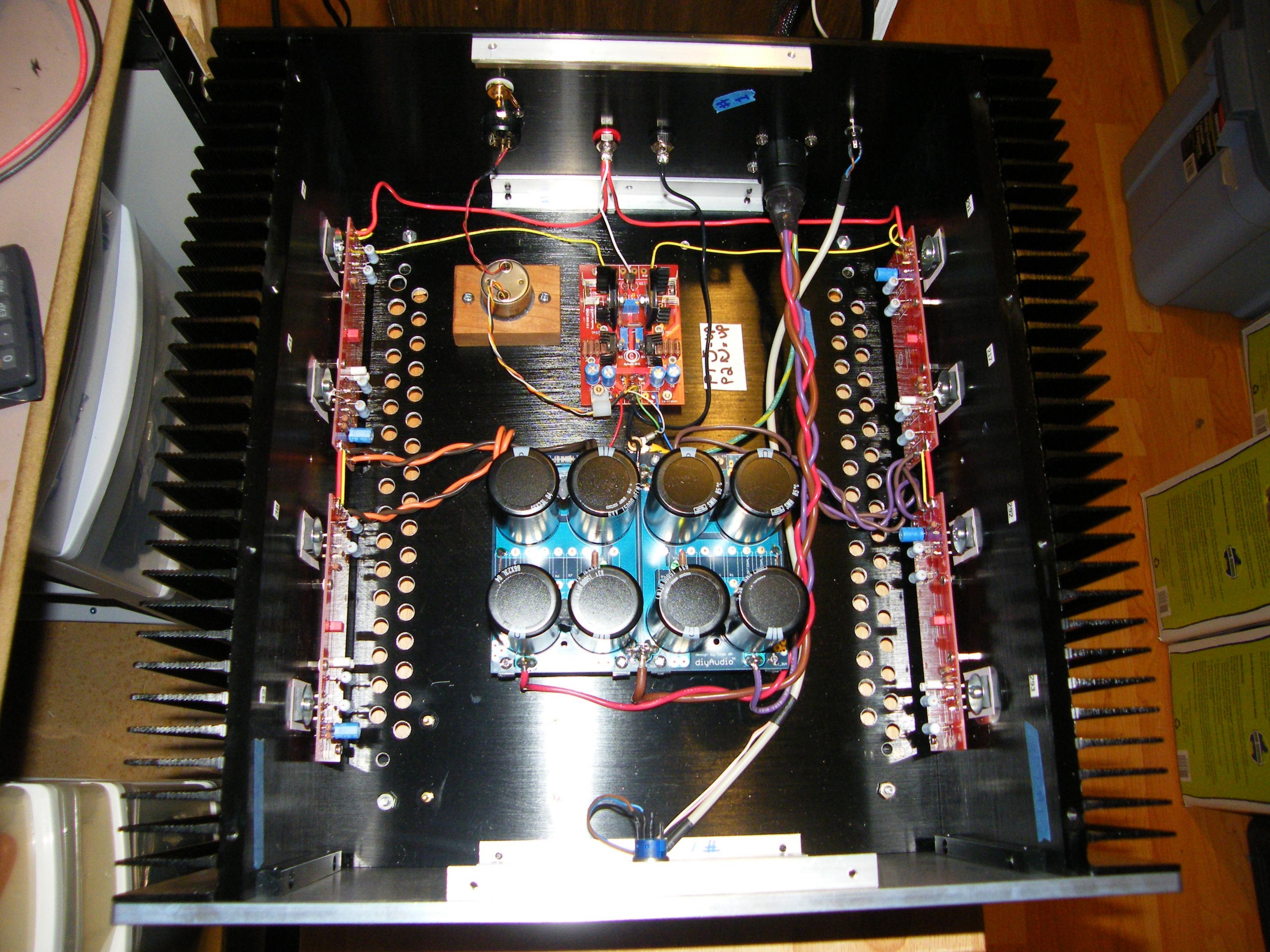

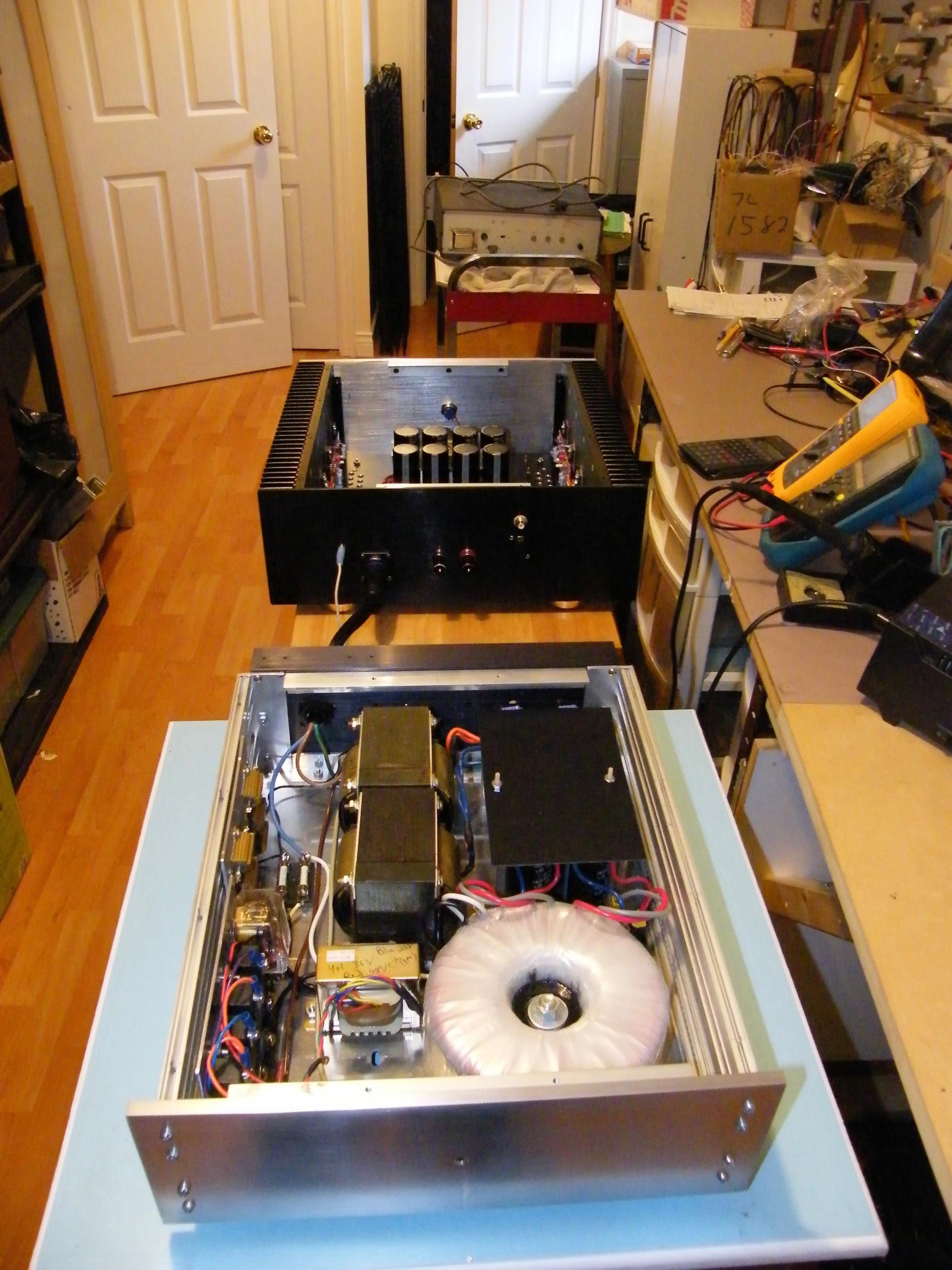

Heres a few pictures- It's a 4 box setup with mono blocks and separate power supplies with soft start circuitry. I mounted the input transformers , a Jensen JE-11P-1 in small blocks of cherry. I just couldn't use that thin angle bracket that they send with it. The power supply has a total of 240kuf/ch and 2 30mh chokes. About 46-47 volts dc with very low ripple maybe a couple of mv. The power switch is on the amplifier and a 1/8" cable connects it to the power supply box. A controller using a LM3914 sequences SSRs for first a series resistor, then in parallel with the resistor a CL 30 and finally a conventional relay bypasses the 2 SSRs and they are shut off. All of this with very little fuss from an LM3914. All analog, no programming or clock needed.

Just a few notes on the F5 monos above. I did not use the diodes so I guess they would be a F5V3 without the turbo. Building a 4 box setup is a lot of work and building the power supply chassis from scratch was time consuming. I got the amp chassis from EBay and got them for a good price. Again, a lot of time was spent locating and drilling/tapping holes for the boards, Fets and connectors. I also had to spend a couple of quality hours flattening the brushed finish on the heatsink mounting surface so that I had a nice flat shiny surface to mount the IR 240/9240 fets. I felt this was time well spent due to the smallish size of the chassis/heatsinks. I am using the keratherm insulators sold in the store and used a small 1/4" drive torque wrench to set the mounting torque to 10 in/lbs. This is the max recommended in the Fet data sheet. The extra work seems to have paid off in good heat transfer. The fets do not feel much warmer than the heatsinks which are probably running in the 46-48c range when biased at my target bias of 250mv/.5amps. You could hold your hand on the FET indefinitely without it feeling too hot. Hopefully 10 in/lbs is no too much torque for the insulators. I had no failures on startup so time will tell I guess.
The lesson here is that if you value your time, seriously consider buying the pre drilled and tapped chassis from the DIY audio store. Buy as large as you can afford in order to get more thermal capacity. I know this advice has been given many times by member 6L6 and others, but I am repeating it here after doing all the chassis work myself. I have the tools and experience to do this stuff but if doing it again I would just bite the bullet and order the deluxe 5u chassis.
I still need to finish the power supply cabinets, wire up the blue LED ring lights on the amp power switches and fine tune the operating point/offset. Had another listen this morning and they are sounding good!!
