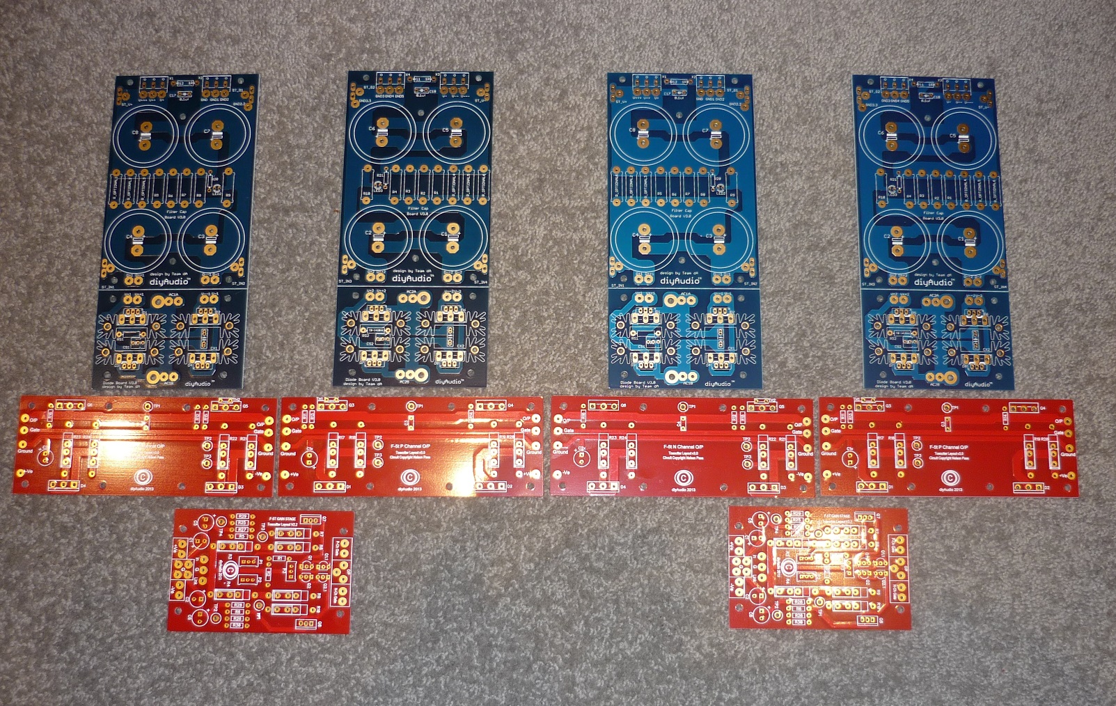

Can someone please confirm that I have my thoughts right about the attached pic. I want to build the F5-T v2:
1. For an F5-T v2, there are 2x O/P PCBs per channel. One PCB is for 2x N-channel MOSFETs ... the other is for 2x P-channel MOSFETs?
2. Each O/P PCB has its own PS PCB?
3. Also there is a Gain Stage PCB (for each channel) which feeds both O/P PCBs?
No..each FE board (gain stage) has its own PSU supply which in turn piggy backs to both P & N O/P boards.
Yes

andyr -
Are you building monoblocks or stereo? How many transformers do you have?

Thanks, Jim.
I am building monoblocks - so I assume I will be using a single transformer with dual secondaries, per channel?
I had actually started to read your F5T instructions, as I was laying out the PCBs on the carpet - but I hadn't seen the PS build instructions, so thanks for those.
