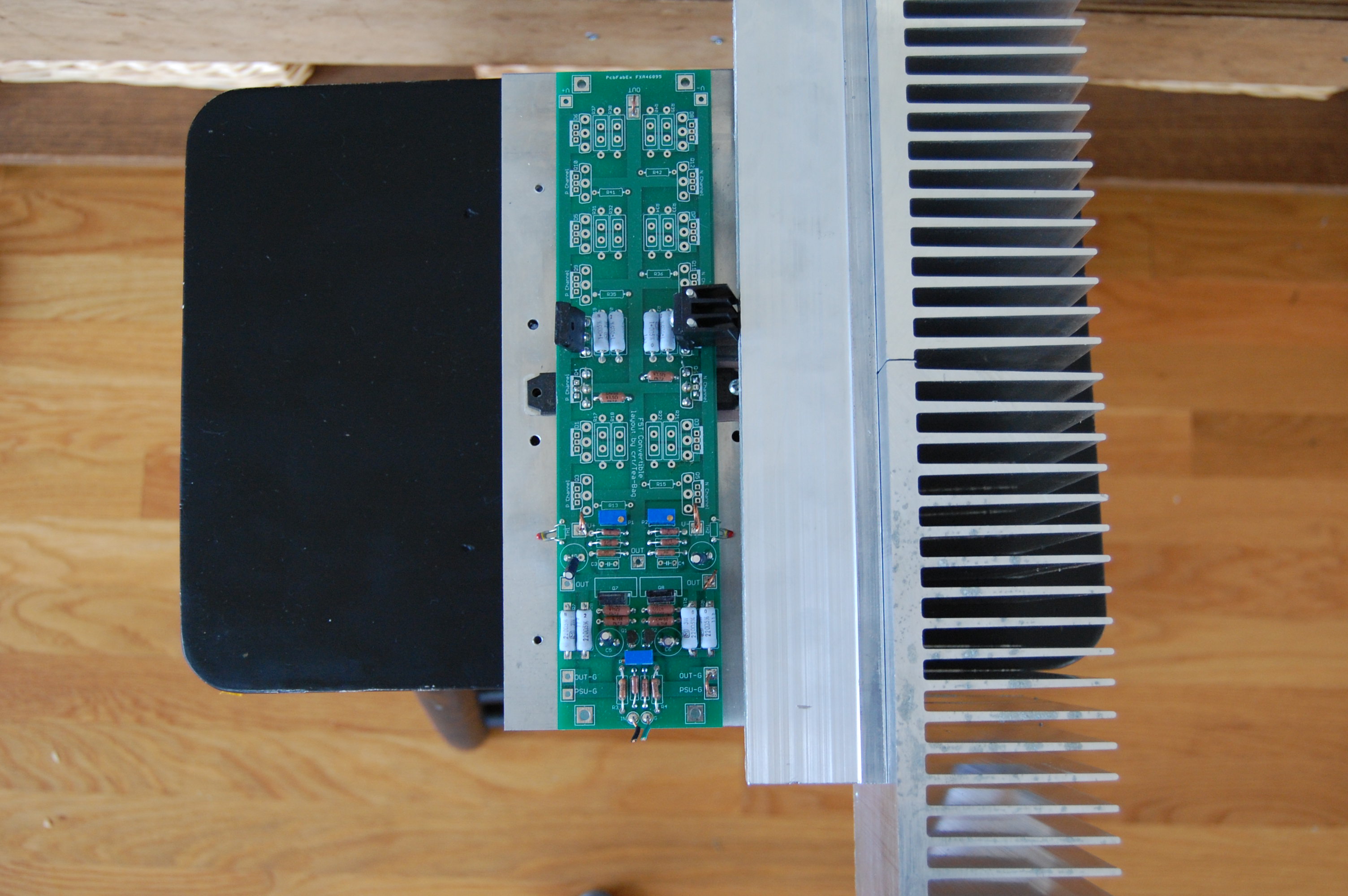

These are 18" long by 6" tall. They are disspating 100W easy in poor configuration. With this, 150W seems easy😀
I have two 10.08 profiles cut to 6" and attached end to end to make 18". I trimmed off some to mate them together evenly and limit overall length.
Buzz: It looks like you are gonna listen to a lot of heavy metal.
How good is the thermal interface between the heatsinks and the spreader? Do you use any goop or just bolts?

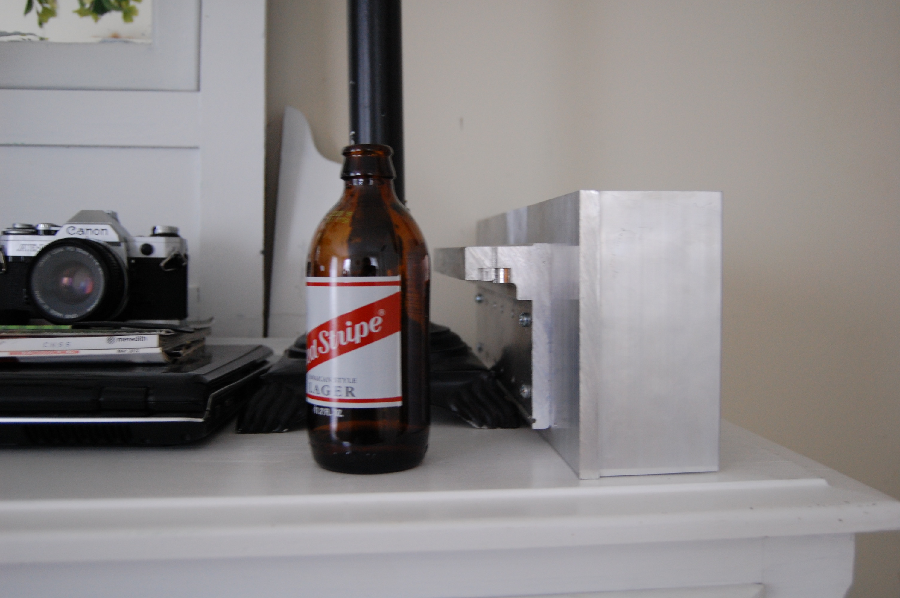

Here ya go. Rough idea. Times two should give about 7-8" in the bottom of the case. Enough for big trafo.

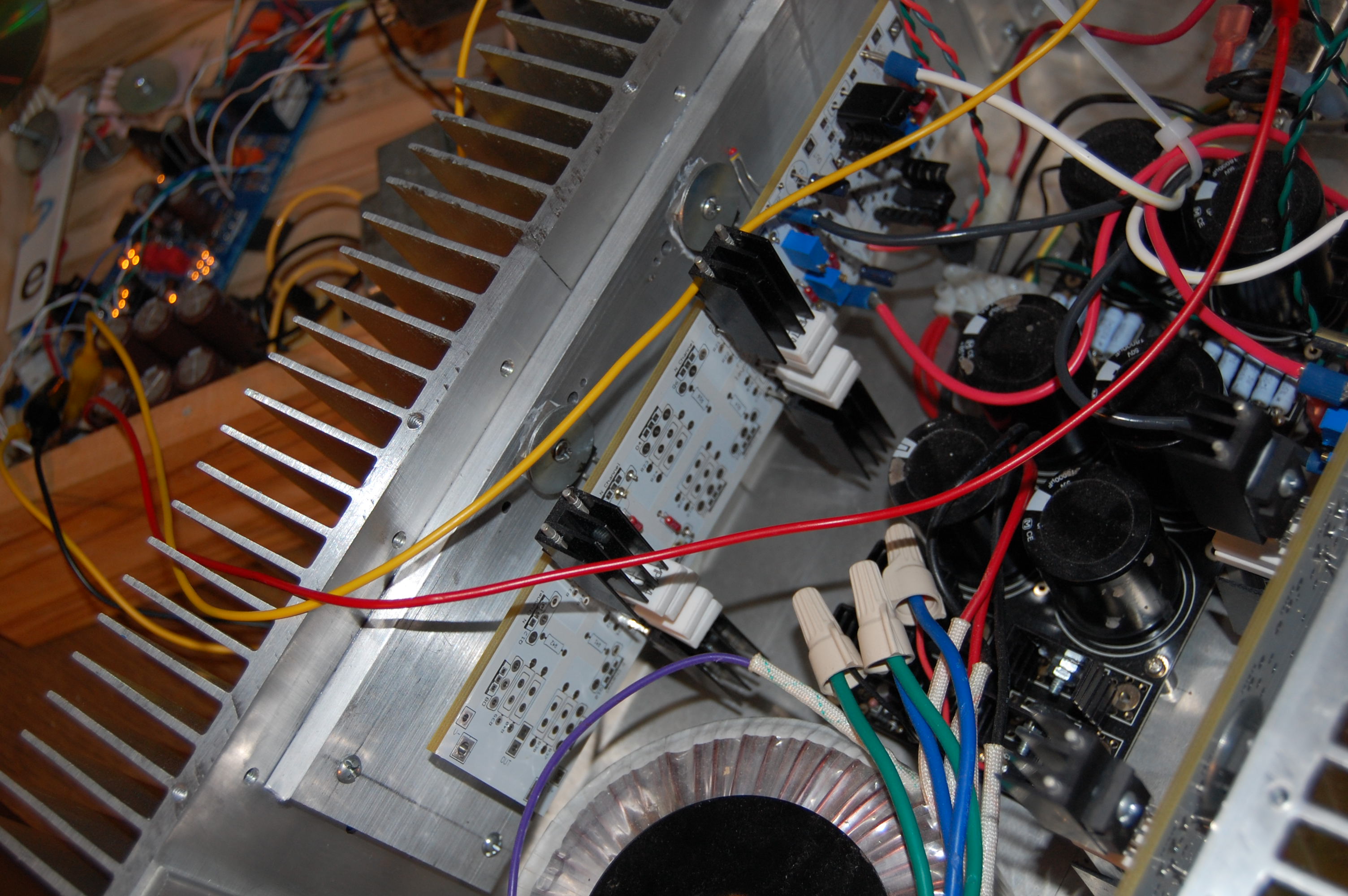

Here is current F5T V2 build. It is on similar, but slightly smaller heatsinks. THey are only about 16" deep x 6" high x 2 1/2" fin. As you can see, the fets are concentrated in the middle on a heat spreader. They are biased at about 400mV+, making bias about .85 to
.9A per fet. The sinks are well within 10 second hot rule. Last I measured, they were 37C. Checked fets and they are a degree or two higher, so coupling is good. I haev nothig but silicon goop between spreader and sink. I feel like i could easily put another pair on these sinks. With the newer setup pictured above, I have deeper sinks with longer fins. Also the heat-spreader is couple inches longer, with big ol 1" section for mounting the fets. I will have four fets on 1 side and will consider dropping the diodes and biasing higher than 1A. Wish I could cram more on the sink, but oh well. Already have way more power than I need.

True. My layout did not allow for this. My fets were all bunched togetjer and i was unable to spread them. As long as you have adequate sinking, and the like pais are thermally connected to allow for good couplong, you should be fine. One advanatage of a spreader is the possibility, if correctly sized and mated, to distribute heat over greater surface area of the heatsink. In theory. The heat spreader looks like one gigantic fet to the heatsink. One solid sink is superior, but hard to find. From there, it is all about comprimises.

Its 3/8" aluminum. The newer L shaped vetsion has 1/2" aluminum attached to the heatsink. I used silicon thermal grease to help with heat transfer. The sinks were not welded. Easy way yo check efficiency of heat transfer is with temp probe. Check fet, then spreader, then sink. You want them all close in temperature. The closer. The more successful you attempt.

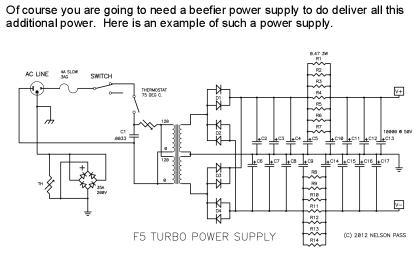

At the store site it has a Bom there ,for the boards,and I just go through the Power Supply and write those down to order them,In Nelson Pass articles he tells of a beefier supply to use,I've attached it for you,
If you decide you want some more power,you can go to 32v on the power supply,If you want more you will need bigger heat sinks or a fan or 2,and need to cascode the input fets,You can also remove the limiters and protection circuits ,but don't short the outputs and keep the thermisters they stabilize voltages on bias from the heat on the heat sinks,I hope this helps you some just go slow and If your stuck ask here,someone will answer!
