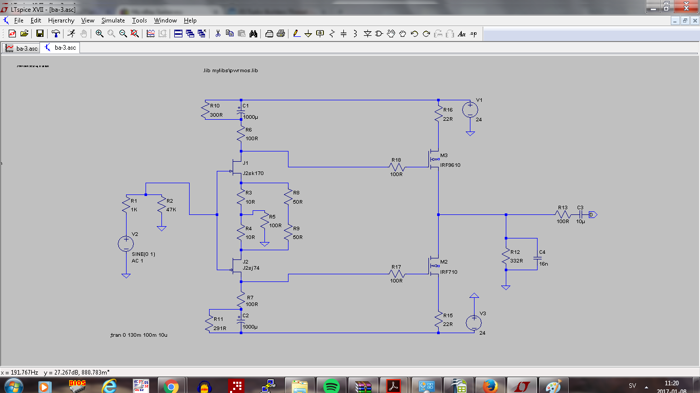

I cranked up the bias around 0.42v around the source resistor on the F5 t v1.
On my ba-3 frontend i put an extra capacistor C4 16nF (lowpass filter).
It did the sound mutch smooter with my speakers.
It sounds really good before the upgrade, but the high tones could sound litte metallic.

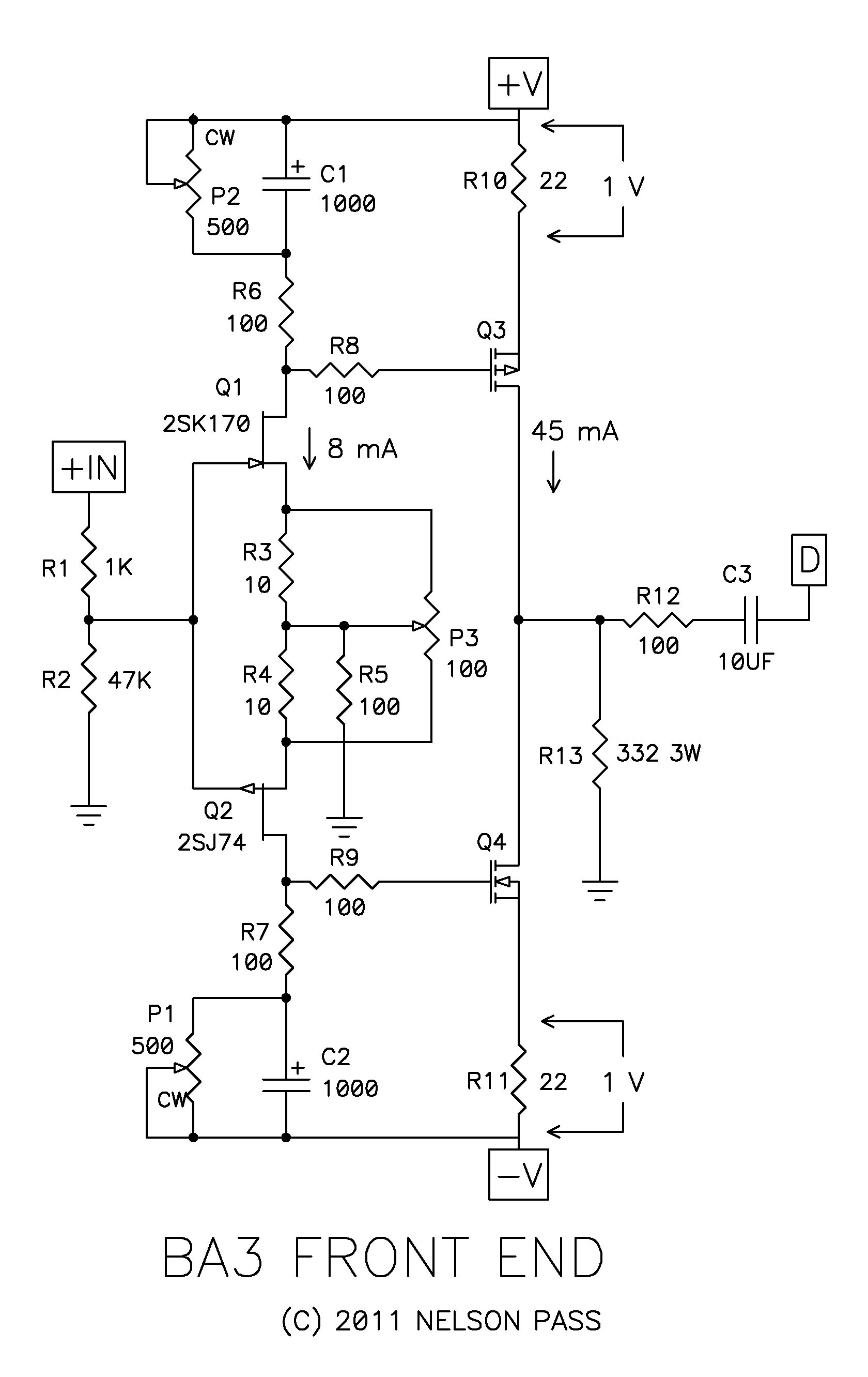

the 332r||16nF is a very difficult load for the amplifier.
The amp is having to work very hard ebven without an attached Receiver & cable.
There must be a better way than what you have ended up with.
It's trial and error for me.😛
The schematic i used for the ba-3 peamp is this (picture)
Any other idea about hot to make a better lowpassfilter for the ba-3?

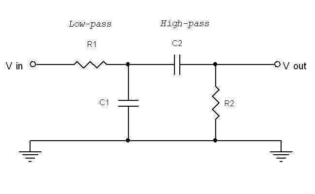

The proponents of keep it simple have us believing that missing things out is better than including necessary components.
The input to an amplifier needs in my view two passive filters to define the passband.
The simple sch does not include any filters.
The designer and others tell us that the capacitance of the jFETs act as the necessary RF attenuation filter. I don't believe them !
Adding a fixed capacitor (rather than a variable capacitance at the jFETs) after the R1 input resistor and in parallel to R2 fixes the RF attenuation.
Andrew
IMHO it would make things much clearer to very many builders if you posted an amended circuit with your additions and component values.
Many builders can not calculated these things but are capable of following a diagram.
Just posting comments against the existing circuit without giving details that ordinary builders can follow does not help people.
